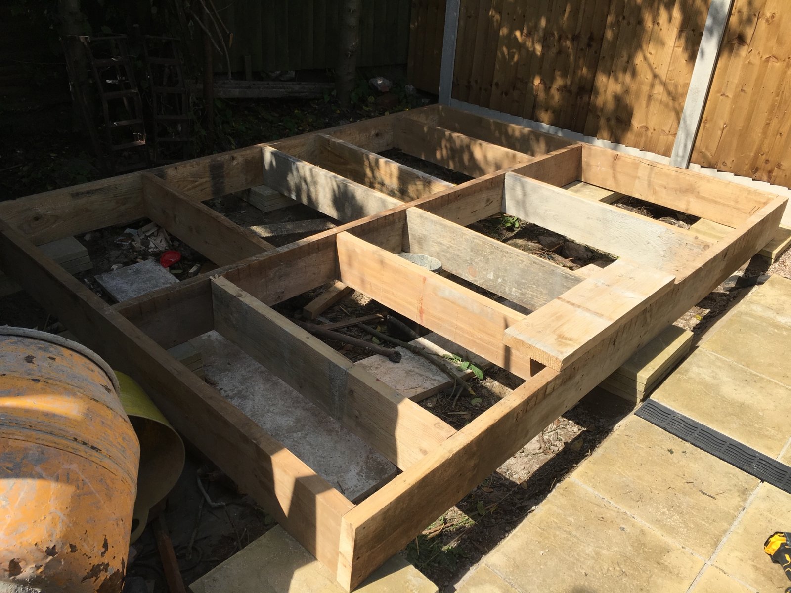

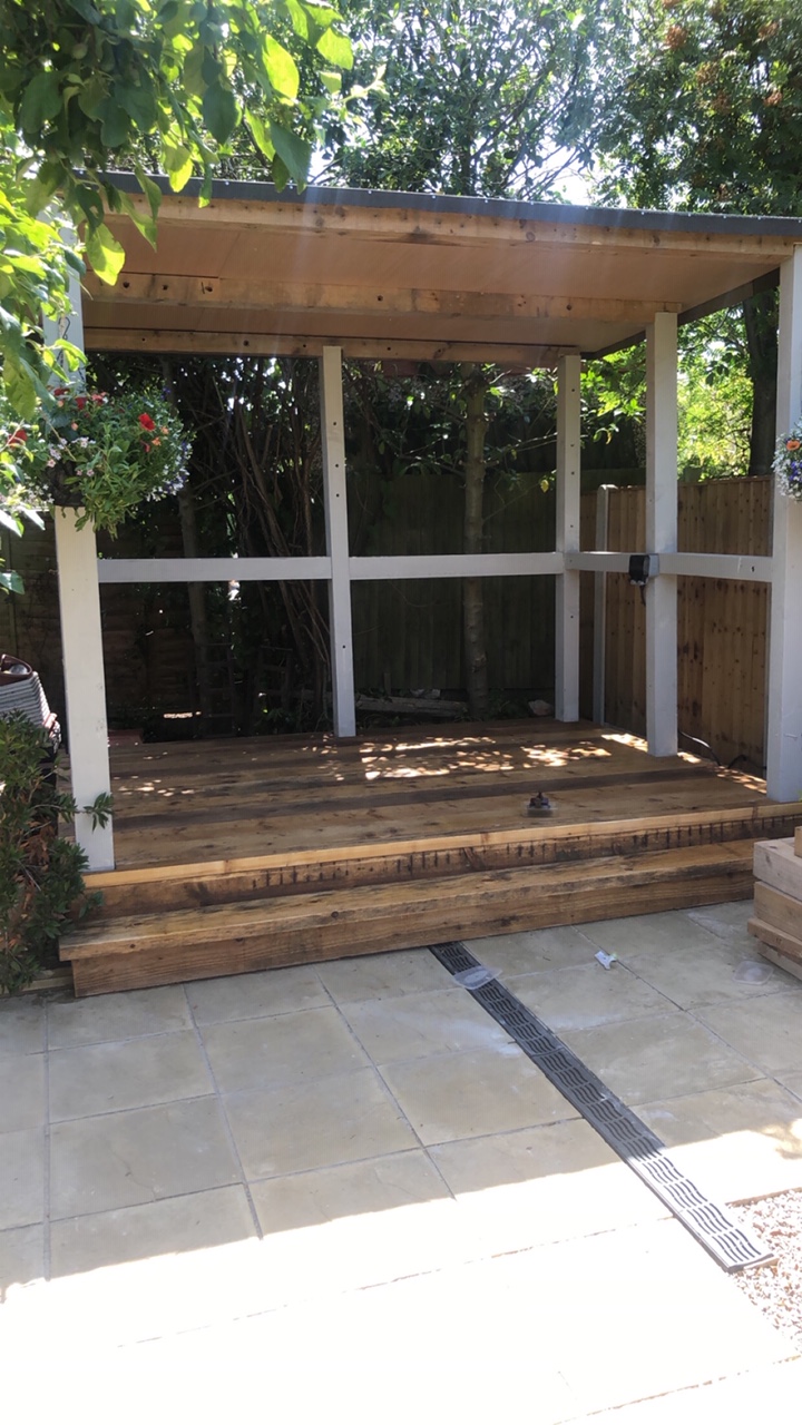

I built my decking frame resting on slabs. The slabs are in each corner and then support every span (so 9 slab sections in total on mine) and they are on a bed of compacted hardcore/sand and cement.
I just built the frame on top of those using 9" x 2" shuttering and the posts from 5" x 4" posts (all reclaimed). There's lots of air flow underneath and checking under there throughout the winter shows no signs of rot or movement -- it's rock solid. I did think about posts piled into the ground but worried about them rotting. My method results in no timber touching the soil at all.
Whole thing cost about £200 not including the 18mm ply roof.

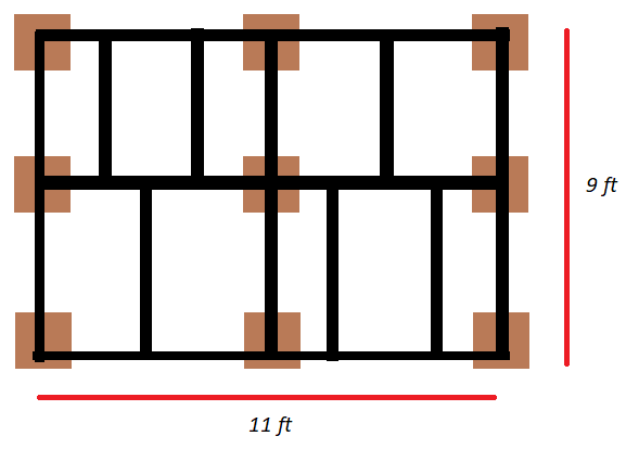

Thanks for sharing @cwhaley, looks a tidy job. If you don't mind me asking what are your spans? 9x2 throughout is pretty heavy duty but I was a little surprised looking online how close together people put joists.

Thanks -- loved doing the project. The span between the slabs was a concern at the time, but I just used my own initiative with it. The span is never longer than 5'6" but probably could have been longer as the whole thing is rock solid. Last August I had 9 people on it and all the levels are still bob on. I even used the 9x2 boards as floorboards for it. I've put a rough sketch of the plan below.
My 5" x 4" posts are just secured with bolts into the frame -- they sit level on the slabs. I put the slabs at a slight angle to allow rainwater run off, but with the roof on it doesn't see much rain. Once the posts were all linked with the 'hand rail' barrier they don't move at all. I thought about concreting them into the ground as you suggest but the weight of the frame and the posts and the roof together is so great it doesn't move -- keeping the sides open so that wind can flow through is very important.
I think your proposal is sound design wise. As you say use the 8x2 for the main frame (into a St. George cross shape) and then secure them together with the smaller joists to strengthen the frame's structure. If you can make the whole frame from 8x2 though I'd do that. Use old shuttering boards from reclaim yards.

When I mentioned spans I was actually meaning the longest unsupported distance under the decking boards themselves?

The boards I used are 2" thick (same timber as the joists) and based on my plan above, the longest unsupported span would be around 2 ft - ish? If I'd used decking boards as you buy them in the shops (which would have cost more!) I'd have needed more support as they're only thin.
