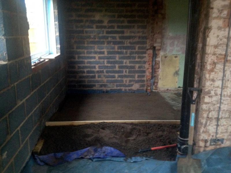

Started laying floor screed today: done about a third. I need it to go off so that I can construct stud-partition walls and get in the last three radiators. Boiler coming on Thursday!
Badly underestimated quantity of sharp sand! The main extension is 2/3rds done, but not yet touched the conservatory. Have used 3 bulk bags, and reckon I'll need at least 2 more. I need some concrete for the foundation of a new driveway/garden retaining wall, so I guess I'm buying 3 + 1 of ballast.
It's such hard work!
So having taken a break over Christmas & New Year, work resumes on the extension, and we're nearly finished ...
The floor screed is all down and drying out. We used just over six tonnes of sand + cement at 4:1, all mixed on site in a hired cement mixer, and that was damned hard work! I'm reasonably pleased with the result: quite flat and fairly smooth. I think that I'll put a very thin layer of cement-based self-levelling compound over the top, but I've saved a useful chunk of money.

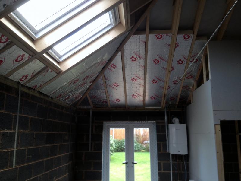

Next job is to get insulation into the roof (I've waited to have a level, clear, floor to make access as easy as possible). I'm putting 100mm Celotex between the rafters, and then 40mm more, bonded with plasterboard, over the top. Any tips for fixing? The manufacturers suggestion is to cut the board slightly oversize, and then to rely on a friction-fit - just wedge it in? I assume that as soon as I am ready to fix the PB over the top, it can no longer fall out, anyway ...
Should I tuck the insulation down behind the top of the wallplate, into the box behind the external fascia, or just fit the material flush with the inside edge of the rafters, resting on the wallplate?
There are a couple of places where I'm going to put Celotex/Plasterboard on the walls: there seems to be a paper-based surface on the insulation (rather than the foil for the stuff I used under the floor) - can you use plasterboard adhesive with that (dab & dot) or will it just fall off again?
Most of the insulation is now in. I'm hiring a platform to get to the top of the roof later this week (it's 4m), and will put in the last two sheets, and then overboard with insulated plasterboard.
I'm trying to decide how best to plasterboard around the velux windows, the frames of which have rebates, which I assume are to take the edge of plasterboard. I'm unsure of the best method of fixing the four pieces around each window, and joining them to the main boards across the ceiling ...
Your top and bottom Velux trimmers should have been angled or splayed so that the greatest amount of light is admitted.
The board slots in the Velux top and bottom reflect this.
Are you not fitting an underdraw of insulation to those rafters?
In any case, you will fix the plasterboard to the face of the rafters first, leave the plasterboards overlapping or even completely covering the Velux, then saw out the plasterboard in line with the board slots on the Velux after. It is easy once you have done one.
You then fix the reveal boards and measure them so that they come flush with the facing plasterboards.
