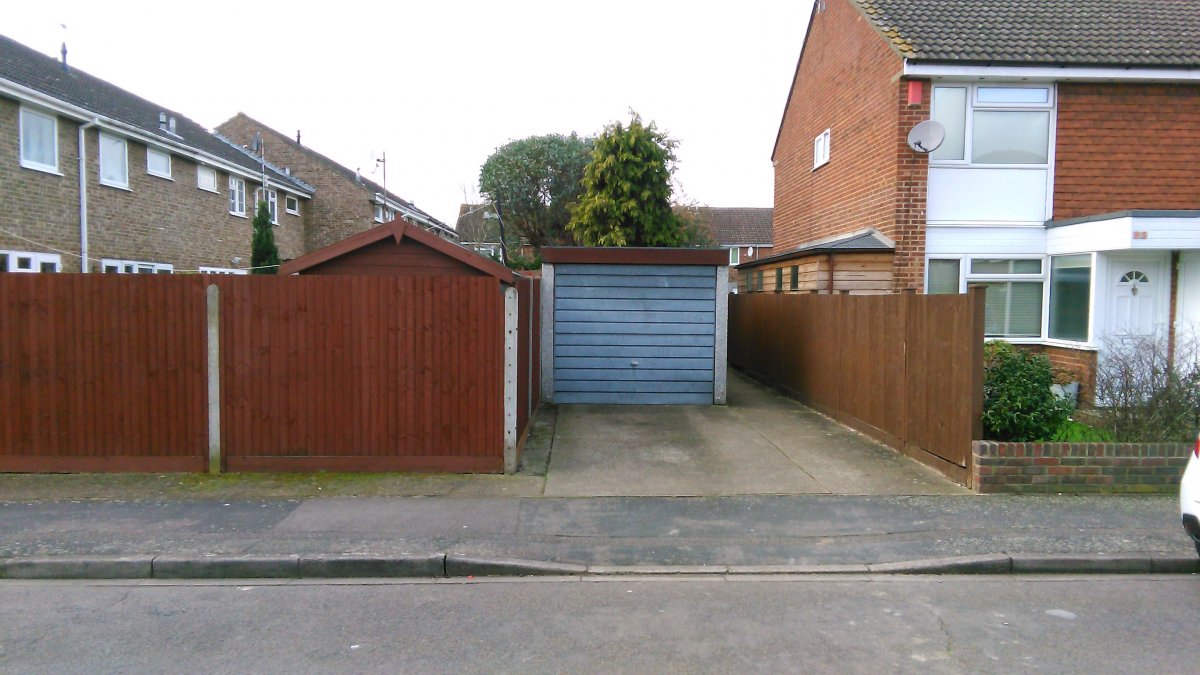

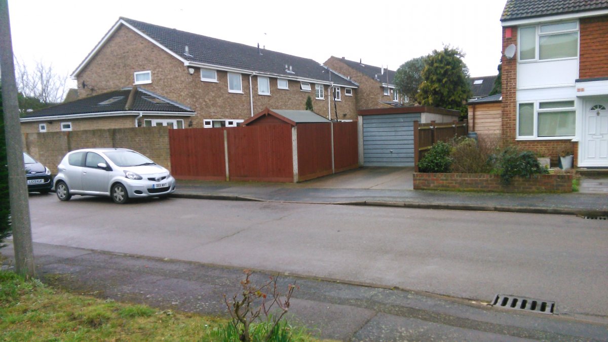

Sorry if this isn't the right place to ask my question.
First of all I am 34 year old & profoundly deaf from south west greater london' I would like to apologies in advance for my poor gammar and spelling but I will try my best to be clear as possible.
I am unable to get on the property ladder and struggling with high rent which is forever going up.
I had a discussion with my parents about the possibility of knocking down my parents garage and shed so i can build a one bedroom detached bungalow on their land so I can owned my own place. The land will be in my name and have my own new address.
The problem is Richmond council are not being very helpful letting me know if this plan of my would be doable or not. I ask for a 15 min meeting to show my plan but they are not interested.
I will have to pay a around £900 to show them my plan and they still won't tell me if possible or not.
I have put two pictures up, do you think it doable or not?
Thank you.
The loss of your parents' garage and the lack of parking for your own dwelling alone will be enough for a refusal.
Probably.
I forgot to mention noseall the drop kerb in the pictures I have put up i wanted to have the kerb put up so it is no longer a drop kerb where the garage is.
Also have a new drop kerb at the front of my parents house, it will improve the parking problems because I will have my van off the road too by parking on my parents drive.
Hope I am making sense here.

I reckon the only way you'll find this out is to chuck in a plan and if (when) it gets knocked back then go to appeal which is where you'll get a more impartial decision. As any new house is going to be worth a fortune in Richmond you need to get enough cash together to get somebody in to help who knows what they are doing. Look at it on as a better bet than some nag on the 2:30 at Doncaster.
The point is, if there are previous/recent applications which have been refused, then the likelihood is that this will be refused too.
Get some advice from a local planning consultant or [good] architectural technician. Free or pay for their time.
It might be worth approaching this as a granny flat, where by the development can be tied to the main house. Using your disability as a lever for independent living.
