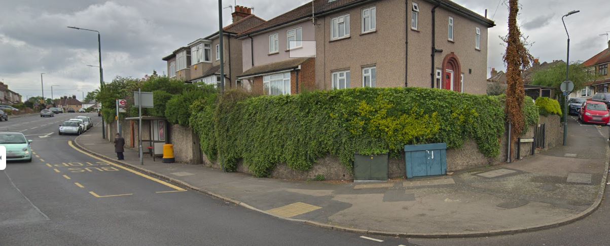

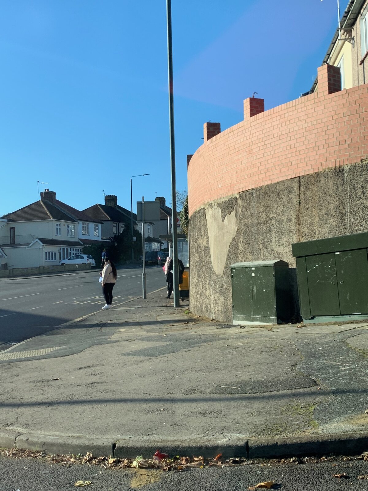

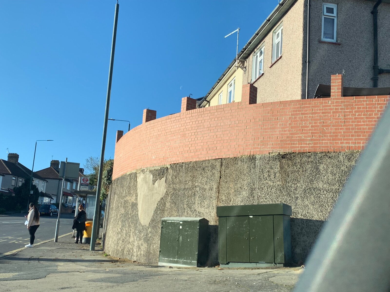

Hi folks,
I am concerned about a rather large brick wall that a resident has put up (he moved in in Summer). I have attached photos of what it looked like previously and what it looks like now. You will notice there is a bus stop which serves a number of schools and many people with kids wait there. Not to mention the walkway on the side of the house. If we ever had a storm like Arwen, and that wall collapsed, anyone below that brickwork would not survive. I am certain this build is illegal and that is probably why the previous owners never did anything this stupid. I would appreciate your help. I have been on hold to the council for 1 hour and no answer. I'd like that wall removed before it collapses on a member of the public and we are left with a fatality that could have been avoided.
This is the location on Google maps: https://goo.gl/maps/q24DBUpbrQ3iZsi16
Further to this, I doubt they go approval from the council and highly unlikely the council would have approved such a dangerous build.

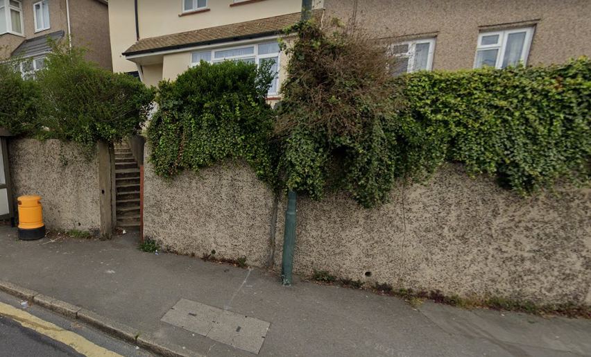

Well, obviously we can see that the house is considerably higher than the street, and if you look at the snapshot below, we can see from the steps that ground level directly outside the house is somewhere near the top of the wall.
Looking at the wall between the steps and the front garden, this would imply that garden level nearest to the wall in question is pretty much at (former) top of wall level (probably a couple of hundred millimetres down, I'd guess).
So the wall is a retaining wall and is already retaining a good couple of metres of soil and potential surcharge load.
There are a few issues in that respect with building another 1.5m or so of wall on top of it (and potentially it looks like they might be thinking about some timber panelling between the pillars, which would raise the new structure to 1.8m above existing).
That's quite a lot of wind load on a 9" wall, but they have, at least, also put in some 215x330mm piers, which do help stiffen the structure, as does the curve.
Anyway, making a few assumptions with regard to the wind load (shouldn't be too high in South East London) and flexural strength, I reckon the new portion of the wall, at least, is probably OK.
The other question is the affect the additional dead load and wind load is having on the existing retaining wall. We don't know if the wall is masonry or concrete, gravity, or reinforced. Assuming that the wall has no toe (as it would have to protrude into highways owned land) then any additional dead load will be over the heel (but closer to the front of it). Are the new piers built off the existing wall (assuming it is 330mm thick, or it thickens to 330mm not too far down)? You would hope they are built off the wall itself, but we don't know. Either way, the additional dead load will add forces that will likely contribute to overturning, bearing, and sliding forces, as will the additional wind load.
Definitely a wall that should have had SE input, with trial pits to check the existing wall structure and a design carried out to determine capacity with regard to the additional loads created.
Obviously, none of us know if that is the case. Those are my thoughts anyway...
The concrete section is a retaining wall, for the garden soil and looks original. That was originally surmounted by a growth of hedge, there are no planning rules on hedges. Having removed the hedge they have topped it with a brick wall and such need PP if they are greater than 1m high where they adjoin a road - that monstrosity would certainly need PP. Complain to your councillor and/or the papers.
