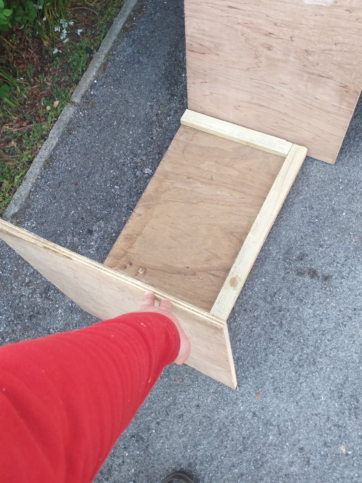

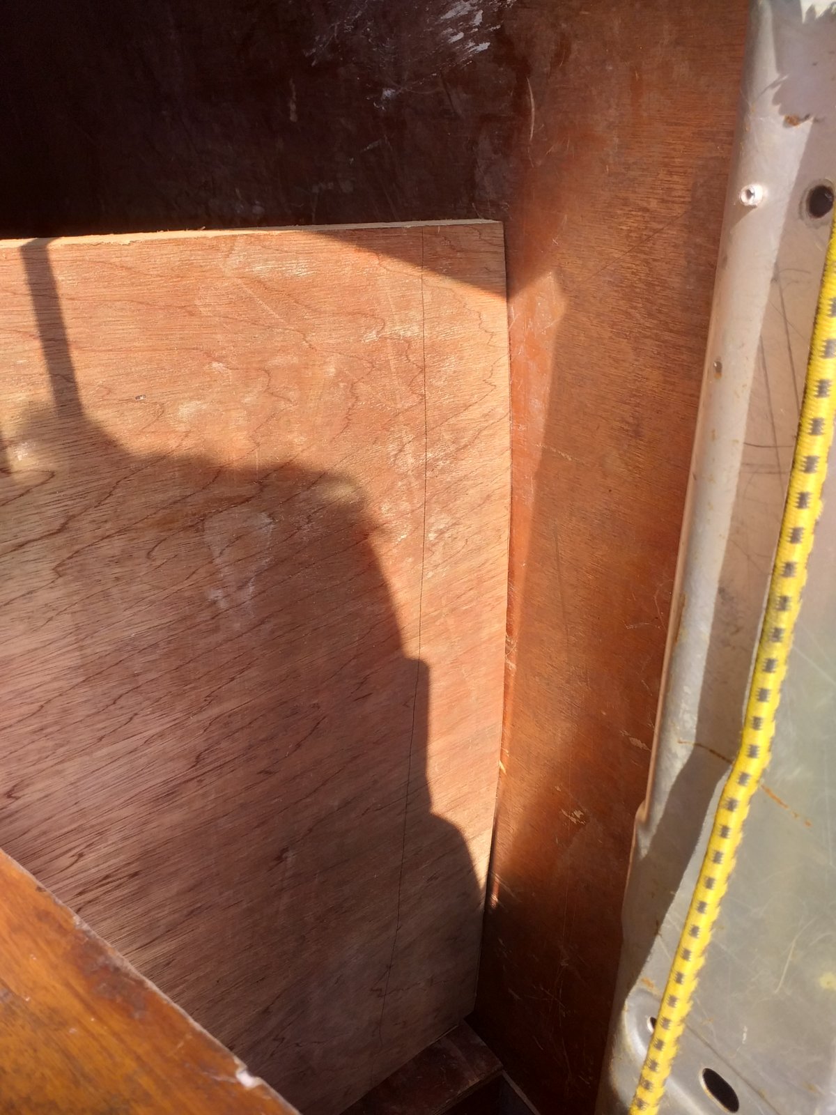

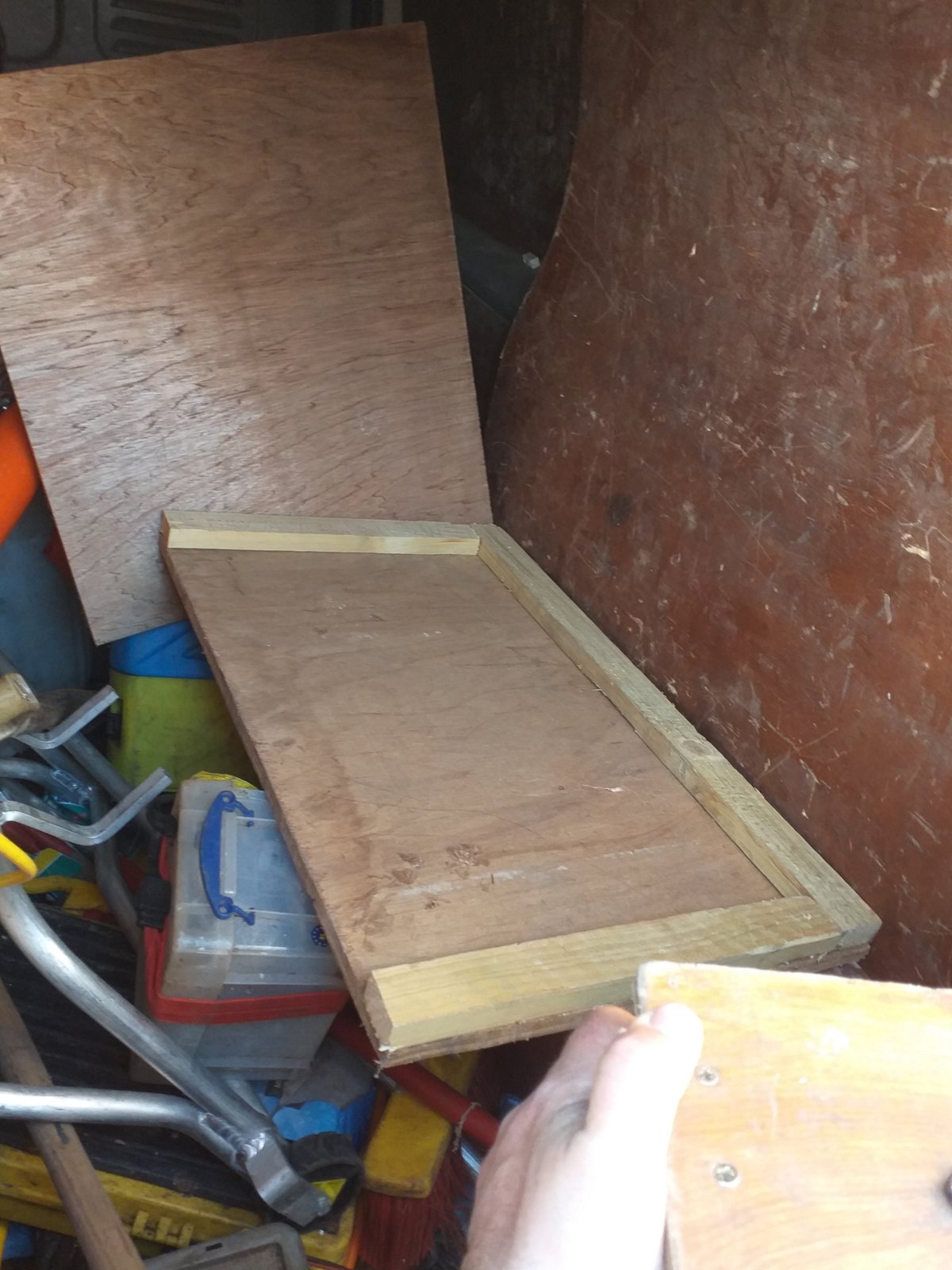

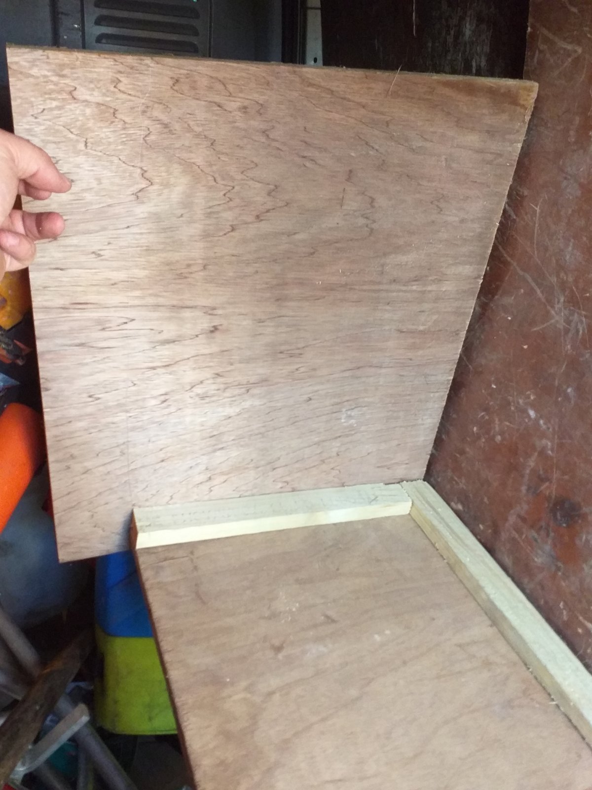

Trying to build a shelf for van and as the sides of van bow inwards; I was going to scribe the sides into the walls.
To do this, do you hold a pencil on the end of a bit of wood to follow the profile of the sides onto the wood (as in picture)?

Jigsaw with a blade which will cut medium to tight curves, e.g. Bosch T244D. Turn the orbit off

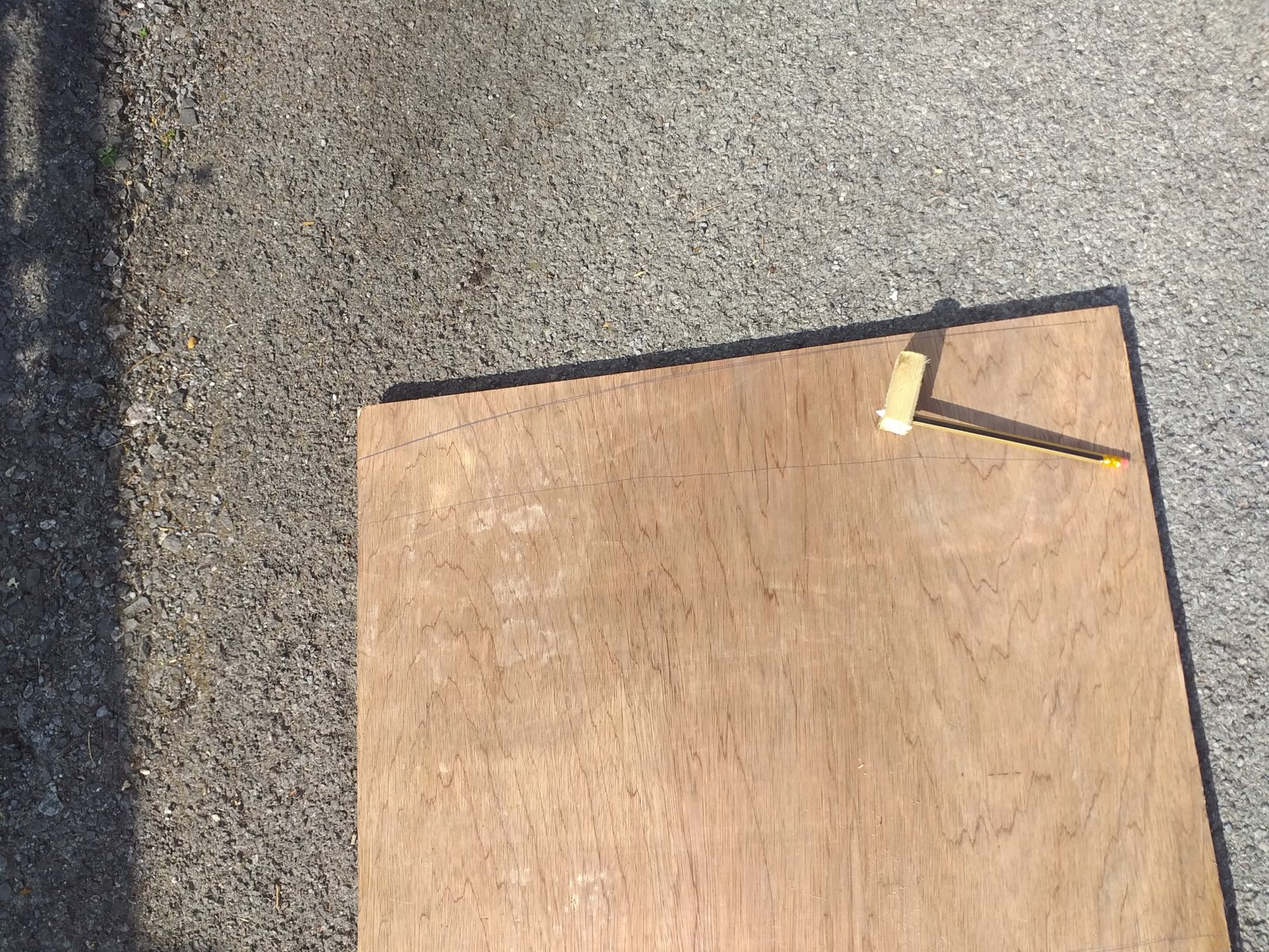

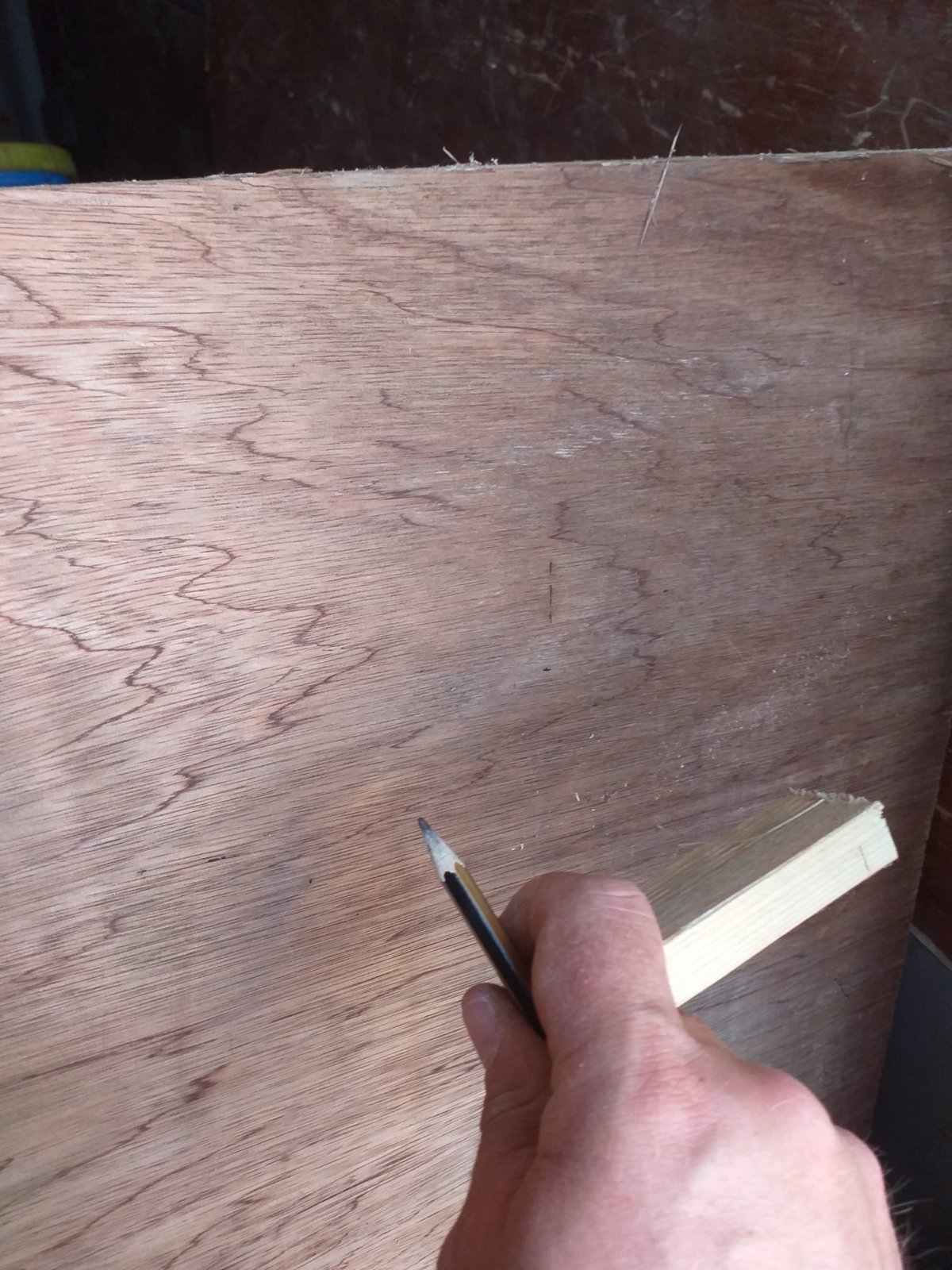

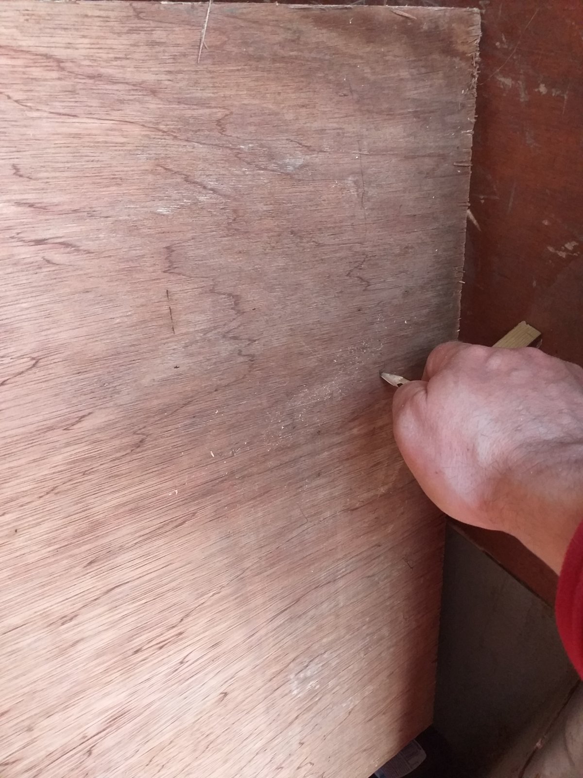

That's just the cutting isn't it? How do you mark the scribe mark? Pencil on end of wood?
Dividers with a pencil (or a school pencil compass), pencil and steel washer, pencil and small block of wood, etc. In your case it might be better to make up a cardboard or hardboard template which can be quickly and easily altered to fit the curve if the side then transfer that to the plywood when you are happy with the fit

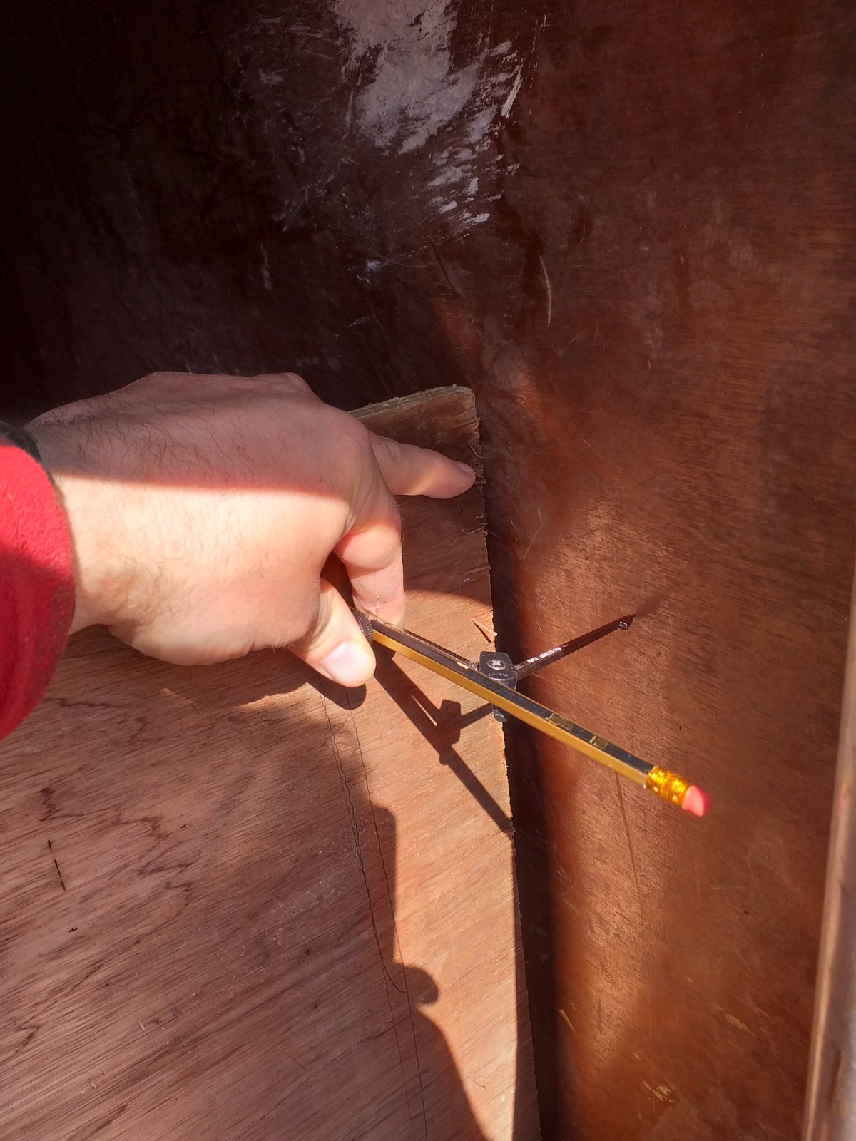

I tried the compass (set at 90 degrees) and bit of baton with pencil jammed into the hole. I used the baton (bottom photo) as couldn't get comfortable with compass. A bit shaky.
You arent using the compass right at all. Try folding the legs of the compasses in so that the gap between the point of the pencil and the point on the other leg is about 1in (25mm). You then have to keep the whole thing level whilst you mark the scribe cut. It takes practice

When you do a scribe line the priority is waste as little as possible.
