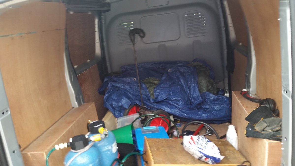

Want to put a shelf on the wheel arch of my van. The walls cave inwards towards top. How do u scribe wood to that?

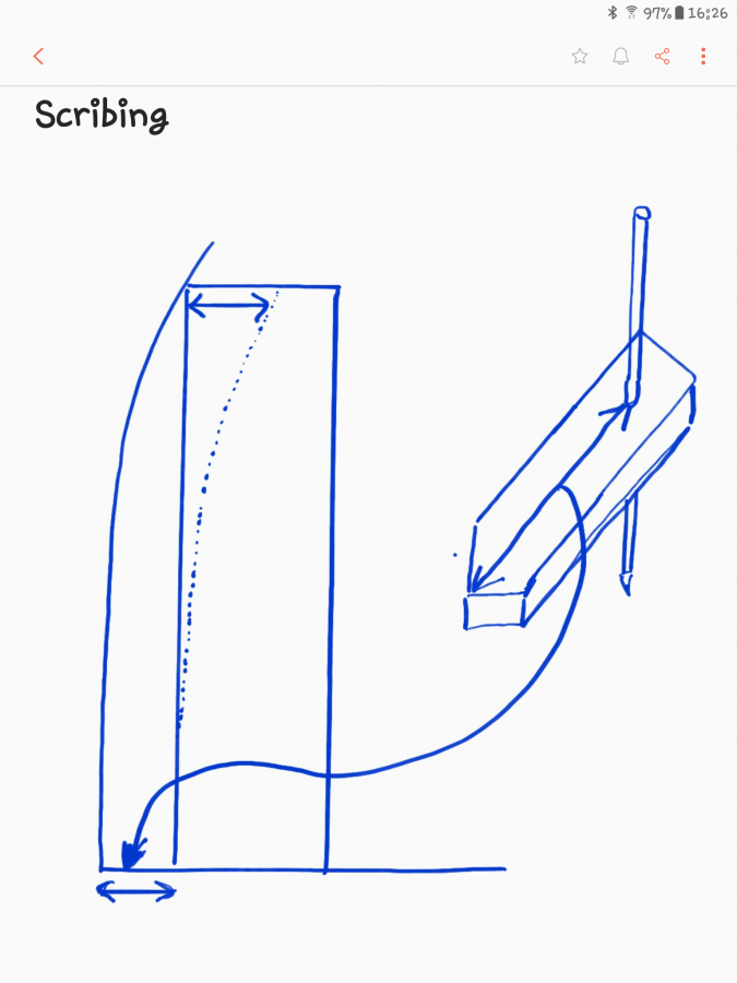

Excuse my very crude drawing but this is how I'd do it.
First off cut your end panel from some ply, height and width is your choice, offer it up against your vans internal lining, obviously it will touch in the top corner first as shown, measure the gap at the bottom as shown by the arrow, I don't know what you'd call it but make a marking tool out of some scrap 2x1 or anything really, cut a point on the end and transfer your measurement along it and either drill a hole and poke a felt tip or pencil through or even drive a nail through, now with this tool you can scribe an exact line from the van lining to the end panel by moving the tool up and down, the point follows the van lining while the pencil marks the end panel

Got it. I guess you got to keep the wood level so the line is bang on with a mini spirit level
