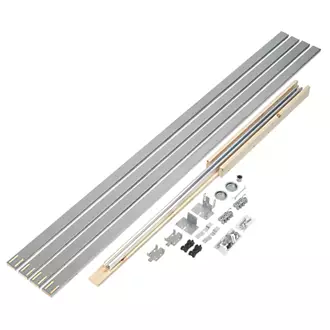

I fitted a set of pocket sliding doors room divider with in a stud wall with a span of 4.1m with no head plate connection to the ceiling, . Just used the yank method, they do it all the time...make a timber beam, sandwich c16 2 x 4x2 on edge between 1 4x2's and a 6x2 planned finish for the top, just to give a little detail and something for the plasterboard to fit up to. glue and screw @ 100mm centres.
Double stack the start and finish studs, the first stud finishes under top plate and the second stacks stud finishes under the beam bottom plate, this was just to allow for fixing the beam at top side and bottom.
It supports 2 x 75kg doors for a clear span opening of 2m. As its a pocket door there is effectively no support from the studs these are just to hang plasterboard on and are just metal lath with a wood stip to get a plasterboard screw started possible 1 inch thick. It does not move.

So, basically the same as a pair of 4 x 2 frames with a 4 x 2 binder on top. The 6 x 2, with an extra 1in overhang on both sides is going to be a lot more expensive. You then refer to a pocket door. Do you mean that? A pocket door retracts into a pocket within a hollow wall, which with even a 32mm thick door imies something like 150mm thickness normally

Job- the beam does all the work...and no normally you don't have do a 150mm wall as the sides of the pocket are faced with metal lath faced with wood as I pointed out ...the wall itself is 100mm and takes upto a 44mm door and final thickness of the wall is 120mm with both sides encased in 9.5 board or 125 in 12.5 board...see below. If you want to do both sides these can be bussed. I would have thought with all your years you might have come across them...I stated originally that that a beam design is excellent for walls with doors in them . If I just wanted to split a room I would probably go with your cheaper option, I was just pointed out how to add an opening of any size to a room divider....and a 6 inch top plate is an architectural detail I just think its nice to finish a board to something and have a small overhang...but you are going to have to cap it someway..who wants raw board edges poking out ?
