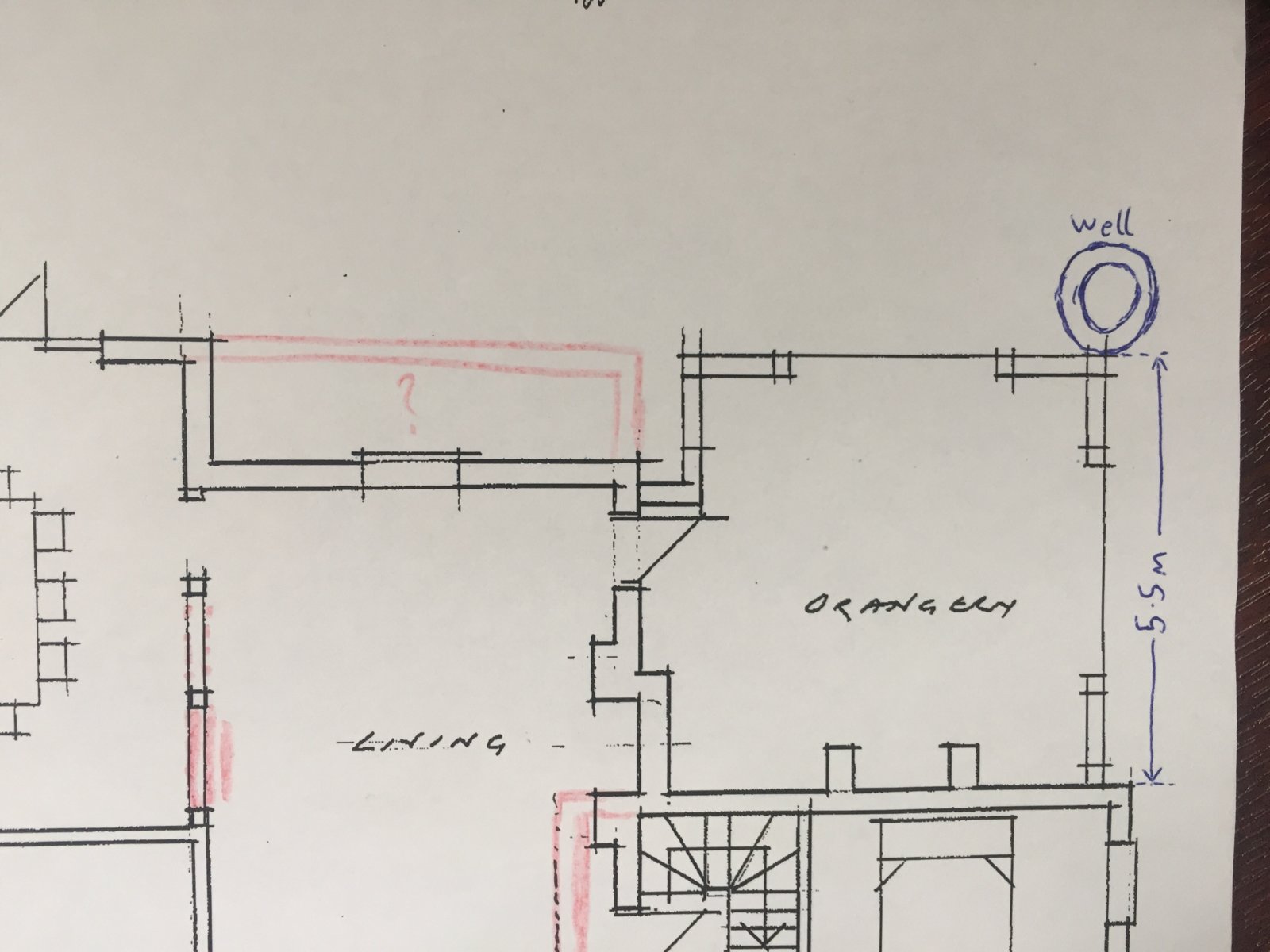

Hi all, newbie poster here!
We're going to be doing a remodel and renovation of a property we've moved into, and a single storey extension is going to be within a metre of an existing well. The well has a diameter of circa 1m and is 5m deep.
The builder is advising that if any foundation work is within 5m of a well it has to be supported by several boreholes around it to support? Which he said can get pricey.
Is this the only way? As I've seen in some other posts on here that a well can potentially be filled and/or bridged when actually building over them. As we're not building over it I hoped filling may just be possible?

if the well is empty and not fed by anything, then filling it up is the cheapest option.
your well is only about 4 cubic metres

Ive filled in a well 16m deep and had it approved by the building inspector.
The well was dry.
I think your builder is talking about a situation where a well still fills up -in which case filling the well will mean a build up of water pressure potentially causing heave, Im only guessing, but that seems a reason for boreholes..

Plan of property/grounds would help give a better insight to what your situation is.
The builder apparently thinks a borehole in some way "supports" a well -
"a well has to be supported by several boreholes around it to support?"
What do the boreholes do - relieve water pressure from a blocked-up well and gush water like when drilling for oil?
Sorry I don't have access to a scanner right now so have taken a photo on my phone. I measured off the original house plan which showed the well so it's in the right position. It will be pretty much touching the orangery so is even closer than I thought!

One for a structural engineer perhaps, or a redesign of the external corner of the orangery.
Hi, thanks for the reply, there was a retired structural engineer on site and he didn't contradict the builder. Based on the link at the top though I just hoped there may be another way as understand boreholes can be quite pricey.
The water in the well could be a heat source for a heat pump system,
Provided the walls of the well are sound then it will have no significant affect on foundation close to it,
