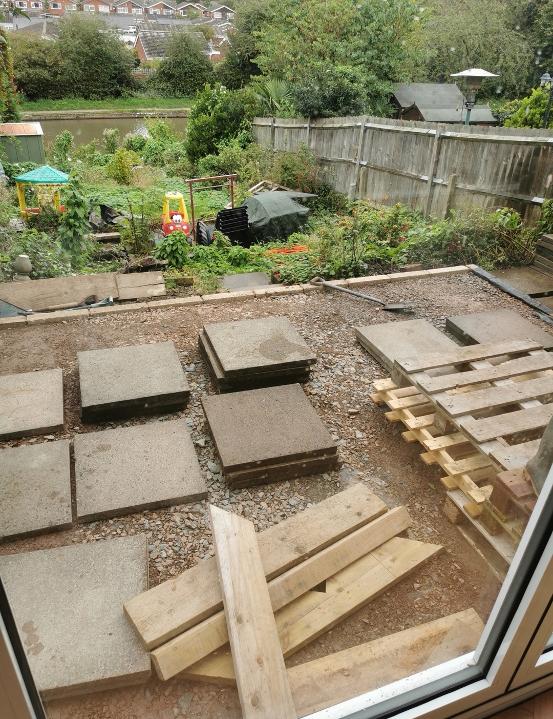

Hi all,
I'm new to this forum and looking for some advice
I'm preparing an area for a patio. Iv already done half and did a full on concrete foundation but I now need to extend it. I want to avoid the hassle of mixing concrete this time and I have a load of spare 50mm concrete slabs which I want to get rid of and thought i could I use these as a foundation to lay a 1 block high wall which i will then fill with MOT then sand. I guess I'm concerned about the adherence of the mortar as a apose to mixed concrete, but concrete is concrete right? Anyone had any experience of this?
Thanks!
What’s the block wall for? How does it relate to the patio? Why are you putting sand down? Pic might help
The block wall was to establish a shape and contain the MOT I filled it with and I used sand to lay the slabs on. I want to continue to wall to the right. Hopefully the pic helps to visualise.

The perimeter blocks should be on a concrete footing and haunched on the outside with the same concrete to stop them moving outwards. I’d avoid just putting them on slabs, as a proper foundation is continuous and prevents sections moving.
It's not clear what's being built on the slabs, but a 50mm slab on a 50mm solid bed of concrete/mixed screed should be good for about 700mm or so of 215mm brick wall. The main thing is whether you are confident that the base is not going to move or settle.
