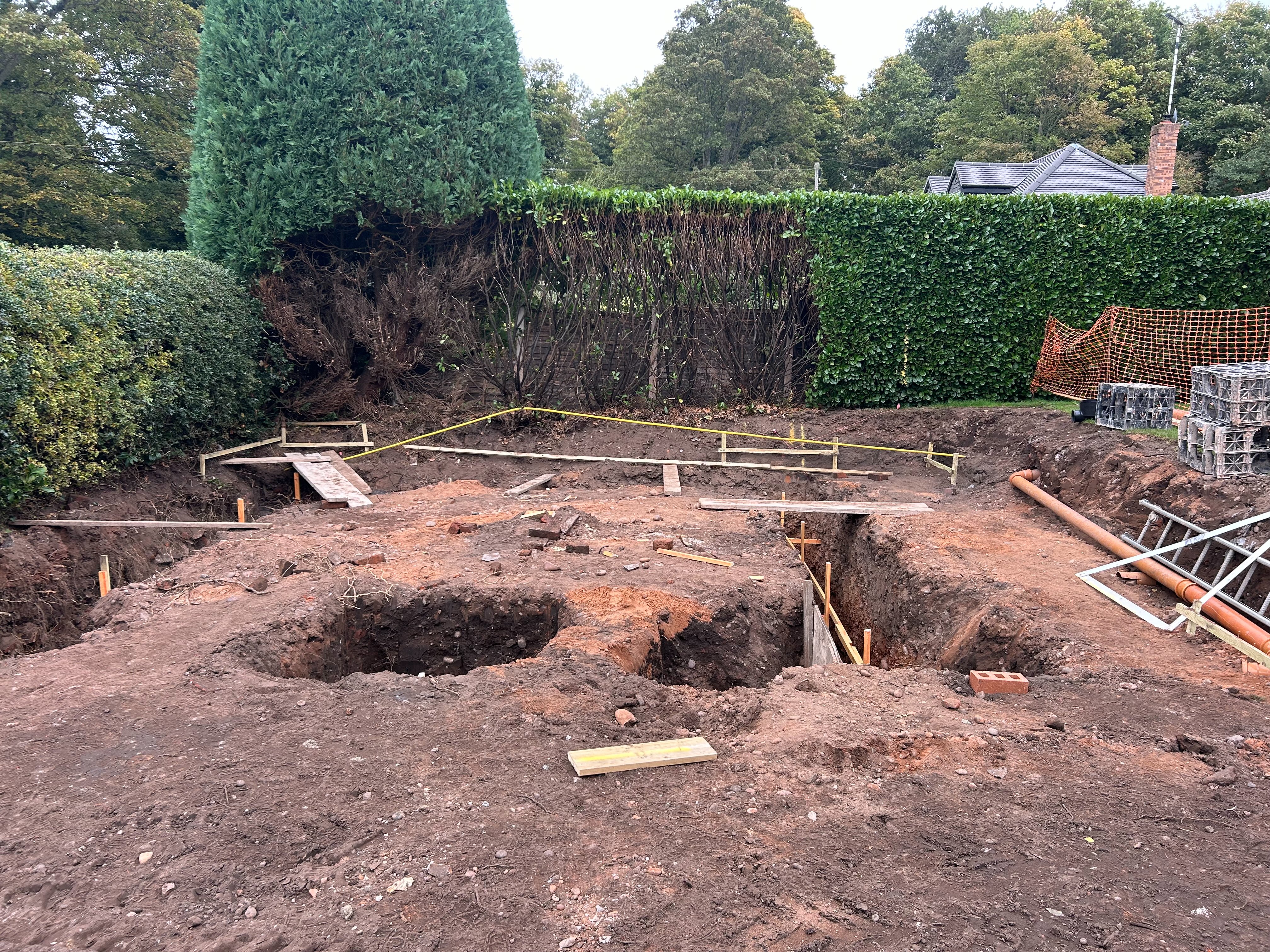

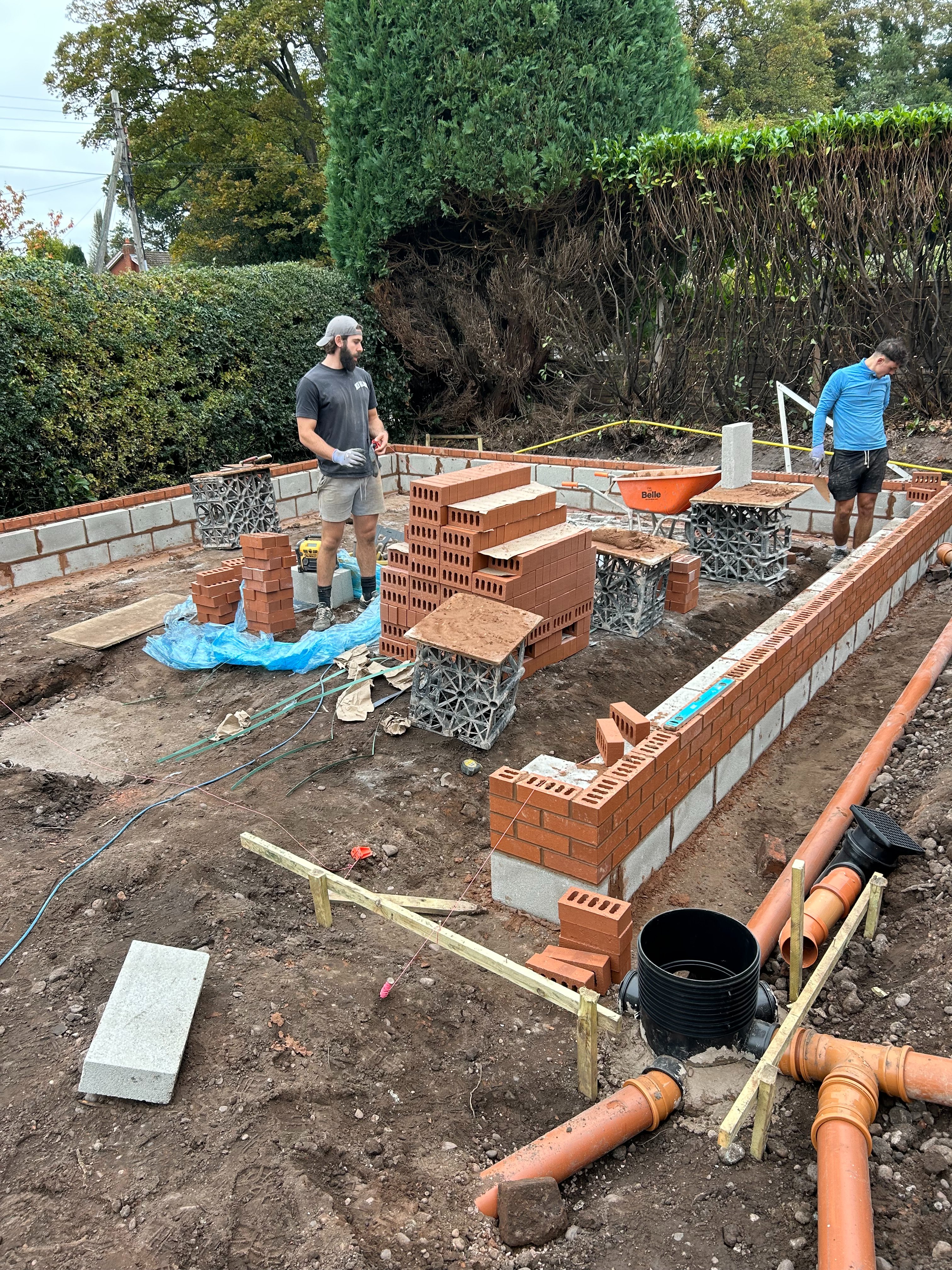

We built a detached garage from October through to December. Deeeeeeep risky foundations, hence the high end price of £60k for a 6m-ish square garage. It was cavity wall with insulation and clay tiled pitched roof...
We built into undisturbed sand. Foundations were a mix of 300mm deep x 450 or 600mm width, mostly. 2 layers of steel.
Quite the opposite of piling, really.....
