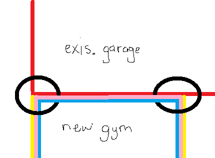

I am drawings the plans for a client who is having a small room, a gym (10msq) added onto the back of their garage. The new room will be sharing the existing wall to the rear of the garage.
The garage is not insulated, and adding insulation and plasterboard to the gym side of the wall will still leave a thermal bridge by the bricks. Are there any solutions to this problem?, other than demolishing the wall and rebuilding it?
The building regulations is quite confusing, it talks about retained thermal elements and 50% (the extension will cover more than 50% of the rear wall). But then has U values for retained elements and updating them etc.
Im quite lost and would appreciate any advice.
Lining with insulation deals with any thermal bridge doesn't it?
The new inner block layer meeting the old outer brick layer would thermal bridge I believe.
Here is a diagram, pink being the insulation, blue the new inner layer of the extension, red the old external layer of the garage
But doesnt the blue inner layer need to tie into the existing red wall for support, it cant just float there.

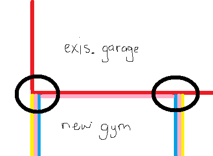

Or Ive just thought should there be an extra leaf added to the existing such as the new image, that way the insulation would be continuous? But then I guess the foundations would need redoing for that exisiting wall?

The garage is presumably uninsulated space (or close enough) and so the new gym is all treated like external walls, even the one where the garage is forming part of it.

Yes, it is the connecting of the walls that is the problem for the thermal bridging. I was hoping there might be a way to do it without having to demolishing the existing garage wall.
Is the existing garage single leaf? If so the traditional method of breaking into the cavity and extending it around won't work ( newer method of leaving cavity closed but using a thermabate vertical DPC is now typical)
The bridge won't be significant, but you are right to recognise it. A 25mm thermal plasterboard in those areas would be a solution.
Would also take care for any possible damp bridge
Would also take.care for any possible damp bridge
Yes, its single leaf.
Do you think that a timber frame construction with a brick outer leaf would be a better design for the new parts rather than the traditional brick and block? That way the shared wall could just have some rigid insulation and plasterboard added and there is not an inner block leaf to worry about not being supported.
Why not just stop the inner skin short? A few extra ties at the end will ensure robustness.

Thanks Tony, I was thinking of this but was worried about the structural support for the inner wall, but maybe the extra ties on the end will be enough.
