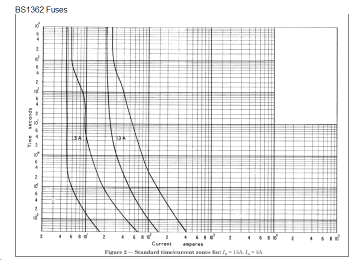

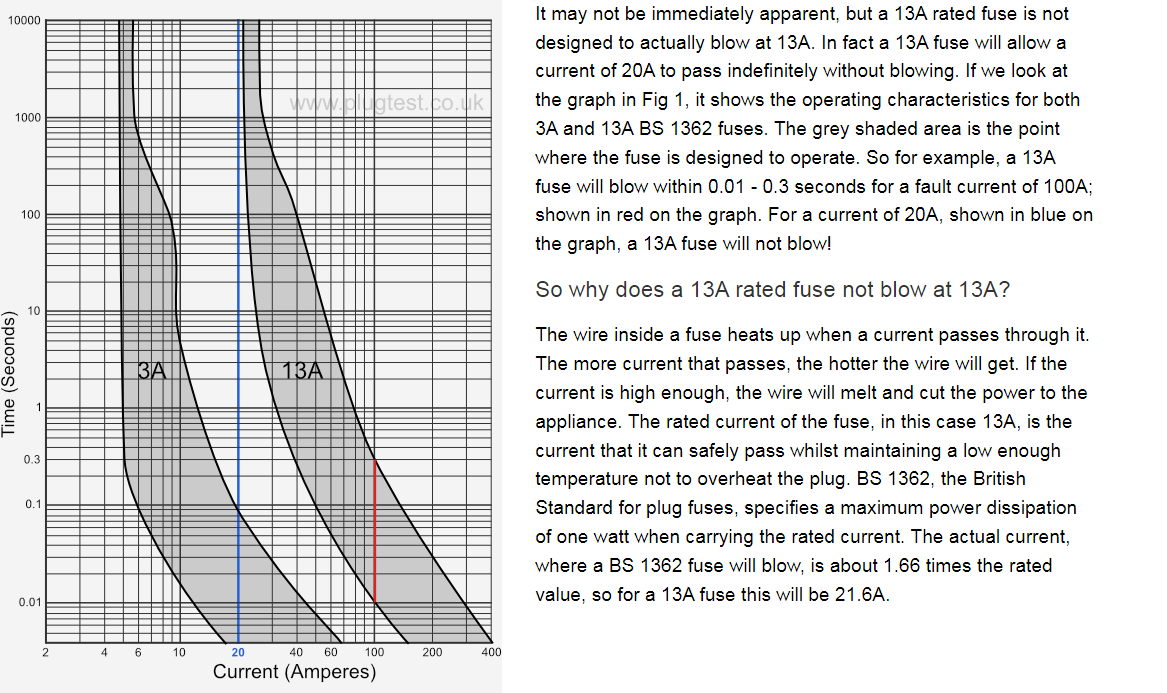

13A BS1362 fuse will support something like 22A continuously and indefinitely without blowing - so rather more than "quite a while" :)
Really ?
I believe that I had been "taught" that a normal "fuse" would carry its rated current indefinitely but would "Bolow/Rupture/Operate/Disconnect" within 30 seconds of carrying twice its rated current.
Hence. a 70% overload, such as described, should cause the fuse to "operate" at sometime short of eternity - even if more than 30 seconds !
Indeed. In fact, as we've often discussed, a 13A BS1362 fuse will support something like 22A continuously and indefinitely without blowing - so rather more than "quite a while" :)
Really ?
Yes, really ...
I'm not so sure about that "30 seconds" - are you sure you don't mean 30 minutes? The 'fusing factor' of a 'normal fuse' has, indeed, always been taken as 2.0 (i.e. relating double the rated current), just as the 'fusing factor' of an MCB is taken as 1.45 (i.e. relating to 45% over rated current), but the later relates to operation of the MCB within 1 hour at 1.45 x In - so I would suspect that the 2.0 figure (2 x In) fuses is similar (operation within 60 minutes - or, perhaps, within 30 minutes).
See above curves and the text above.
