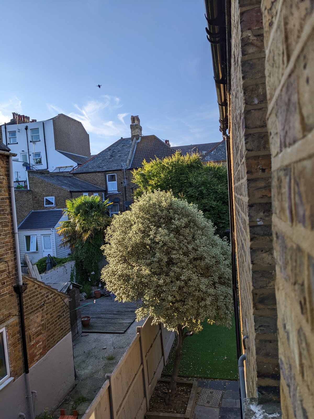

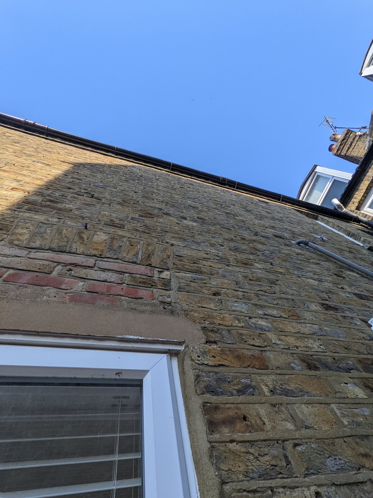

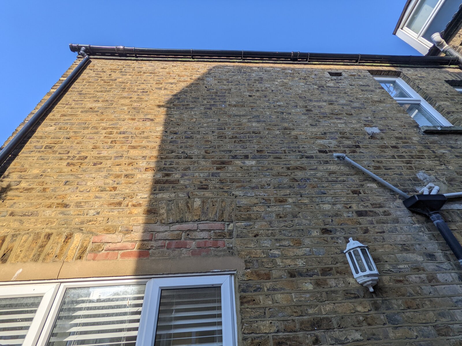

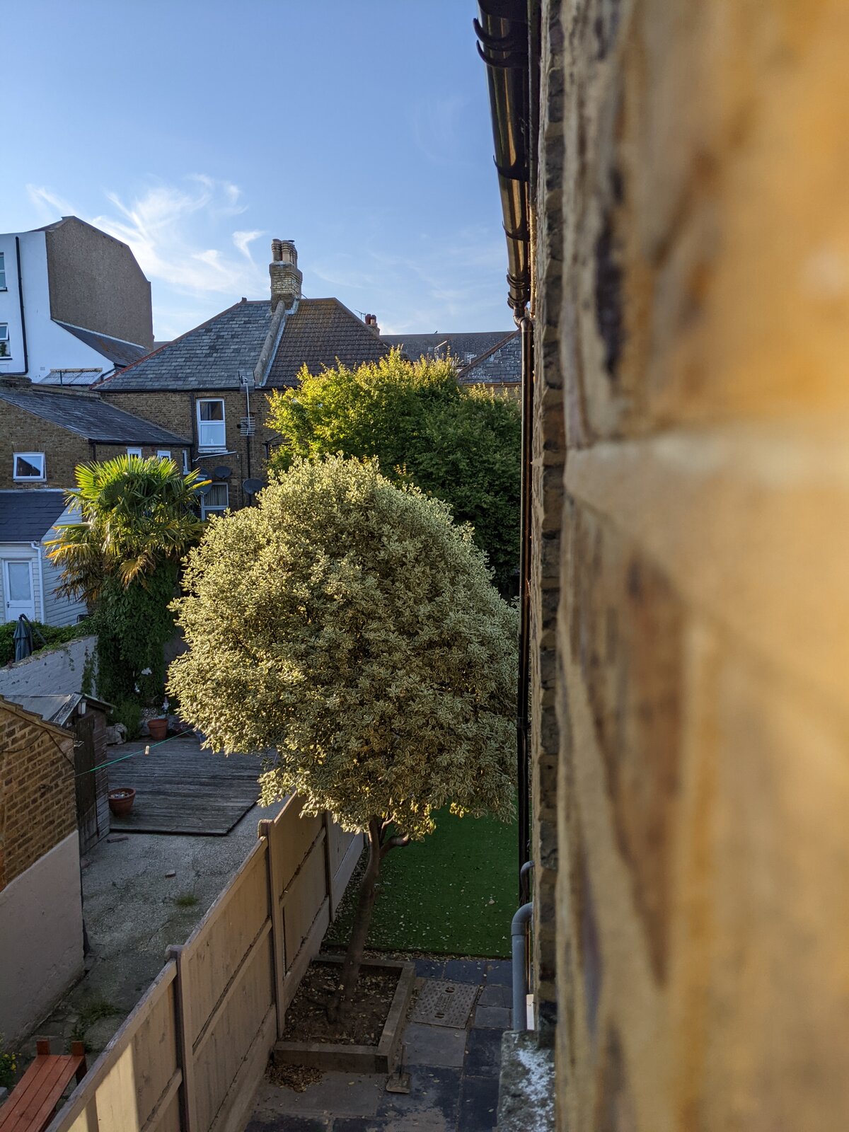

Feel like I'm going mad. Is this wall bulging slightly?

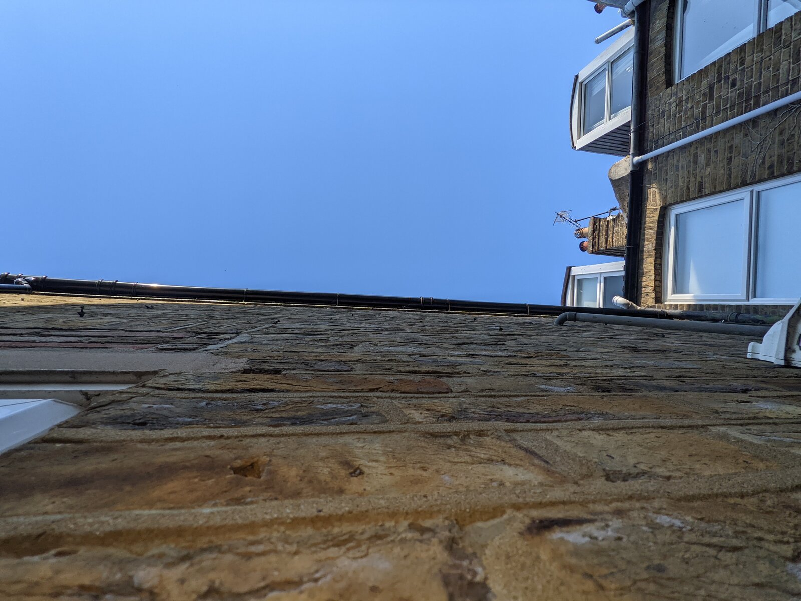

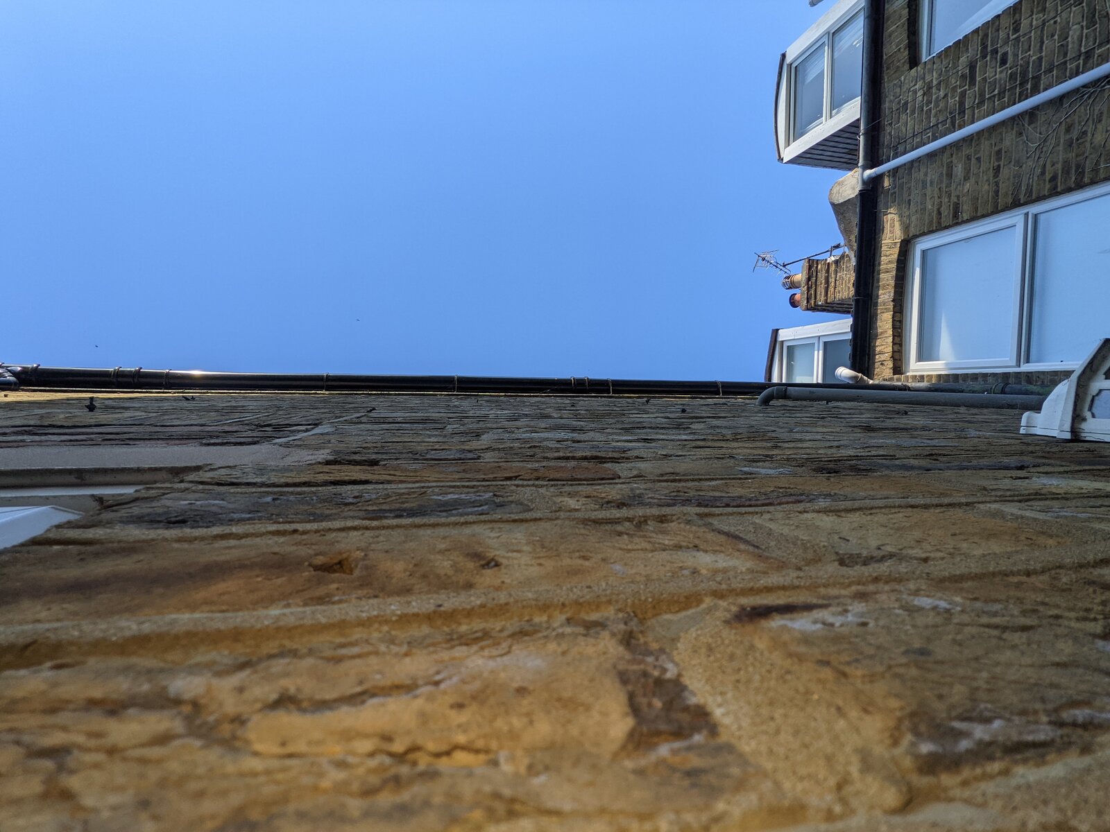

I can't tell from the photos but the downpipe seems to bow slightly. Your wall doesn't seem to have bulged since it was last (brick) pointed. If the pointing was quite a while ago, I wouldn't be concerned. Can you see cracks in side the house where the first floor walls meet at the corners?

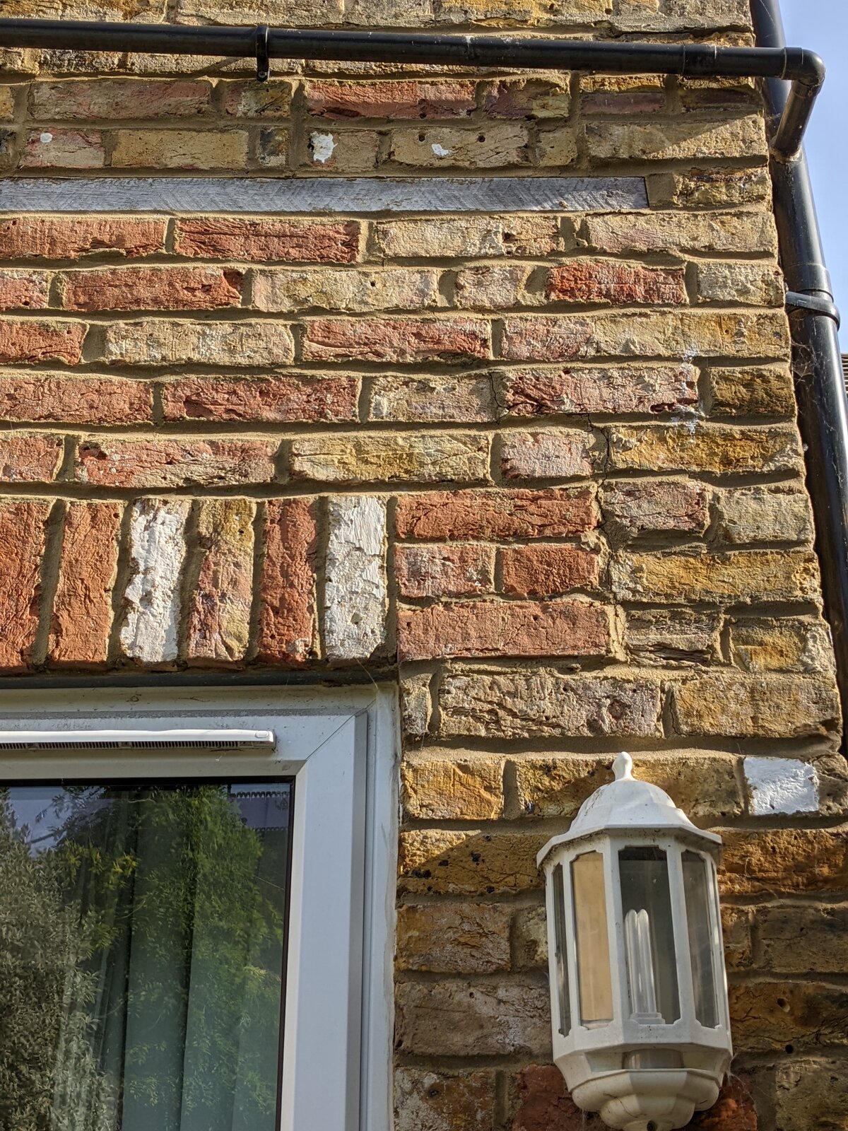

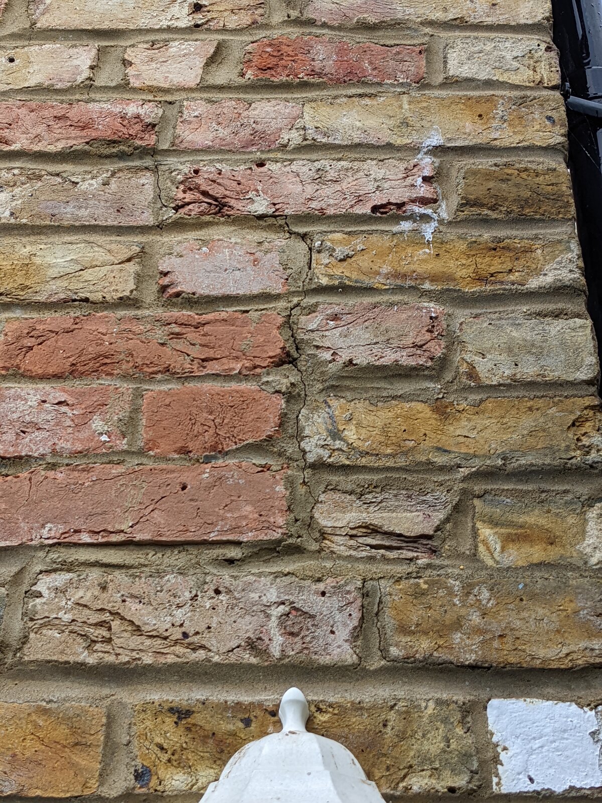

Pointing was about 5-6 years ago. Only crack I found in the picture attached. Otherwise all good. The downpipe bows because it's only clipped from half way down and they don't sit flush with the wall.

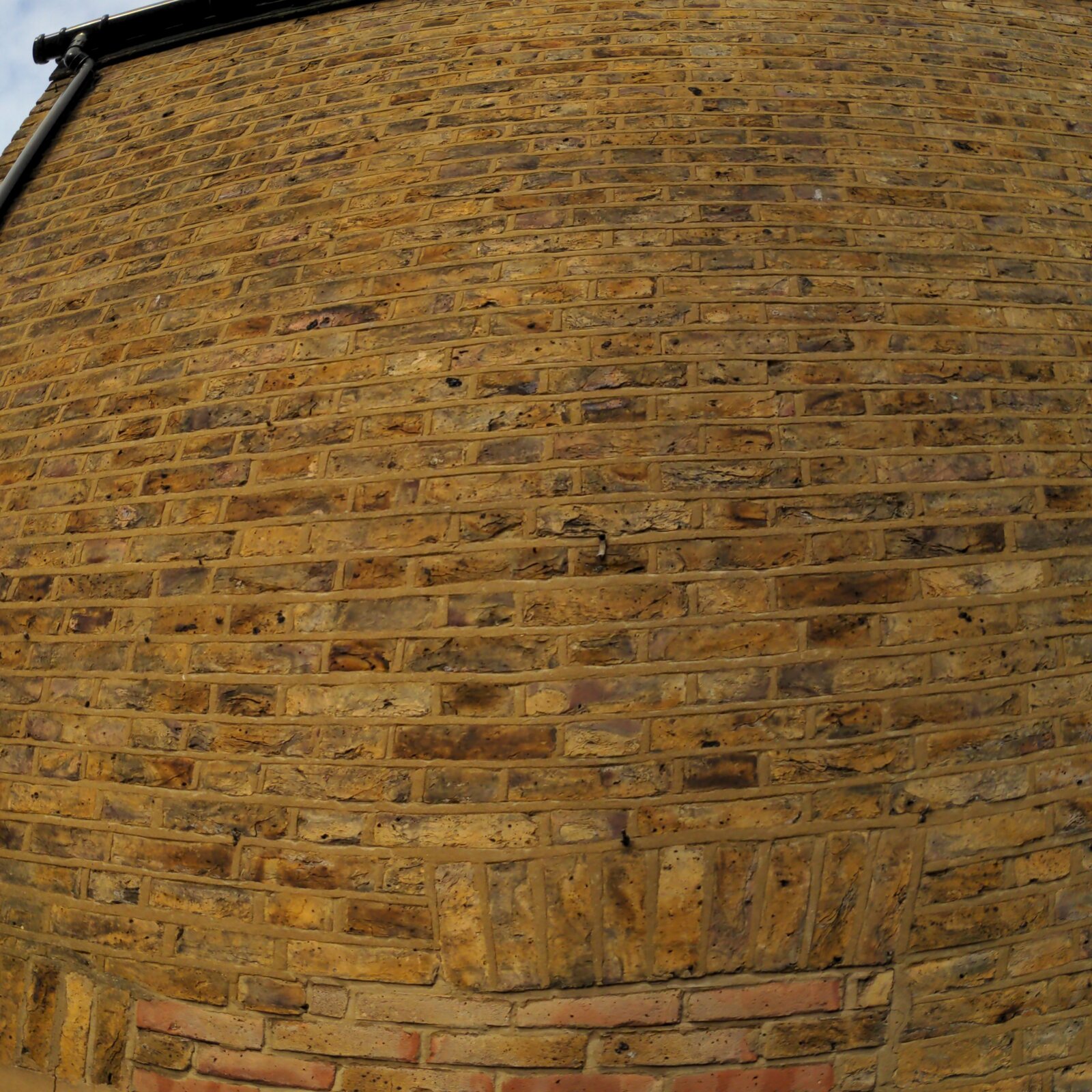

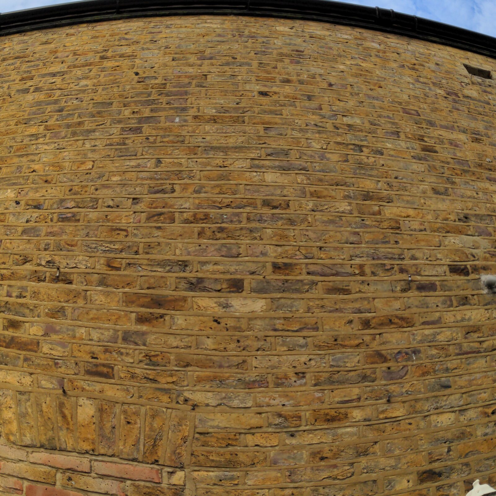

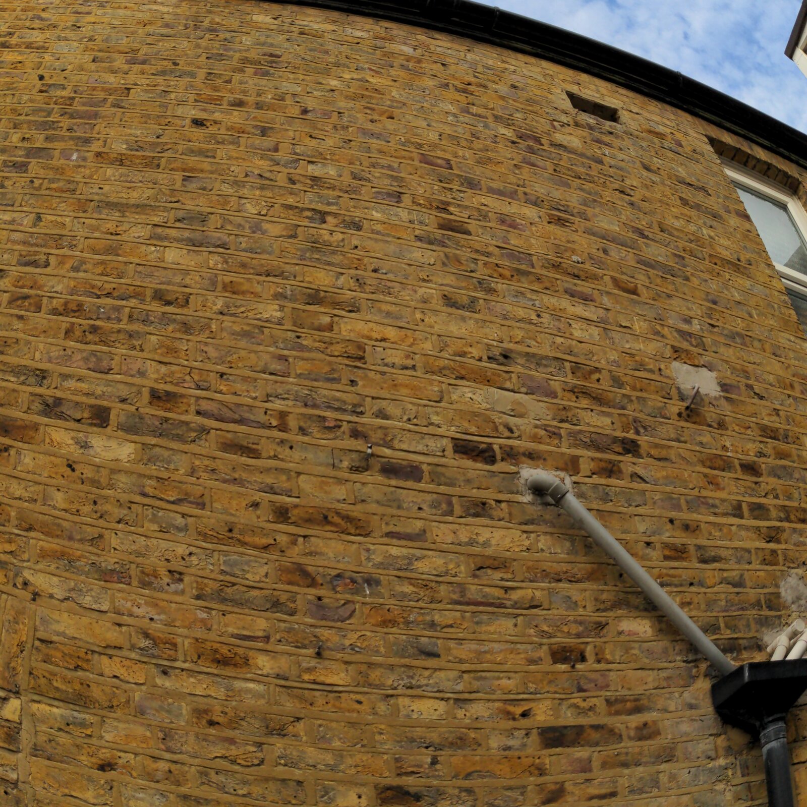

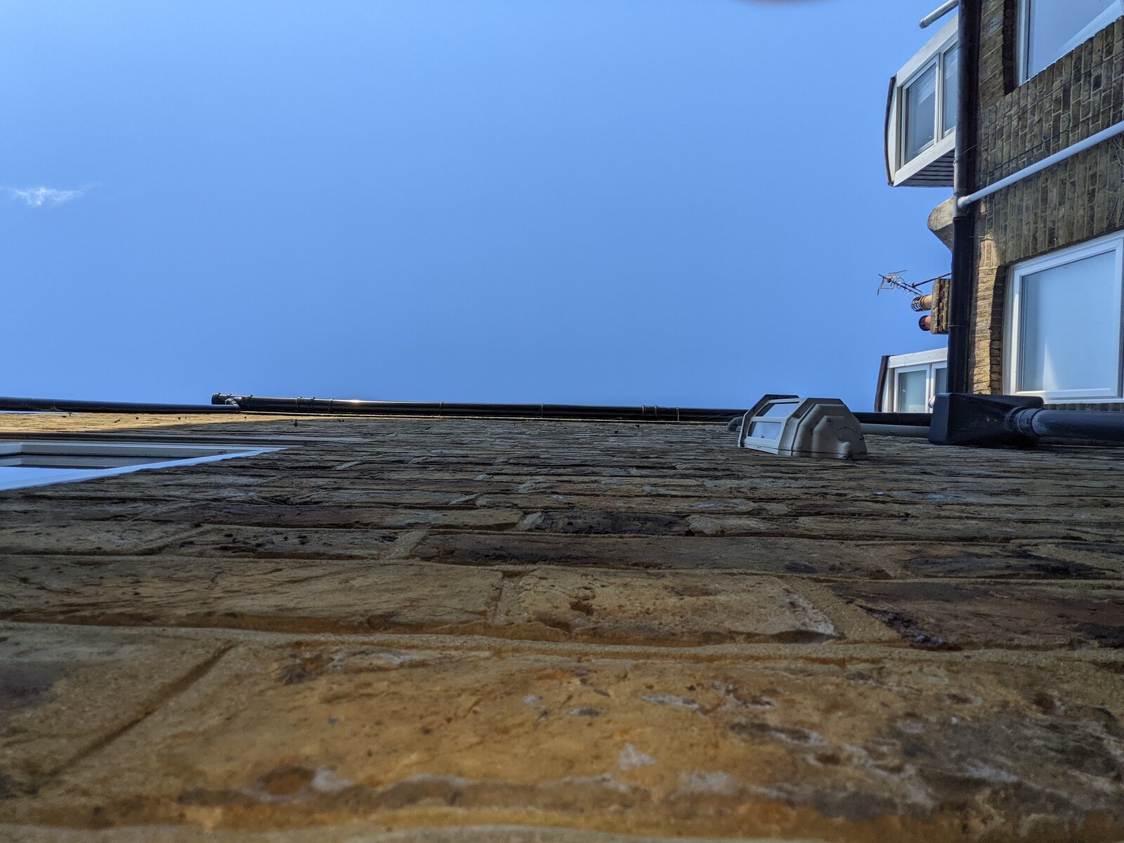

Woody see attached fish eye pics
Having had a closer look at that crack- it starts at the very top left and tracks all the way down in the image, moving its way right. That said it is a very minor crack, so again, I would not be overly concerned if it were my home.
Given that the brick pattern is not constant, I guess someone added the bricks at a later date.
If your talking about the crack then no idea. Could have been 5 years ago. See pic below. Crack is in that region near corner of window and French doors. Maybe just a settling thing after door were installed about 10 years ago.
I've only lived here for 2 years only just noticed it. Probably been there all along
