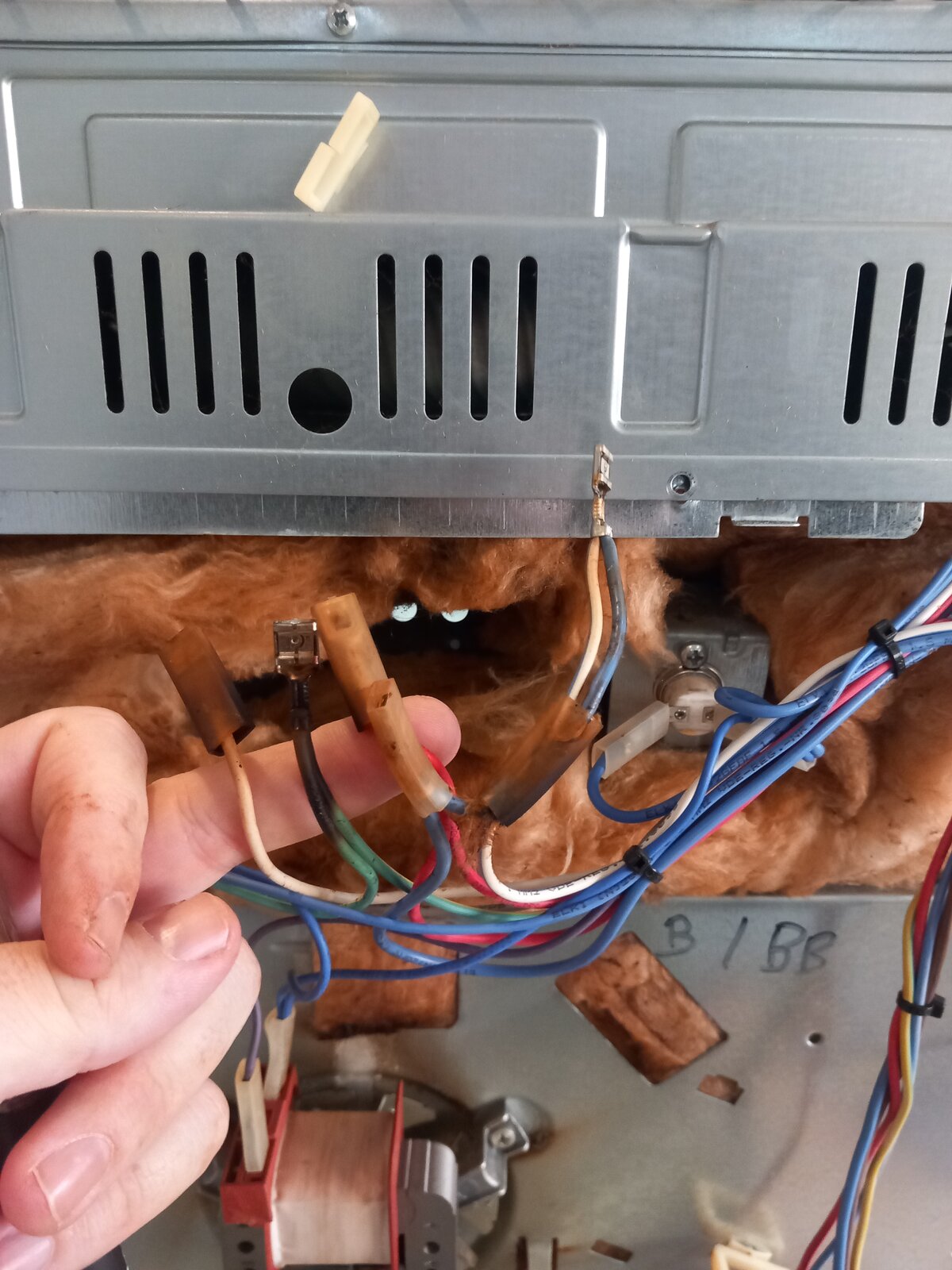

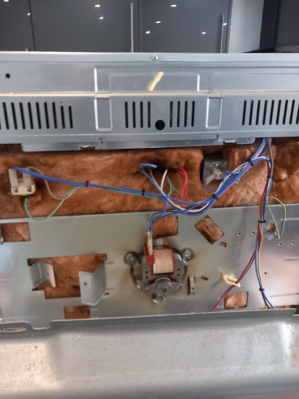

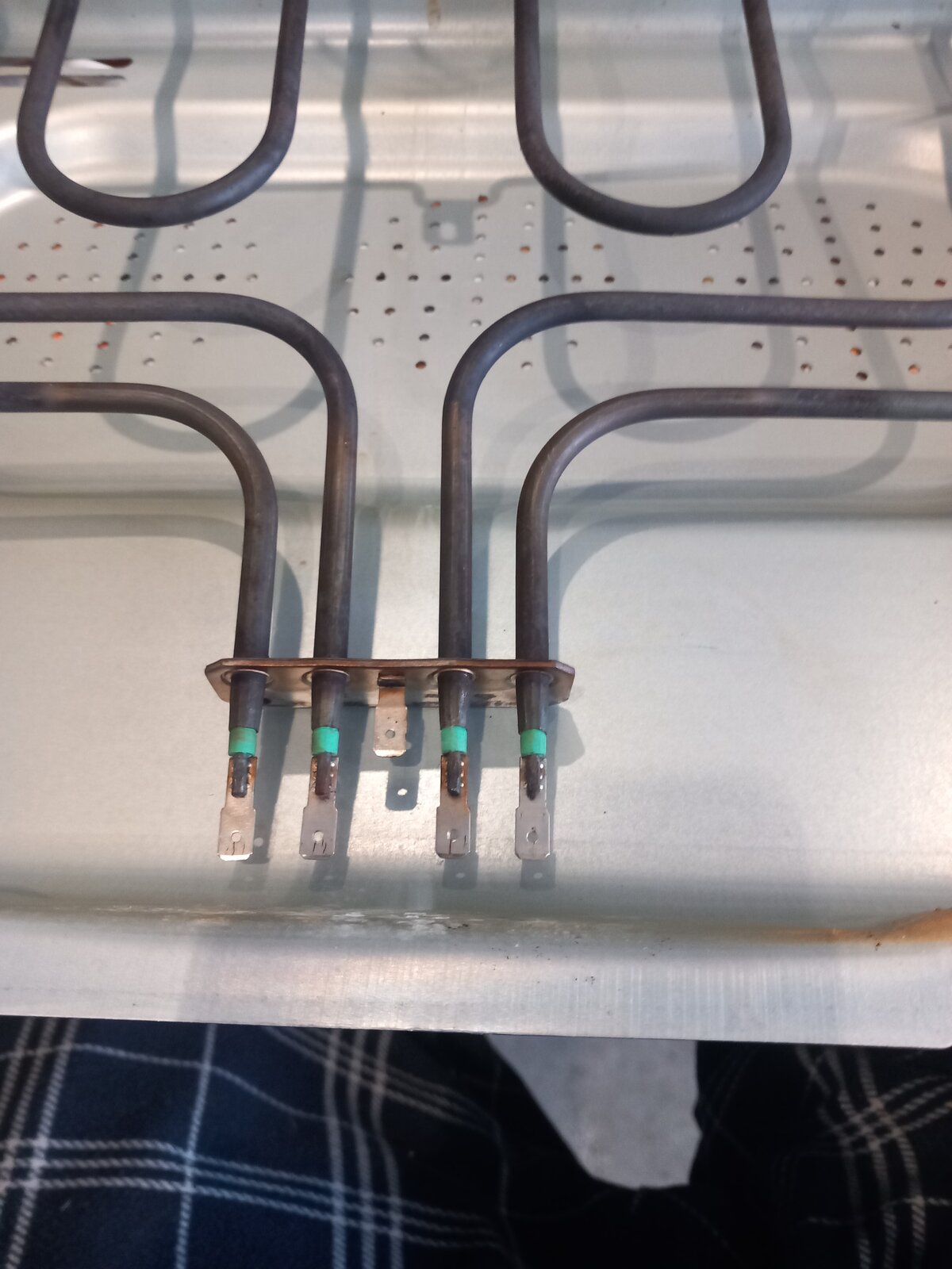

So the element went in our in built oven last night. It is a Bush BIOFOB and like an total amateur I forgot to note down which wires go where as my son was disconnecting the spades whilst I held the element to stop it falling as I had removed the screws. It has 5 spade connectors but I have no idea where these go on the new element. Please see photos below. If anyone can help please let me know which wires go where.
Thanks for any help
Lee

From memory: looking at the terminals from camera angle, put the green cabled one in the centre,3.
Put the double blue on 1,
Put the blue/white on 2,
Put the Red on 4,
Put the White on 5,
If the grill inner and outer elements are the wrong way round when heated, swap the Red and White over.
Good luck!
If that fails you will need testing equipment and the knowledge to use it.
