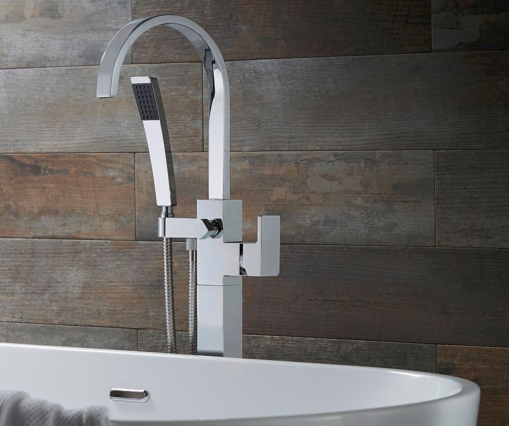

The boss has chose some wood effect tiles for the new kitchen. The sample in the showroom and the online photos suggest they've butt joined the tiles without using spaces/grout lines. I like the look of this but i was told a long time ago this is a 'no no' as the adhesive wont set.
Any tiling pros confirm if i can do this or not?

I would be concerned about the long term water penetration into the joints, especially within the spray area of the shower? over time, there is a "Possibility" that shower water could get behind the tiles and either the tile falls of or rot somewhere begins.
I work as an Insurance Claims Surveyor, as such I regularly see wood and plaster damage occasioned by water leaking out of shower enclosures caused by missing grout between the tiles? the missing grout scenario and a claim can be interesting to resolve from an insurance perspective?
Next concern is that there is no room for expansion and contraction of the tiles, especially of note in a long and high run of tiling.
Just some considerations?
Ken
the wood effect tiles in your pic are not in direct contact with any wet spray but still not a great idea.
all wood tile for my two pee need a min of 3mm grout/spacers.
use same colour grout and trim as the tile.
contact mfr's for advice if got doubts.

Edges be more prone to chipping without grout and bits of water could get under in , but it looks nice .And you might see unfinished tile edges .
These type of tiles are bannana shaped so remember to offset at least 1/3rd or less than hmmm
Also if I remember correctly the batch we laid was 1200 mm long , I also remember what is effectively the cross cut at the end of the tiles , some were not square.
In my experience to get the effect you want and level of accuracy would of been quite a few rejected tiles .
Take a set square when your shopping for tiles
Also note when you zoom in on the but joint it is low to the other tiles .
