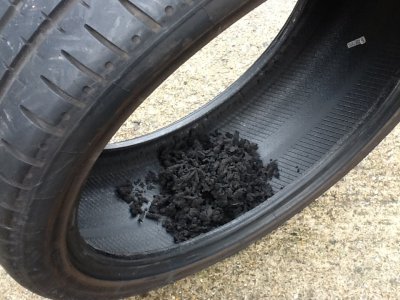

I'd never buy a tyre that I can’t see the inside of before it is fitted for the same reason as why you should have a tyre removed and inspected before a puncture repair is carried out. With runflat damage, the tyre will look perfectly fine on the outside but when you remove the tyre, you would find a couple of cupfuls of rubber crumbs that have shredded from the inner sidewall. Those tyres shouldn’t be repaired or used.

You have to assume that the tyre will be scrap and that you're happy to pay that price for the wheel on its own. The seller will not want the hassle of taking the tyre off and paying the disposal charge. Sometimes you get lucky, but more often than not, it's a cheap, no-name tyre anyway. (Depending on the kind of vehicle you're buying it for, of course)!
Runflat damage:
