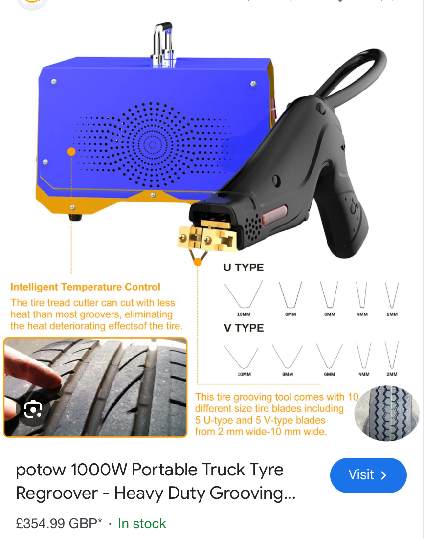

I had a tool for doing that on commercial lorry tyres. It was (and still is) legal on lorry’s but not on cars or light vans. You had to make sure you didn’t go down to the cords though. My tool was something like this:
