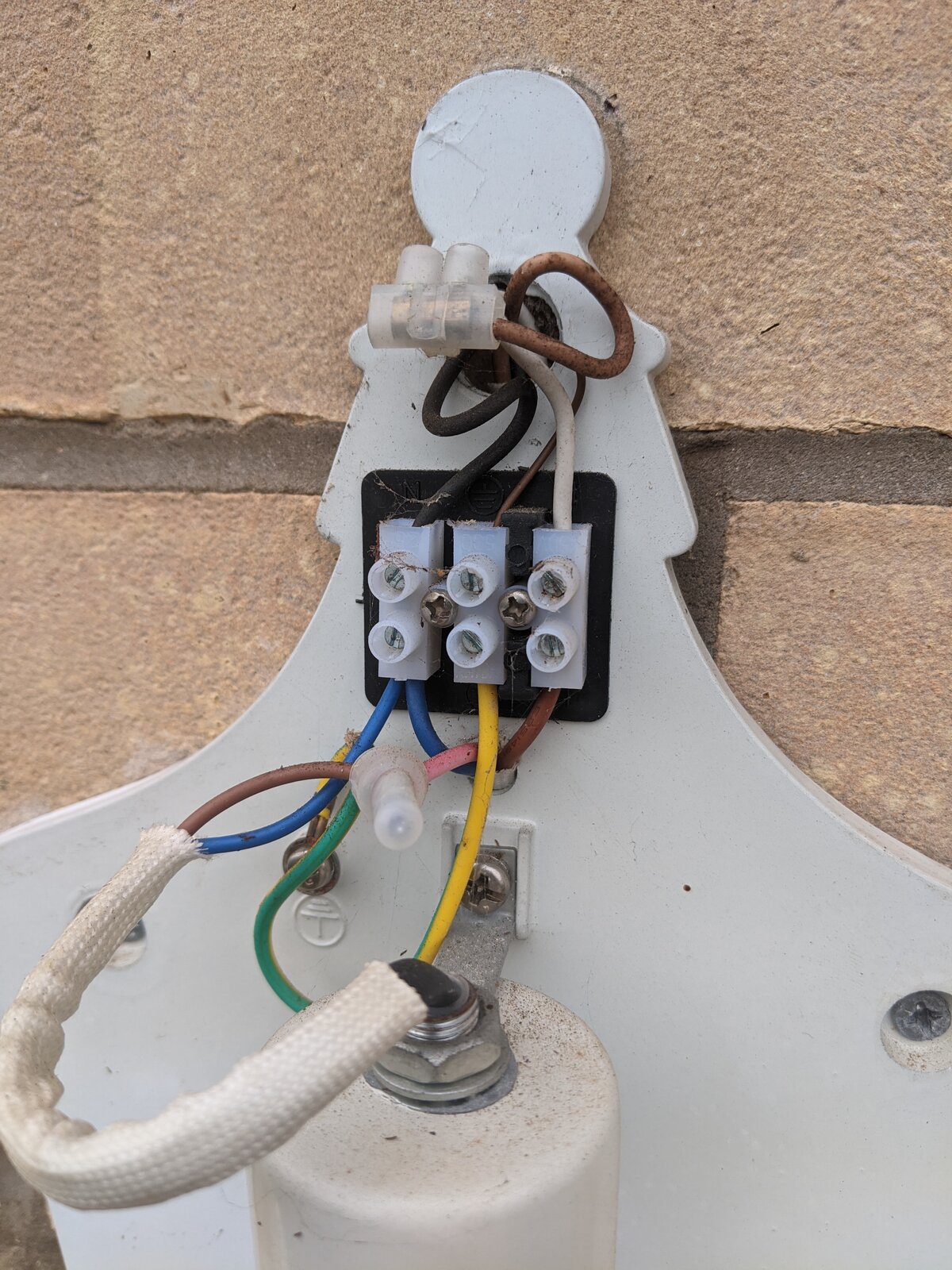

Hi all,
First time poster.
The pir on an outdoor lantern is playing up.
I'm happy to bypass the pir instead of replacing the whole fitting.
Obviously want to make sure i get the wiring right.
Is any able to advise on how to rewire the wiring in the following photo?
Thanks.
Ash
Is there a switch of some description indoors? Looks a bit odd.
The CPC/ Earth wire at top needs to have some sleeving
Hi, yes there is a switch indoors which i will then use to turn on/off instead of the pir.
Show pics of the wiring at the PIR.
If you intend to leave the PIR in place ,then the connections can be made at the PIR .
Otherwise you will need some testing equipment like a multimeter to identify whats what in the light fitting.
The PIR wires are the blue, pink, brown from the sleeving in the hole just below the terminal strip.
From the bottom of the terminal strip remove the blue and brown wires that go with the pink wire.
Cut the brown wire next to where it joins to the pink one, and put that brown into the right side terminal where the other brown was.
The set of blue/pink/brown wires are not required and ideally should be removed - you will have to take the light off the wall to do that - or at the very least cut off wo they can't contact any other wires or terminals.

Is this in the UK as that black, white and brown cable is an unusual combination.
I'll almost garuantee the brown is the old permanent live, for a previous fitting, if this light can currently be switched on/off from indoors.
So the white cable is the switched live? Sorry to bump old thread.. learning about electrics and did the think it would bump it up. New to this forum sorry.
White was originally grey, and is the switched line in this example.
Black neutral.
Brown not used, but probably permanent line.
Other installations may use different colours, it's fairly common to find black as switched line and the grey as neutral.
You cannot ever assume what a wire is for just based on the colour of the insulation.
Wire = single conductor
Cable = 2 or more wires combined into a single outer sleeve.
