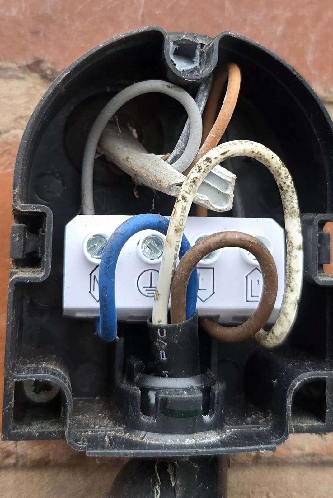

image.jpeg Hi stem
I was reading your post on how to bypass the sensor on a pir light. Your diagram says to link the live from the switch to the switch live going to the light. I have looked at the wiring in my pir and it seems to have 2 live wires coming from the switch. Could you tell me how I bypass the sensor in this instance please. I have uploaded a photo so hopefully this will help.
