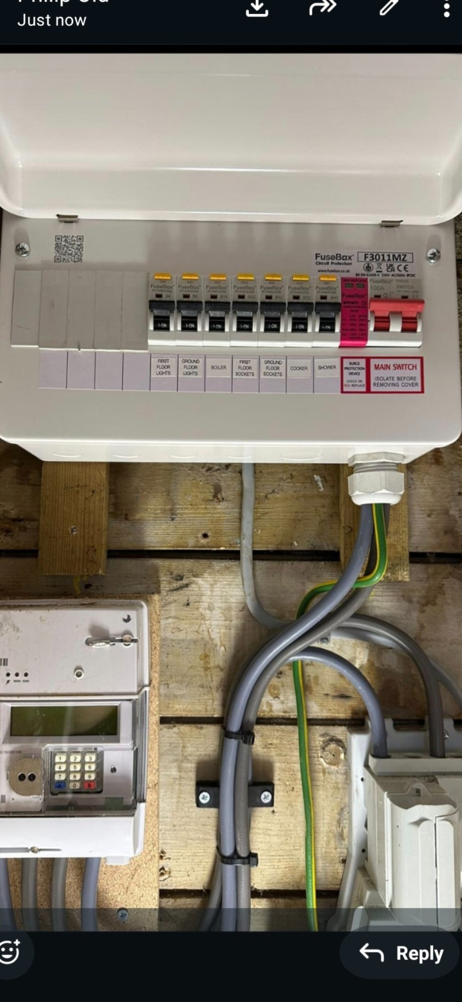

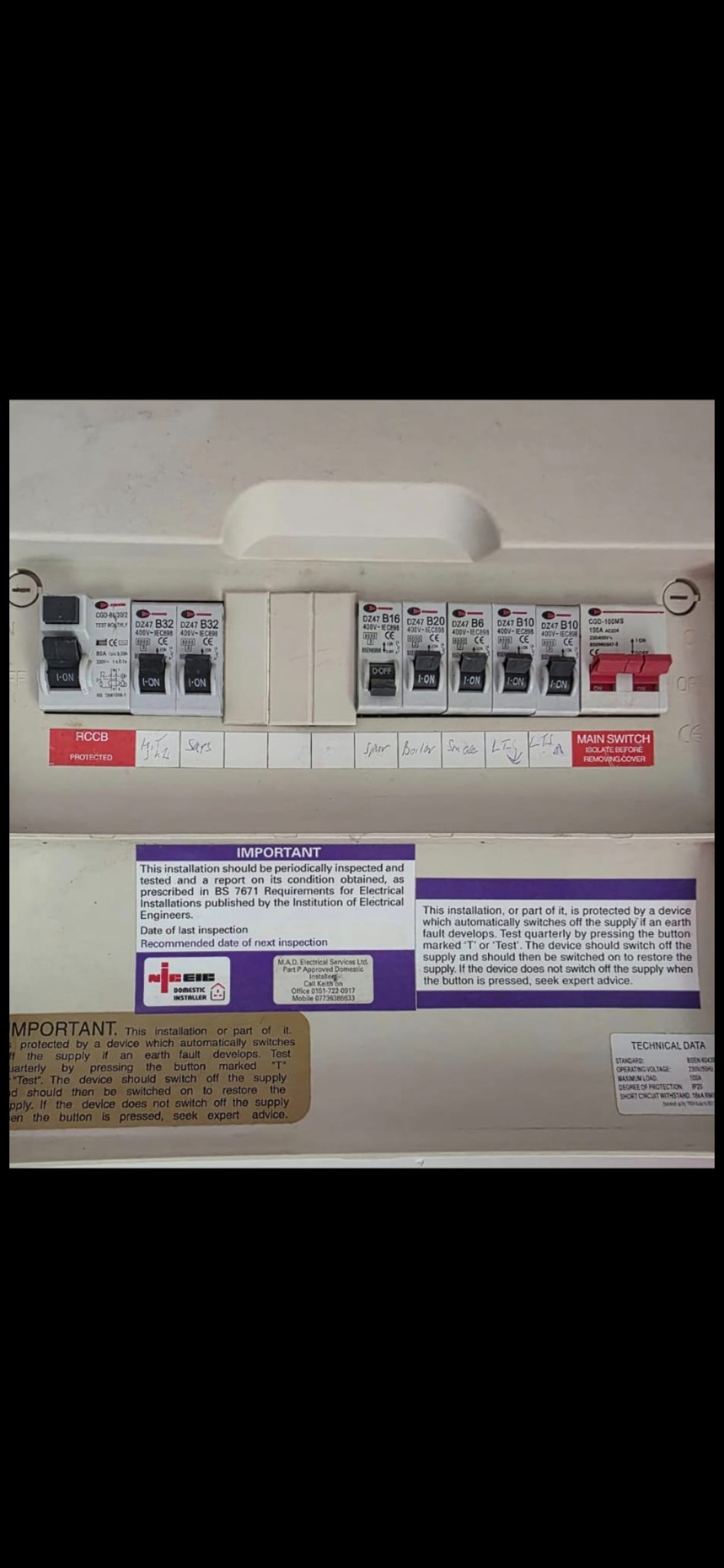

Had a EICR done and my consumer unit got a c2 for having blanks advised need to change
ge to.modules as well as some other c2.
Would them blanks be a c2 ?

If the blanks can be removed without a tool, and there are live parts exposed when removed, then one could not say he is wrong. The blanks should be of a design which will not allow removal without a key or tool.
These are firmly fixed, it needs the cover removing to take them out.
I personally would not award a C2 with these 1779439401776.pngunless CU where a toddler may play with it, but technically if you can remove without a tool then one could give it a C2, but I don't think I could get them out without a tool.

Missing blanks and direct access to copper C2 definitely but when you have to remove a blank to do this - comment or C3 imho

Consumer unit is ceiling height behind hall door. Most adults would need a step.
Had this brand new cu fitted in another prooerty last week.
This would be a c2 then

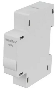

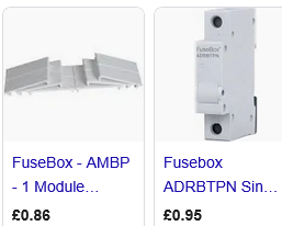

There is no MOT hand book equivalent for an EICR, it is up to the inspector, there is nothing to say they must even use the codes, it is down to the inspectors' opinion, he can code as he sees fit.

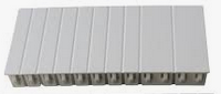

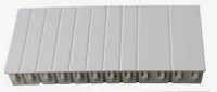

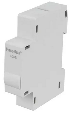

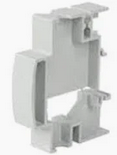

I would not code push in blanks myself, but neither can I say it is wrong, I see both types 1779442750918.pngshown as fusebox blanks. The fusebox CU has a lid
which means even if the box goes on fire, contacts are contained, in some cases consumer units can have a lockable lid, so maybe the push in type are for when the lid is lockable?
I think it is wrong to give a C2 to a push in blank, but I can't say another inspector should have same opinion to me. It is up to him was passes and fails, not anyone on a forum, but it should include notes as to why it has failed with manufacturers blanks. If they are Manufactures blanks.

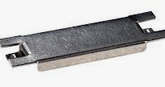

DIN rail as a German standard, but the opening for a MCB/RCBO is not, it seems all are 12.5 mm wide and IP rating for finger proof is under 12 mm, so the gap will allow a standard finger to enter, and the length of the slot does not seem to have a standard, so a blank for a fuesbox used on Wylex may not be correct dimensions to stop it being removed without a tool.
I would actually try to remove them, without any tool, can you remove them, or are they firm?
