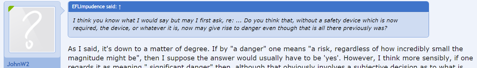

I think you know what I would say but may I first ask, re: ... Do you think that, without a safety device which is now required, the device, or whatever it is, now may give rise to danger even though that is all there previously was?
As I said, it's down to a matter of degree. If by "a danger" one means "a risk, regardless of how incredibly small the magnitude might be", then I suppose the answer would usually have to be 'yes'. However, I think more sensibly, if one regards it as meaning " significant danger" then, although that obviously involves a subjective decision as to what is "significant", I think that (as you are presumably implying) the answer would quite often be "No".
To use an analogy you sometimes choose; do you think that not wearing a seat belt may give rise to danger?
I'm not sure that is a very good analogy in this context. Not wearing a seatbelt obviously increases the danger/risk of someone suffering a serious of fatal injury. I suppose one might question whether, 'numerically', it was a 'significant' increase in risk/danger, given how low the probability is of any one individual ever suffering such an injury - but, again, that is necessarily a subjective judgement/opinion.
We've seen that with 'Pill scares'. Publicity of a finding that a particularly contraceptive pill, or type of such pill, may double or treble the risk of some certain (usually potentially fatal) side effect seems dramatic, and will usually result in substantial numbers being panicked into stop taking those pills (hence consequential unwanted pregnancies, and the risks associated with them). However, if the 'doubling of risk' is (as been the case with some the 'scares') the 'doubling' has been a change from "1 in 2 million" to "1 in 1 million", the many rational people would probably regard that as not being "significant".
Kind Regards, John
