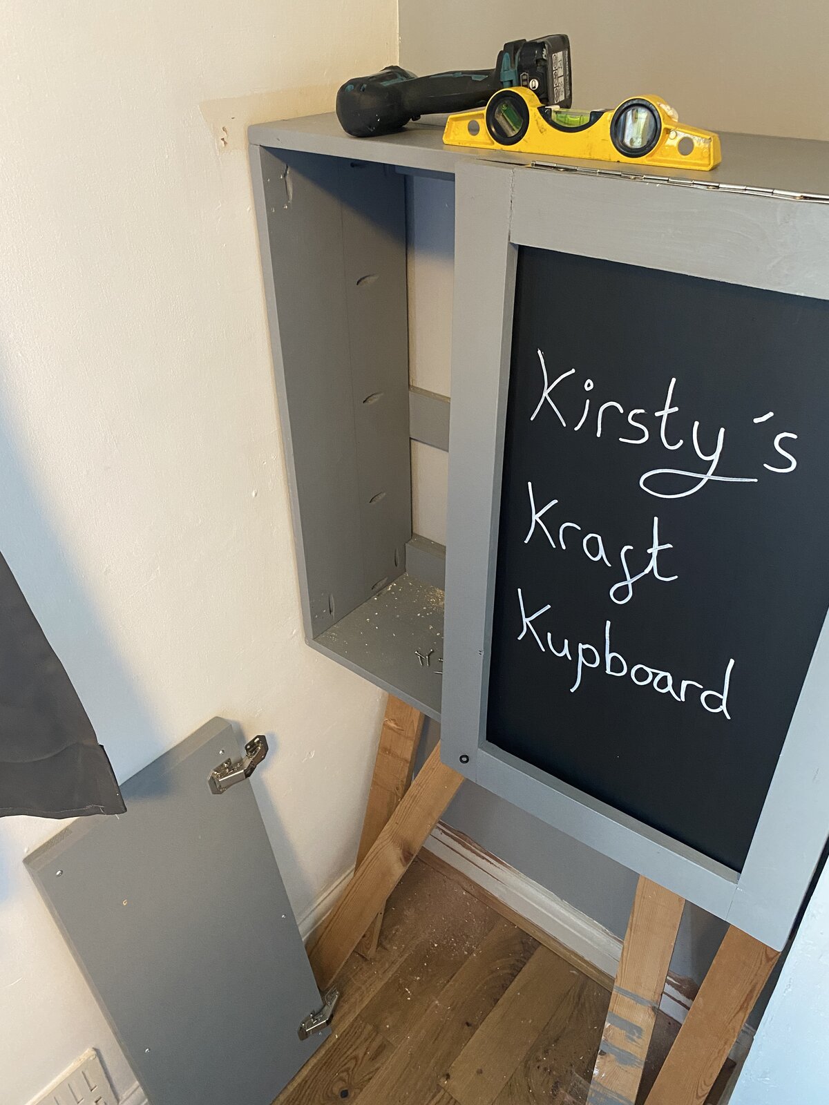

Hi all
I’ve just started out in the world of DIY and have built my wife a sewing cabinet. The right hand door folds downwards to become a table. However the left hand door is an overlay that opens outward. The problem is I haven’t accounted for the thickness of the left hand door (36mm) and it will not open against the wall with the current flush hinges.
Does anyone have any solutions? Are there any hinges out there that, when opened, will bring the door inwards away from the wall? (Picture attached)

Conventional kitchen hinge if there is no handle on door , but you would normally leave the unit 20mm short of the wall .
Door needs to be 2-3mm short of the width either side it closes on to.
