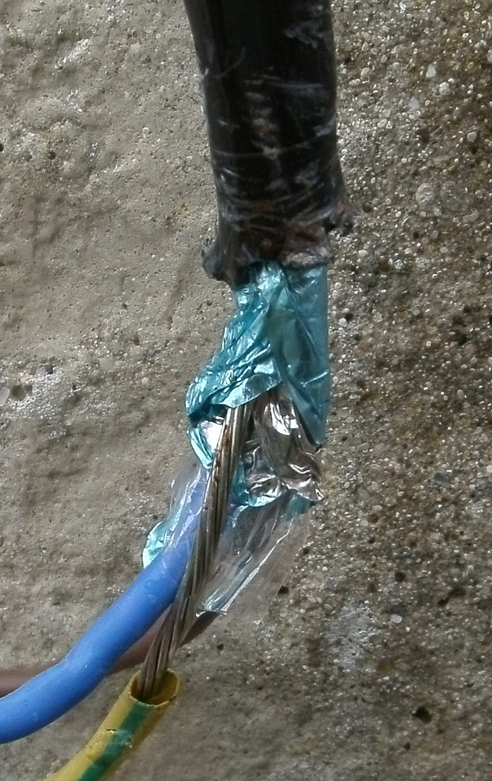

I found the electricians rewiring mothers house about to use twin and earth on a cantenary wire to supply garage from house, I pulled them up on this and what seemed to be a tough black cable was used instead.
This was a twin core and earth with a foil touching the earth screening the cable, at the time I did not question this cable,
was brown, blue with black outer but looks similar to picture.
When the new roof was being fitted to garage the builder was making a hammering sound and with one bang the power went off, tried to reset, but tripped a B32 MCB, a RCD and a 13A fuse, tried to test with multi-meter no fault found, but replacing fuse it ruptured as soon as switched on.
Cable was replaced and all worked, but I felt the builder had done something to cause the problem. New insulation tester arrived, blue shows completely clear, but brown showing around 5 MΩ varying, but cable now disconnected, but still on the catenary wire.
The picture clearly states not suitable for 240 volt. So the big question was the electrical firm responsible for failure or builder? Can't really blame builder if the cable was wrong type and simply failed because of vibration.
I thought it was the cable for the job, but now not so sure, clearly on a canteinary wire cable will flex so neither SWA or T&E are suitable, this cable has around 7 strands in each wire, but not what I would call flex.
I can see no external damage, but since replacing it with flex has cured the problem there is something wrong with it, I have not got step ladders tall enough to cut all cable ties to get it down.
I had expected to find down to earth with insulation tester, but that was not the case. Any ideas as to what cable it is and if rated 240 volt?

OK actually cable. PICT0033a.jpg Could not get a good picture last night. It has an area which is not perfectly round so possible the builder slipped with a hammer, But can hardly charge the builder if the wrong cable to start with.

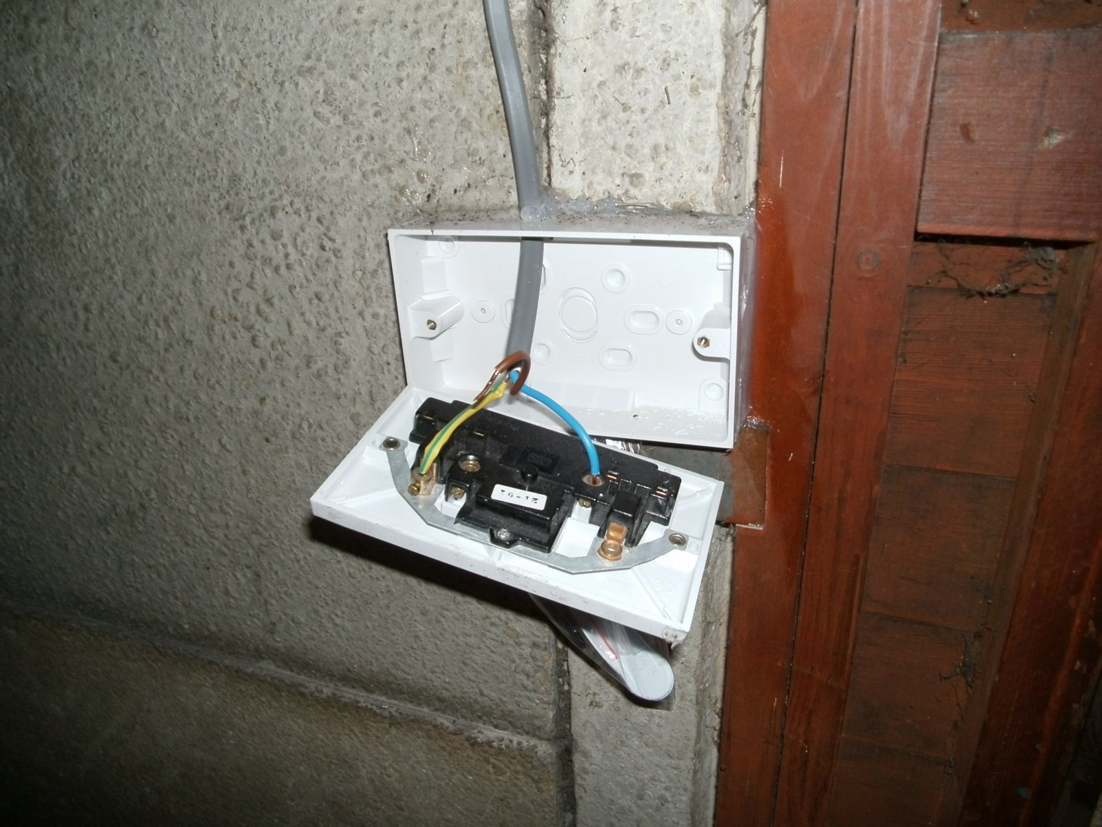

Being fair finished product looks good, however when working outside on my house, (some work on mothers, some on mine and some on father-in-laws) my power also went off, the house 1979 has cables in the cavity wall, and he was doing pointing, if I find he damaged garage cable without admitting it, then I must assume he has also damaged cable in cavity wall without admitting it! I have caught him doing some things which are questionable. PICT0019.JPG This is how I found a socket in the garage after he had left, I was going around trying to find out what had gone wrong, seems he wanted to help, however this socket was no where near where he was working, or myself, so it was not something I would naturally look for.

Although black it seems this is one of the Doncaster cables firesure range. I can see Doncaster cables marked on it and firesure, however the writing is not plain enough to read the part number. However it would seem this cable was suitable for outdoor use, even if not ideal for hanging off a catenary wire. So down to builder to repair or replace not the electrical firm which is the info I needed.
Looks like shielded twisted pair. I use it in vehicles for reducing noise on cam and crank sensor signals. I've never seen this sort of cable used in a mains voltage installation before and I'm struggling to think why you'd want to...! Although the colours do seem to suggest it was intended for this use.
It does look like an FP200 type cable. Are the live conductors insulated with a silicone type material?

With some, e.g. BS8436, it's so that anything penetrating the cable makes contact with an earthed layer first, then if it hits a live conductor the protective device will operate.
What its function is for fire-resistant cables is I don't know. My guess would be mechanical strength.
