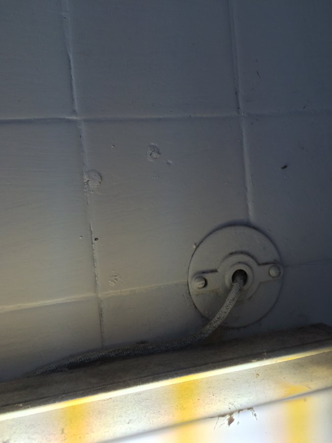

hi
Is this a cloth covered rubber cable in my bathroom and is it dangerous

hard to tell from that picture, i think there used to be heat resisting cable made, that looked similar to that, but at a quess it would have been installed over 40 years ago.

It's for a fluorescent light on the wall it has probably been there since the 50s it's used every day, I was just a bit concerned as I have never seen above the light before and I don't want it to fail and give someone an electric shock, will all the power cables in the house be like that?
1950s will almost certainly be rubber insulated wiring, which is well past the end of it's expected lifespan.
Suggest that you have the whole installation inspected.

I doubt that it is immediately dangerous; it doesn't seem to be damaged. Especially if it is out-of-reach. But you should consider getting an electrician to do a condition report on the whole house, and to advise on what needs urgent or not-so-urgent attention.
i dont think its rubber coated, them days there was a flex with a sort of criss cross braided outer coating made of a material, though I dont think it was asbestos, but had similar heat properties, I have seen it on imersions and heaters, it was maybe used in your case due to the heat of the lights internal control gear.
That outer is still used on e.g. irons. I suspect that the same outer has been used over various different inner insulation materials over the years.
Possibly, though the stuff I mean is more robust than the stuff on irons, the cable was white and I think was genarally used them days before being replaced with 80 degree Butyl rubber flex.
