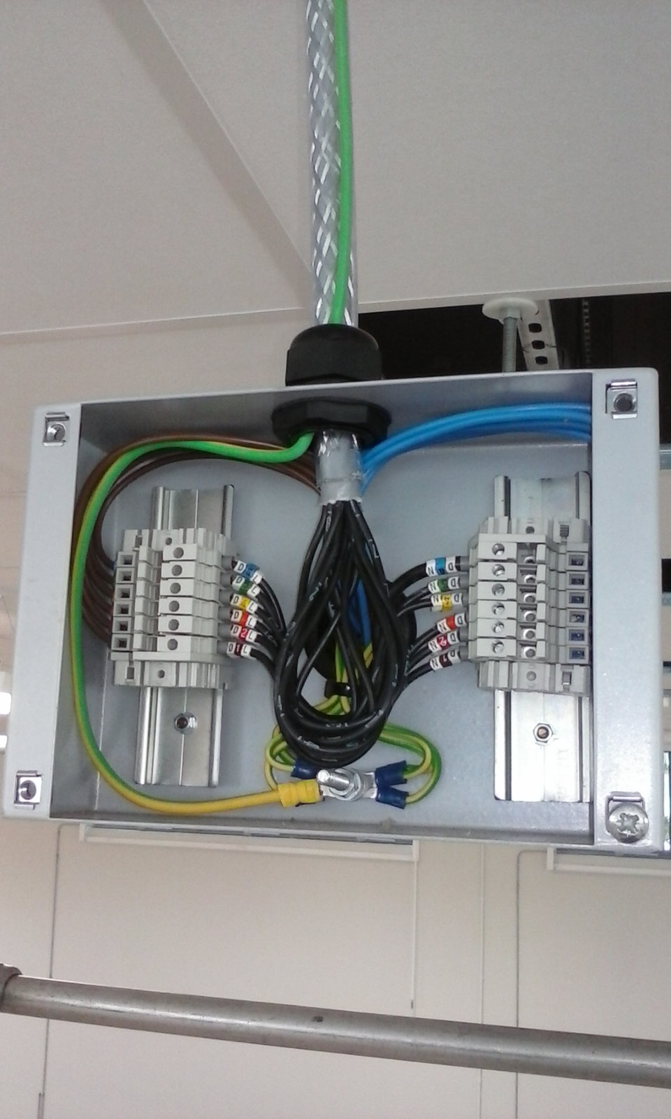

Far more intuitive to read away from or towards the end of the wire across the board and its far easier to load a whole series of numbers on the needle all the same way round and prep the wires before placing into the panel.
I frequenty find where mods have happened and wires are moved from the top of a device to the bottom and suddenly the panel is higglety pigglety and with the best will in the world it is a time consuming exercise to keep turning markings round and liable to errors.

That's all very reasonable, but it's only really applicable in cases (like Sunray's pic) when the conductors/wires are horizontal.
If, as in single phase CUs (and other things found in domestic and some commercial installations), most of the conductors/wires are vertical then, if standard cable markers are used, if you work on such installations you presumably have to try to learn to "turn text around in your head" without making too many mistakes!

Oh do you mean just like in RF's picture??;)
With all ribbing/joviality aside I'd make the statement that the majority of the time I'll read the colours and not the text and having them in different formats can and very much does cause mistakes to be made. All reading from or to the end of the wire is the most reliable, easiest and by far the quickest to install and read.
The thought of making a common line (eg 0V or control circuit) with hundreds of connexions and have to think about which way a number goes on makes me shudder. There are so many more important things to fill a wiremans head.

CEGB standard is for all numbering to read away from the terminal, regardless of what that does to orientation, or your neck.
That's an old standard of course.

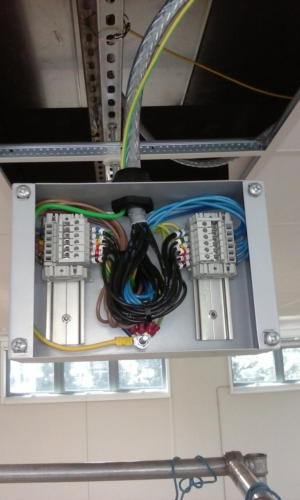

Beautiful wiring RF and Sunray. Both of you must have very tiny hands.
Tiny doesn't describe me at all, 9" span.
I have to say that mine is not one of my proudest jobs. I had very limited scaff tower time to run the SY cables and earths, terminate them, replace ceiling tiles and box lids and test. Accordingly it was pre-prepared and put in quickly.
Thanks for the compliment but I have to say that is not one of my proudest jobs. I had very limited scaff tower time to run the SY cables and earths, terminate them, replace ceiling tiles and box lids and test. Accordingly it was pre-prepared and put in quickly.
