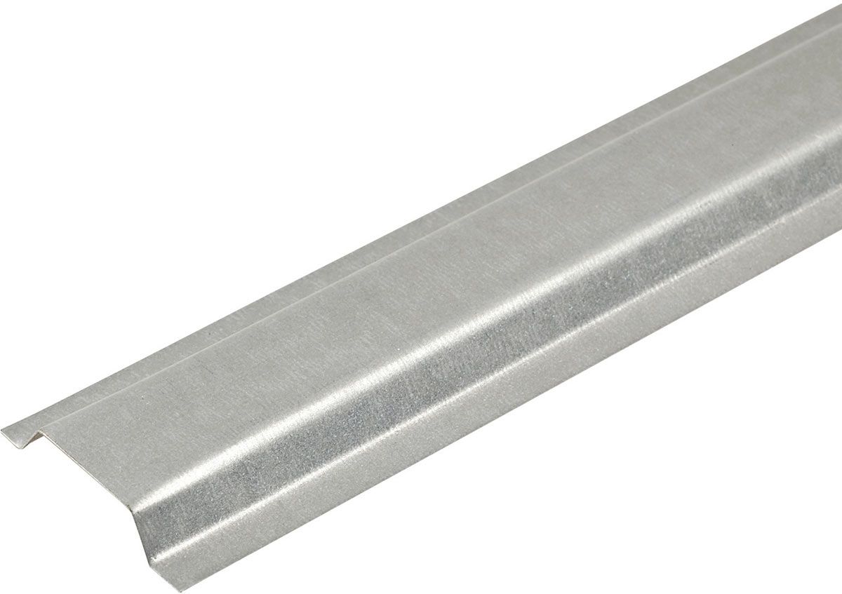

Can I run 3 x ethernet cables for Firestick , TV ect and 2 x ethernet cables for CCTV in the same Metal Cable Sheathing ….Would this cause any problems?
Cheers...
Its always advisable where poss to segregate all data cable from any others to refrain from interference. I would put a plastic conduit in if able to make it easy to change should any problems occur
As long as they are Cat6 cables , you will have no problem. What you must not do is run a mains cable in the same conduit.
