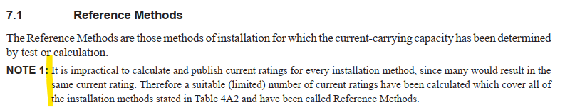

There is this:
Goodness knows where that leaves us.
