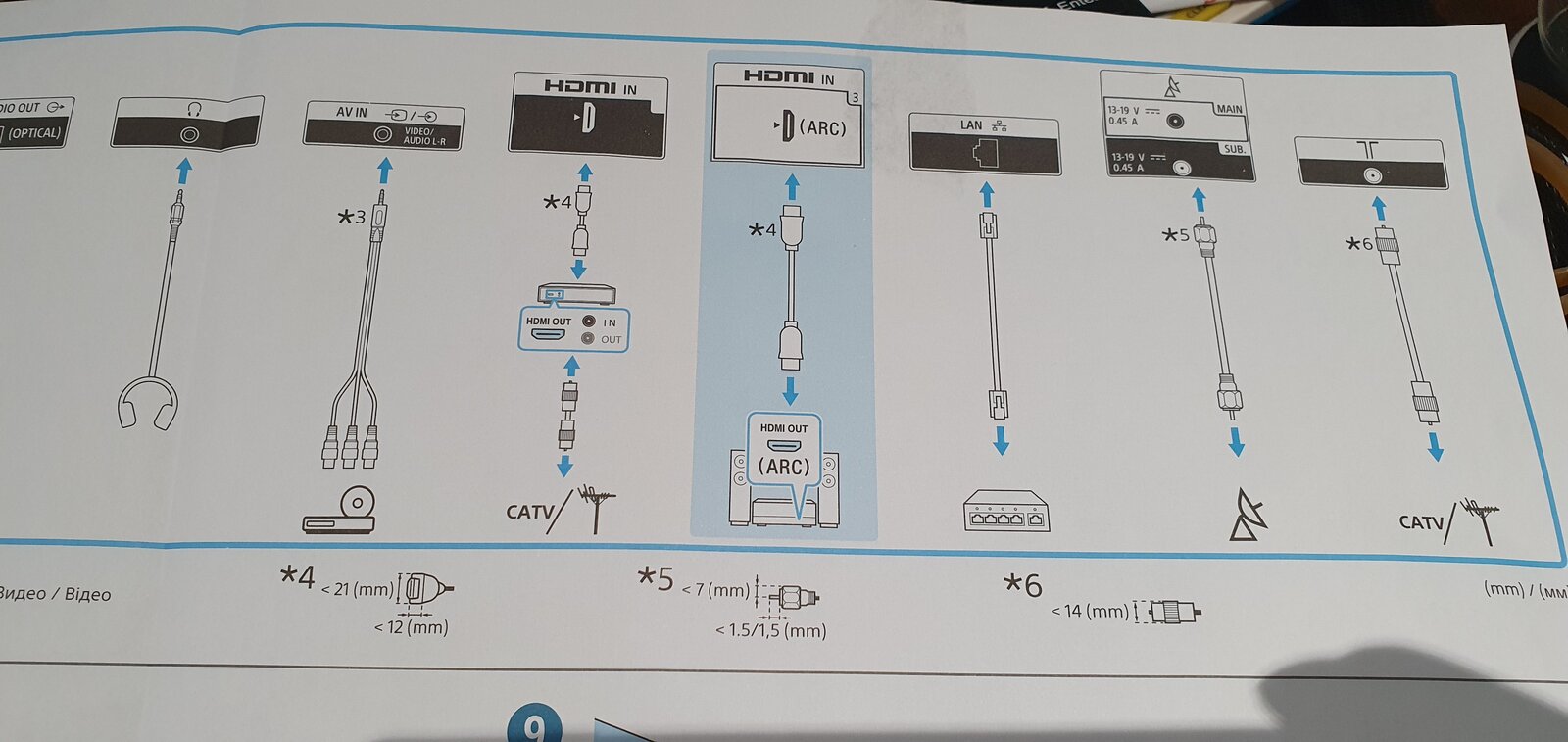

Hi there,
So I have just bought a new TV which arrived today and I have an appointment booked in with a mounting company to mount and chase my cables through the wall next Friday.
So I am wanting to prepare all cables that I will need to chase through the wall, to save me the hassle of trying to chase it through myself afterwards.
So I I had ordered last week HDMIs, USB/USBC, Aux, optical, Ethernet the usual. I thought I had it all prepared.
When the TV arrived today, I pulled out the user manual and I have attached the picture.
The end two cables I don't seem to have.
I believe the last one is the Coaxial Satellite cable, to watch live TV, am I right? Is this a necessary thing in 2020? Shall I also buy this to chase through?
And I am not sure what the penultimate one is. Is it some kind of Coaxial audio? But it has a picture of a satellite at the bottom? Do I need this too?

How do you plan to watch normal TV?
SKY box (for SkY) or TV Aerial (for Free view) or Satellite Dish (for FreeSat if your TV has an internal decoder)?
The last two cables and connections in your image are coaxial cables (with different ends) to connect your TV directly to a satellite dish or to your TV Aerial.

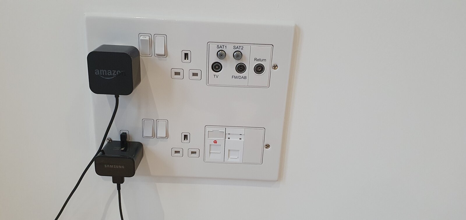

Hi there,
So I normally don't watch live TV, I only watch Netflix. But I still want to future proof. So you are saying, if I have a sky box then I will need these both?
So I have attached a picture of the outlets below my TV.
So how does the connection work? TV > Coax cable > Sky box > Coax Cable > Wall outlet?
I'm so dense when it comes to TV as I don't watch TV.
Okay, so if I buy an F connector, and a Coaxial Satellite then I should have everything,

Looking at that panel it looks as if your house has both a Sat Dish and a TV Aerial.
[for the following text I always follow the direction of the signal (or TV picture) from left to right].
Regarding you normally watching SKY, the cable connection is:
WallOutlet/Sat1/Sat2 > F Connector Coax > Sky box > HDMI Cable > TV
So you are OK there as you already have HDMI in the wall.
(This is shown in the 3rd image on your instructions).
But for normal FreeView use you want:
WallOutlet/TV > TV cable Coax > TV
(This is shown in the 7th image on your instructions).
So you also need "TV Coax Aerial lead" in the wall (for FreeView):
https://www.amazon.co.uk/s?k=TV+Coax+Aerial+Cable&ref=nb_sb_noss_2
I would also add another HDMI cable in case first breaks or you add another decoder box (Say Bluray player) or you wish to use an amplifier or sound bar (using ARC).

Thank you I see.
So that means the F Connector doesn't need to actually connect directly to the TV (like in the manual) because it is already in-built in my flat? That means I don't need to chase the F connector through right?
So if I didn't have that F-Connector bit in my wall, it would have to go:
TV > F connector > Sky Box or something like that?
So I will buy both, but only chase the TV Satellite Coax cable through.
Thank you for your help!
EDIT: Also, yes, I am chasing about 3 or 4 HDMIs through haha!
Not quite....
You do not need the F connector cable all the way to the TV because you are using the SKY box to convert the Satellite/SKY signals into the HDMI cable which goes to your TV.
(This is shown in the Third image on your instructions)
But it looks as if your TV has a basic Satellite decoder built in it (it will not decode the SKY channels, only the FreeSat channels).
So IF you did not have a SKY box, you could run a F connector cable all the way from the Wall connection to the TV, and let the TV decode it so you could see FreeSat channels (but not SKY channels).
(This is shown in the 6th image on your instructions)
But most TVs do not have a satellite decoder built in, so this cable much less useful.
So in summary I would defiantly fit a TV coax cable.
And be less worried about a Satellite F type coax cable.

Sorry just one more question:
I am about to buy this cable:
https://www.amazon.co.uk/Long-Aeria...37690102&ref_=sbx_be_s_sparkle_td_asin_0&th=1
So it looks to be Male to Male. However on the Wall outlet picture I atatched above, the "TV" port seems to be Male. Does this mean I need a Male to Female cable instead?
The "FM/DAB" port look female, but I guess that's radio right, and the "Return" one? Can I use the "Return" port? Or shall I just buy Male to Female,
Thanks, last question :p
