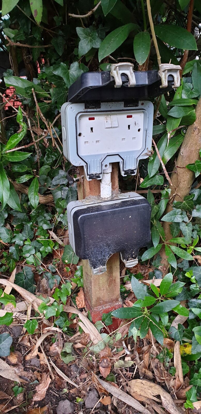

Hello, I have an outside double power socket about 50 feet from my house, in my back garden. Been there since we moved in 5 years ago. No trouble. Handy for plugging the mower into. I want to put a flagged path in the area where, I think, the underground power cable is routed to the outside double socket. I don't want to cover the power cable route with flags, just in case. I've got some flexibility with the location of the path but want to find out where the power cable comes from/to. I have seen cable locators but they are expensive, even to hire. Who could I contact to have them come out with their cable locator to run it over the ground to tell me where the cable is routed ? I had a replacement plastic water feed put in at the front of the house to replace the old lead pipe and they used such a cable locator to check where pipes and cables were before they started. Took him about 10 minutes to do the check, so I am thinking the same or less to find the power cables in the back garden. The kind of thing, I am thinking, that someone who uses such equipment in their profession can do on their way home from a proper job with a minimal charge to me. Unless, of course, apart from digging the garden up, there is another way to find out. Thanks for any advice on this.
Hello, I can't see the cable as it is inside, what looks like, 25mm plastic trunking fixed to and behind the mounting post on which the socket units are mounted and I assume that the cable must go through the post to the socket units. Can't upload the picture (via Upload a file) as I keep getting an error message. Tried copy/paste to the page, also, but got the same error message.

resized it :)

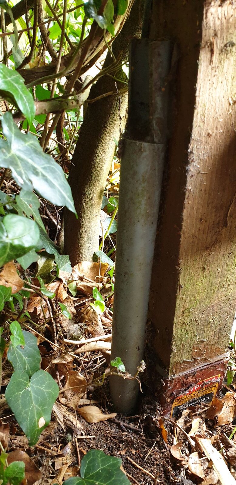

TTC, Please see the attached photo. Not a good one as the wooden post that the sockets are mounted on backs up to well established bushes, but the mystery grey pipe is visible. Where the top of the pipe is cut in half lengthways, the open end has been plugged.

Thanks. Still inconclusive as to cable type but I expect it’s ordinary PVC run in some sort of plumbers Pipey thing.
You’ll be ok as above, power off. I’d worry if you were using a mechanical digger, but the pipe should give adequate protection for medium spadework.
Sequence: power off, Groundworks prep,
Restore power and check it all still works before you put the slabs down!

If you want to see what type of cable MAY have been used then;
1 Power off.
2 Remove both socket fronts but do not disconnect.
3 Have a look at the cabled entering the sockets. If you can see flat grey sheath then, in all likelihood, they have used standard house wiring cable. Just hope it is in conduit all the way under the ground and not just at each end. No sheath showing then it may have been cut back into the conduit or it may be singles, (usually stranded and can be checked by looking at the connection into the socket), which will (99%) be in continuous conduit. Alternatively it could be SWA with the sheathing cut back also.
4 Replace socket fronts and power up.
You could try running a length of string between the lamp and the socket post then digging 2 or 3 test holes to see if you can find the cable but you may have to dig quite deep if it has been buried correctly.
Or just do as TTC suggests in #12
