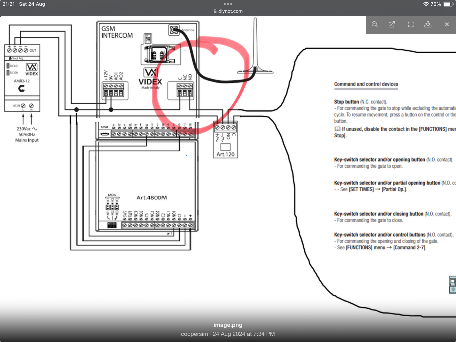

Struggling a bit with this
If I short 2&3 on the came controller the gates open however entering the code on the Videx nothing happens.
Relay time set to 2 seconds
What am I missing?

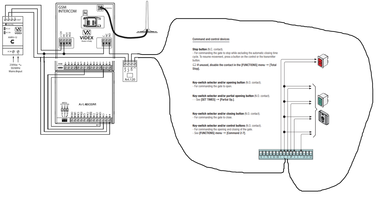

Relay plus a relay ….just wire direct to the videx gsm unit …

What is the actual model number of this unit? ….you do know they have started to switch off the 3G network ….
It’s possibly GSM4KCR
It’ll work on 2g until they deprecate that network too.
The relay came with the kit and has worked previously on a ‘nice’ system
All gate operators will have a common zero volt terminal that shorts to either open ( normally open ) or stop normally closed , not sure why the videx will use the opto relay , maybe it’s because some gate operators voltage is over 24v …is the relay working ok when you operate it ?
