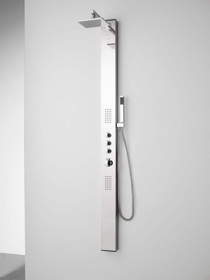

Are you planning on installing the shower column on the middle column?
No, I was just planning to use the column as a corner - like this but with a 'column' in the corner.. the only things I can find between two 'walls' are doors not panels
