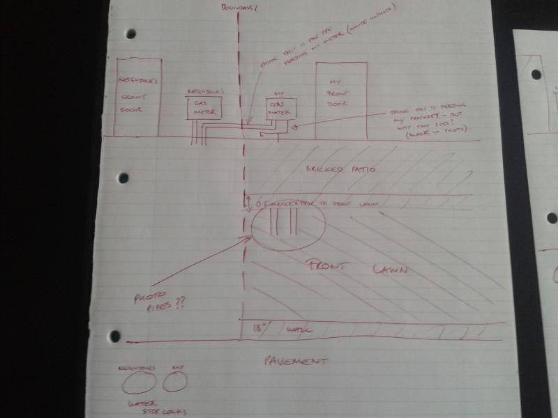

Hi, I was recently digging in my front garden and discovered these pipes an inch under the top of my lawn.
Near the front of the house they disappear under a front patio so I can't see where they go or what the service, but my gas meter is in close proximity so could they be gas pipes?
They're buried in the lawn (which is 4 metres long) and go off away from the house towards the pavement (I can't actually see them from the pavement which is about a 18" below the level of my front lawn - so the pipes disappear to below this level in about 4 metres) - assuming they've not been cut and just terminate under my lawn somewhere?
Also, why are there two of them? They look identical and even though they're in 'my' land, they are very close to the boundary with my neighbour (could one be their gas/water pipe?).
Can anybody identify them from the photo?
Are they more likely to be gas/water is there anyway of knowing if they're live (without digging into them!).

The obvious thing to do is look at where any services rise in your property, then look at say the road stop-cock and see if any of them line up.
They look like old metal water service pipes although they could also be old iron gas service pipes.
I doubt that they are anything to do with electric.
Iron gas service pipes are very robust and are joined every 2 or 3 metres with a union. All connections are made with threaded joints and denso tape.
Steel water service is a lot more fragile especially if it has been in the ground a while and will not take kindly to you knocking it about - so dig carefully.

My gas service meter is indeed directly in line with the pipes shown in this photo, however, the pipe actually feeding my meter comes at a right angle to the meter from my neighbour's land?! (see attached photo - white pipe in photo). I have no idea where my gas 'stock cock'/mains/junction box is - nothing obvious on the road.
I have no idea where my water comes in from, but the stop cock on the pavement is in front of my neighbour's property rather than my own property (see photo) - and the exposed pipes are not in line with the stop cock.
Hopefully, you can make out my annotations!
Good to know about the different types of pipes and metal used. Suppose I'll have to dig them out and see if there are any unions/connections. (If it is water, I can't believe it's survived years of being so close to the surface and not freezing/bursting).
Just a random thought but if you have a multi meter you could always check the resistance between these pipes and your internal gas/water pipes.
Obviously if there's little or no resistance you know what they are.
If there's a high resistance that wouldn't disprove they're gas/water pipes though.
