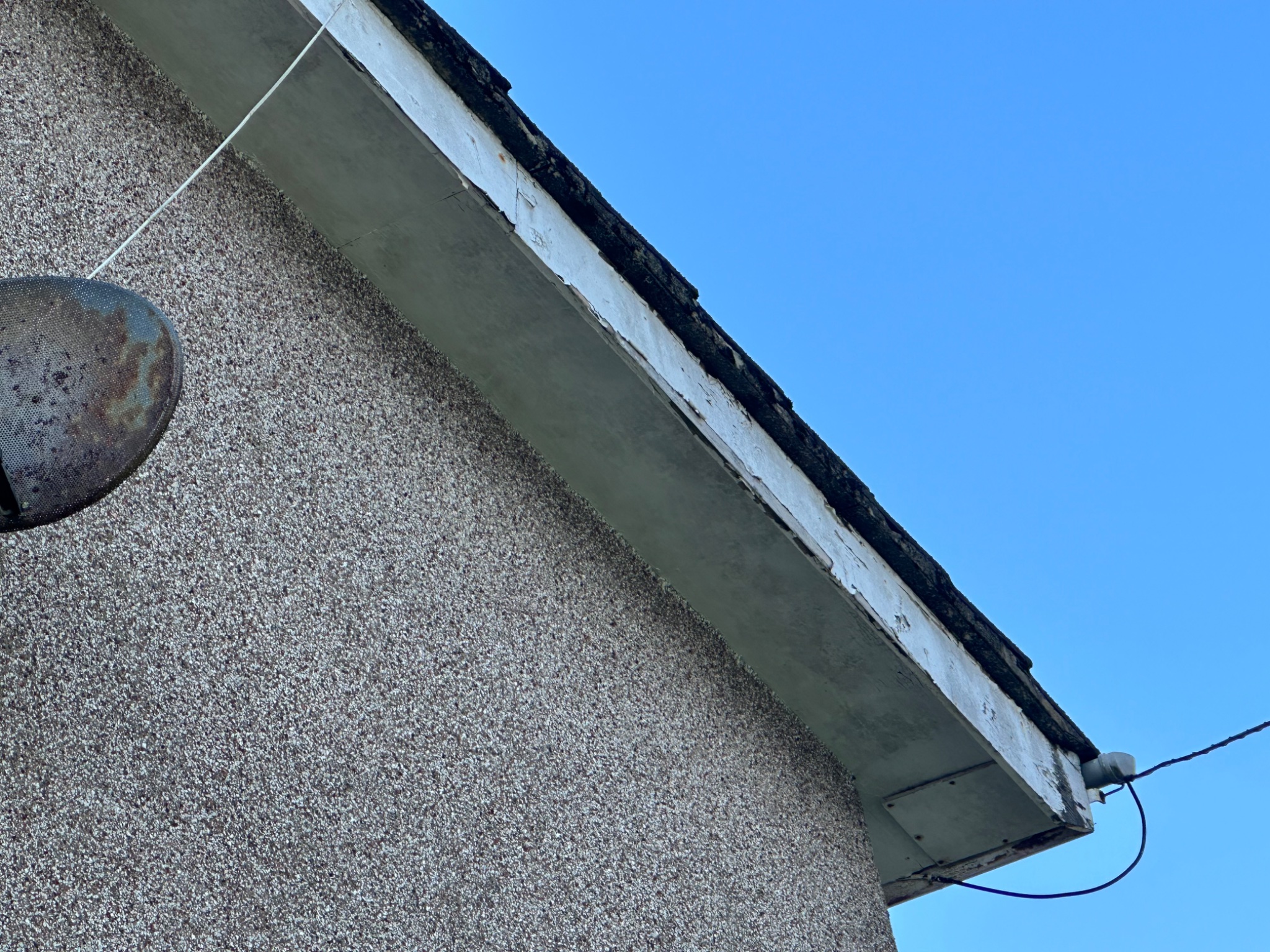

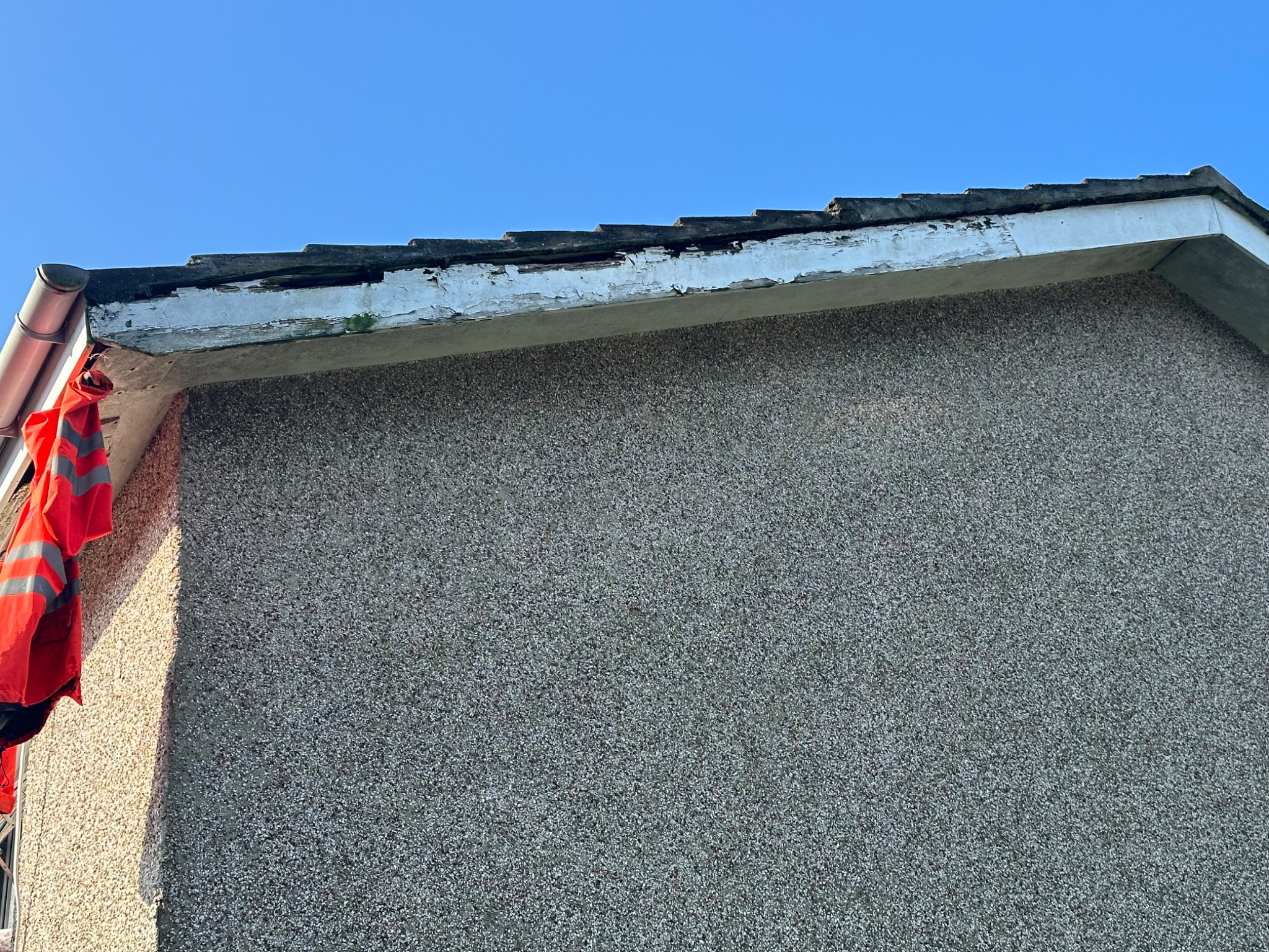

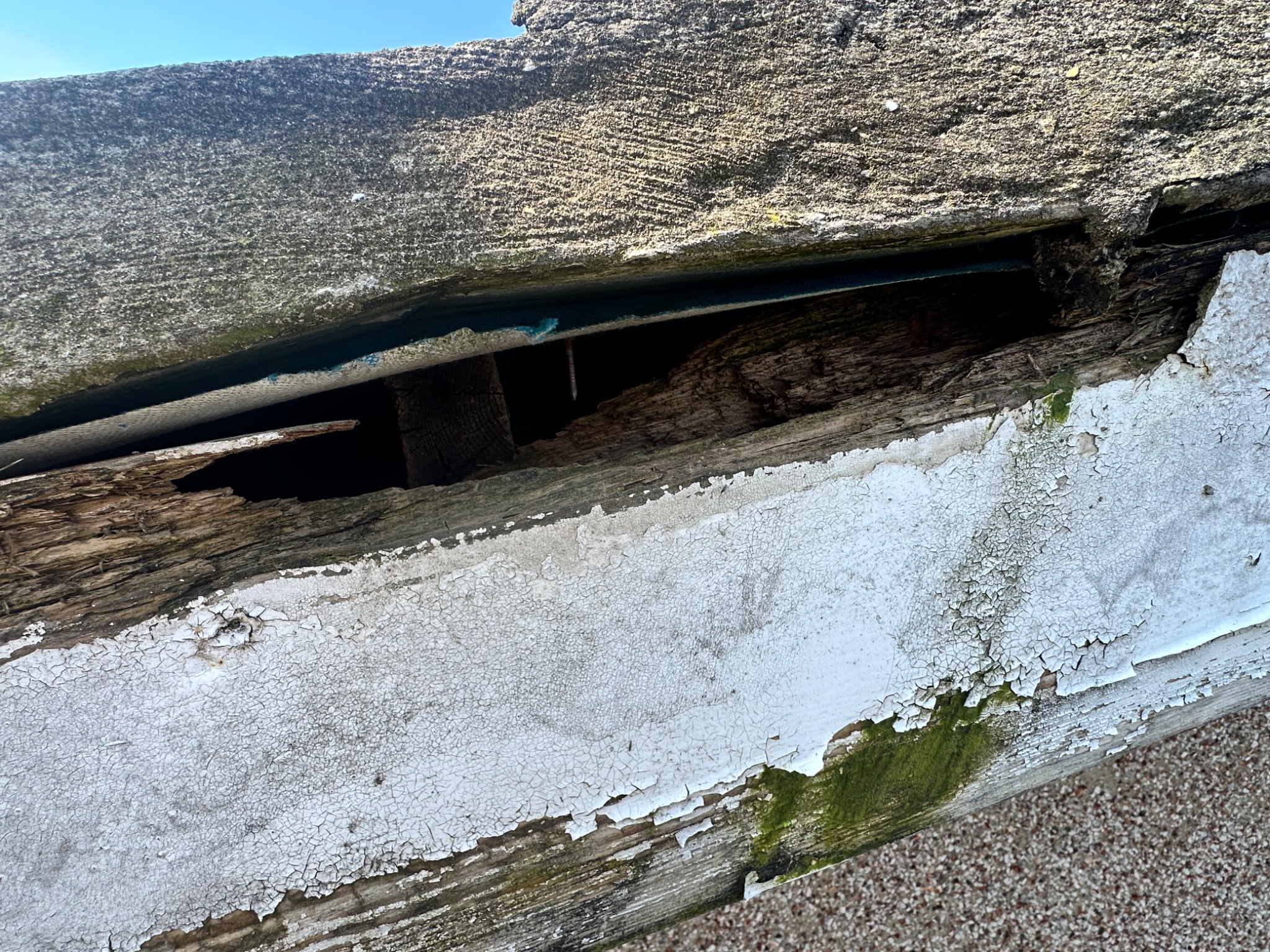

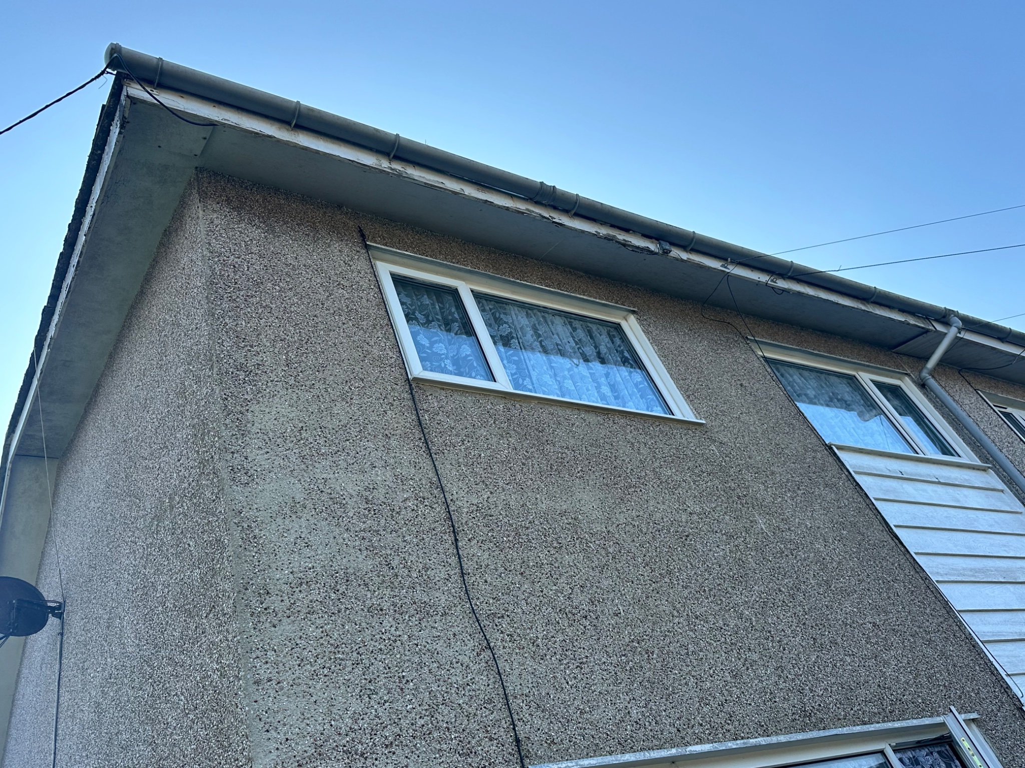

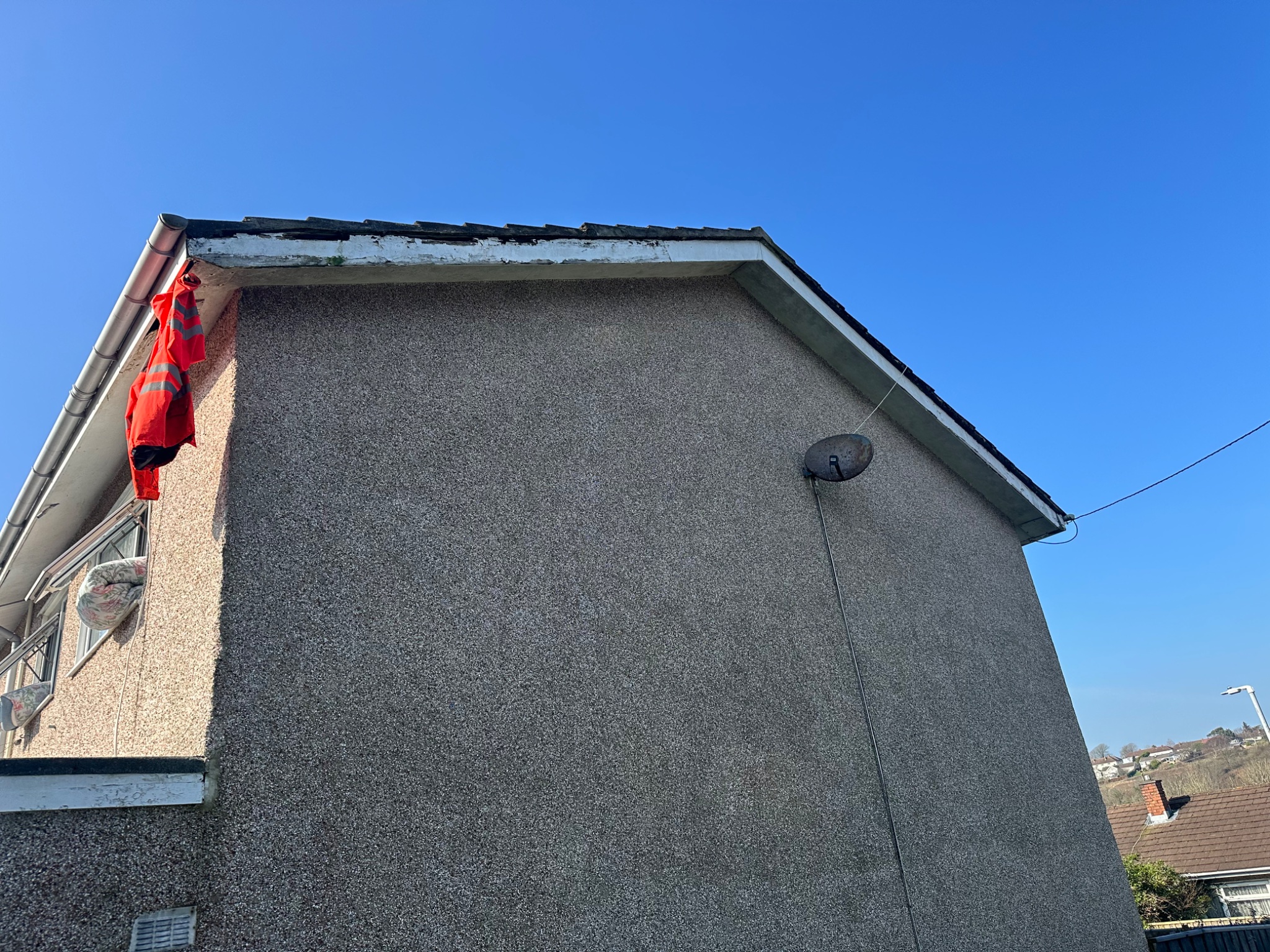

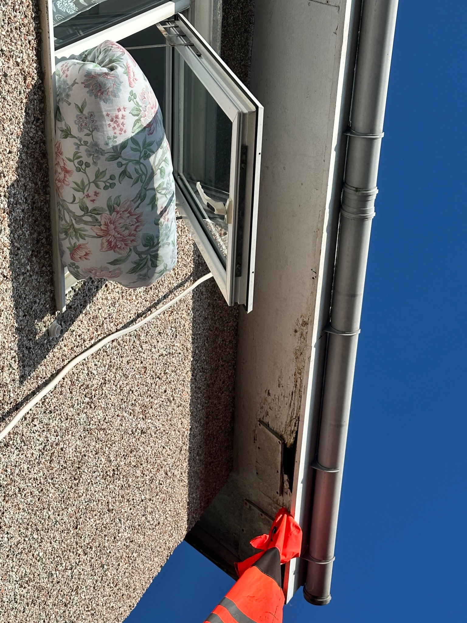

Can anyone tell me if this is usual finishing to Fascia/soffit/guttering replacement

1. Guttering fall/drop is incorrect and water is not draining correctly.
2. Downpipes have not been fitted with an end elbow
3. Rotten fascia boards appear to have been capped rather than removed and replaced.
Sorry I didn't realise the old rotten fascia board had been capped over, that is never a good idea, unless the board is in perfect condition. 3
The 'elbow' is called a shoe. 2
Item you missed, is the U channel, has not been fitted along the wall, into which the soffit wall end slots, to give it support. At the moment it looks as if the soffit, has just been wedged roughly in place, hence why it's all over the place. Likely, when the wind blows, the lot will blow down.

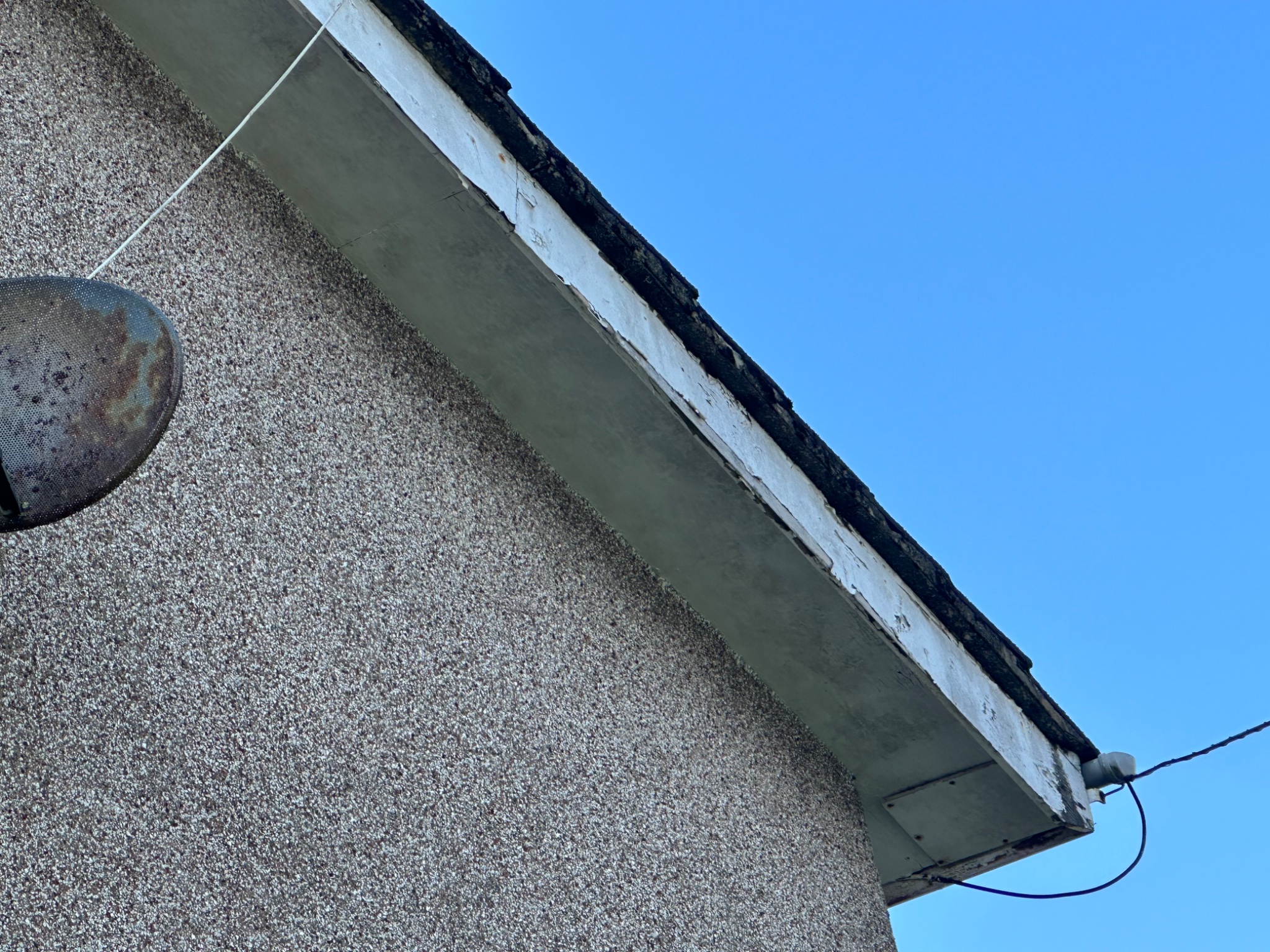

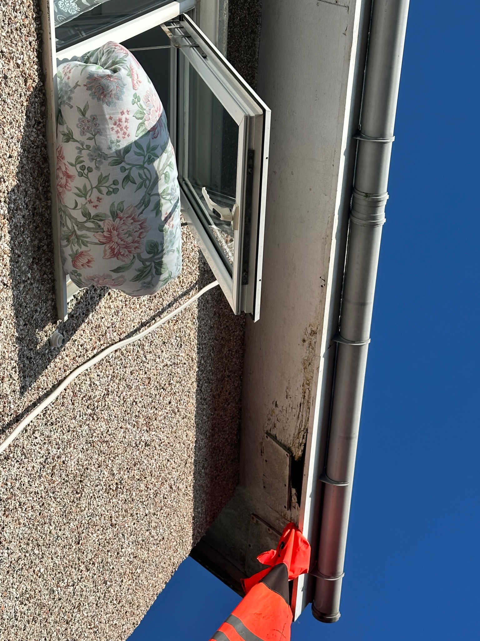

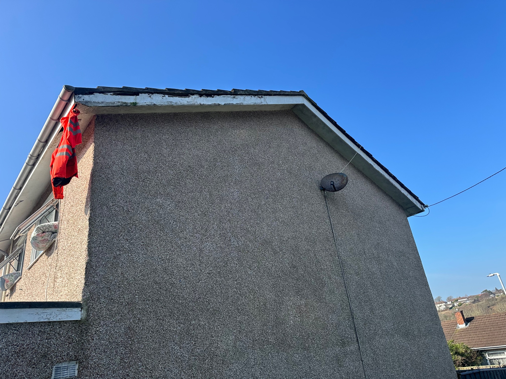

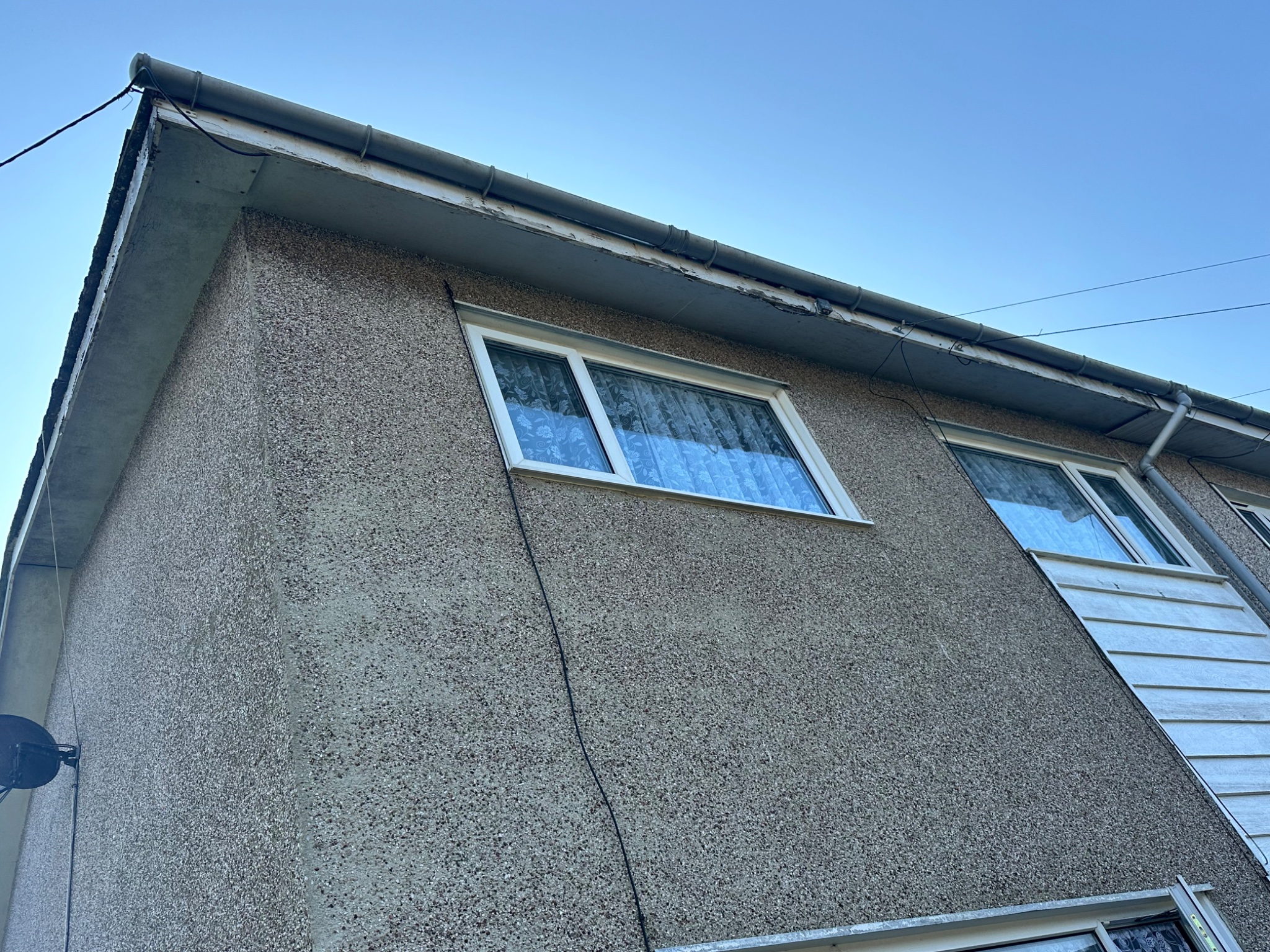

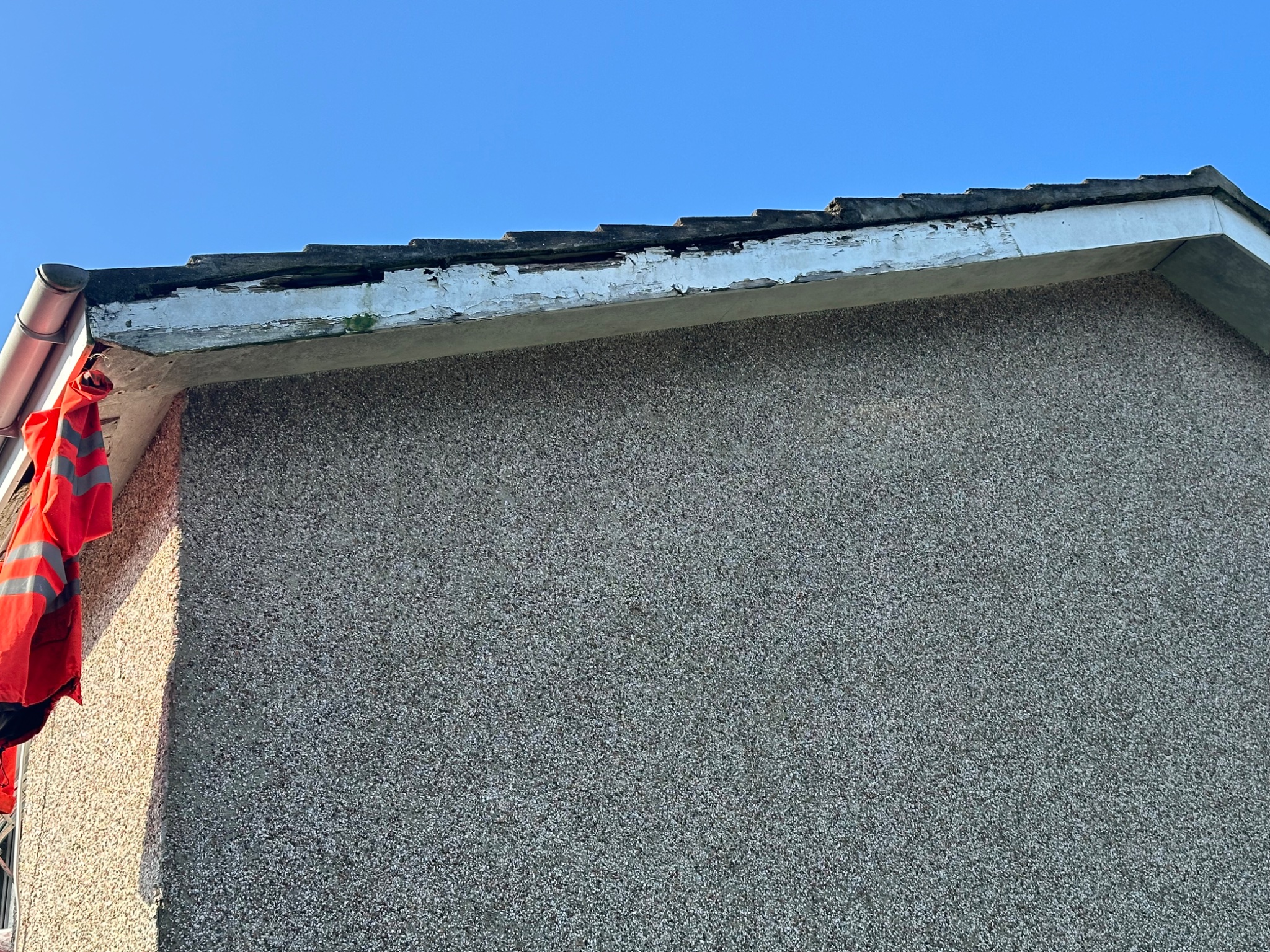

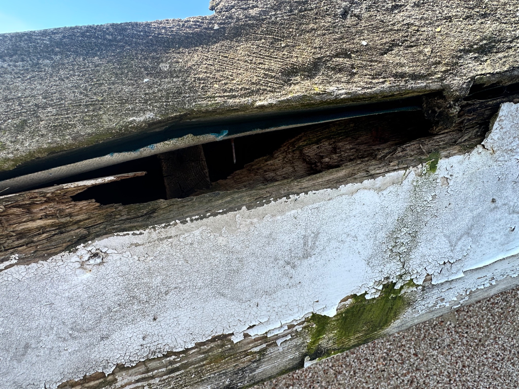

Here’s some before pictures for any debate ongoing about rotten boards and soffit vents

I would likewise have little confidence in his ability, having seen your photos. I am rather surprised you have been able to contact him, and have him agree to return at all. Usually these people just take the money and run. I must admit, I hadn't realised originally, he had done the edge of the roof too, up to the apex.
