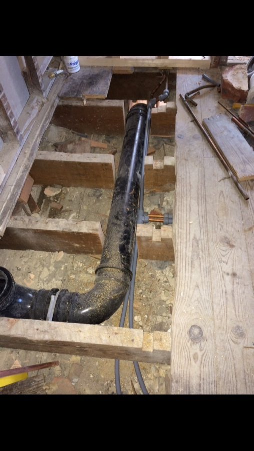

Can cable share the same notch as copper central heating pipes?

In regards to the joist you would have to sister it with ones the same size, glue clamp and bolt them. Then run that waste pipe above the floor and box it in.
