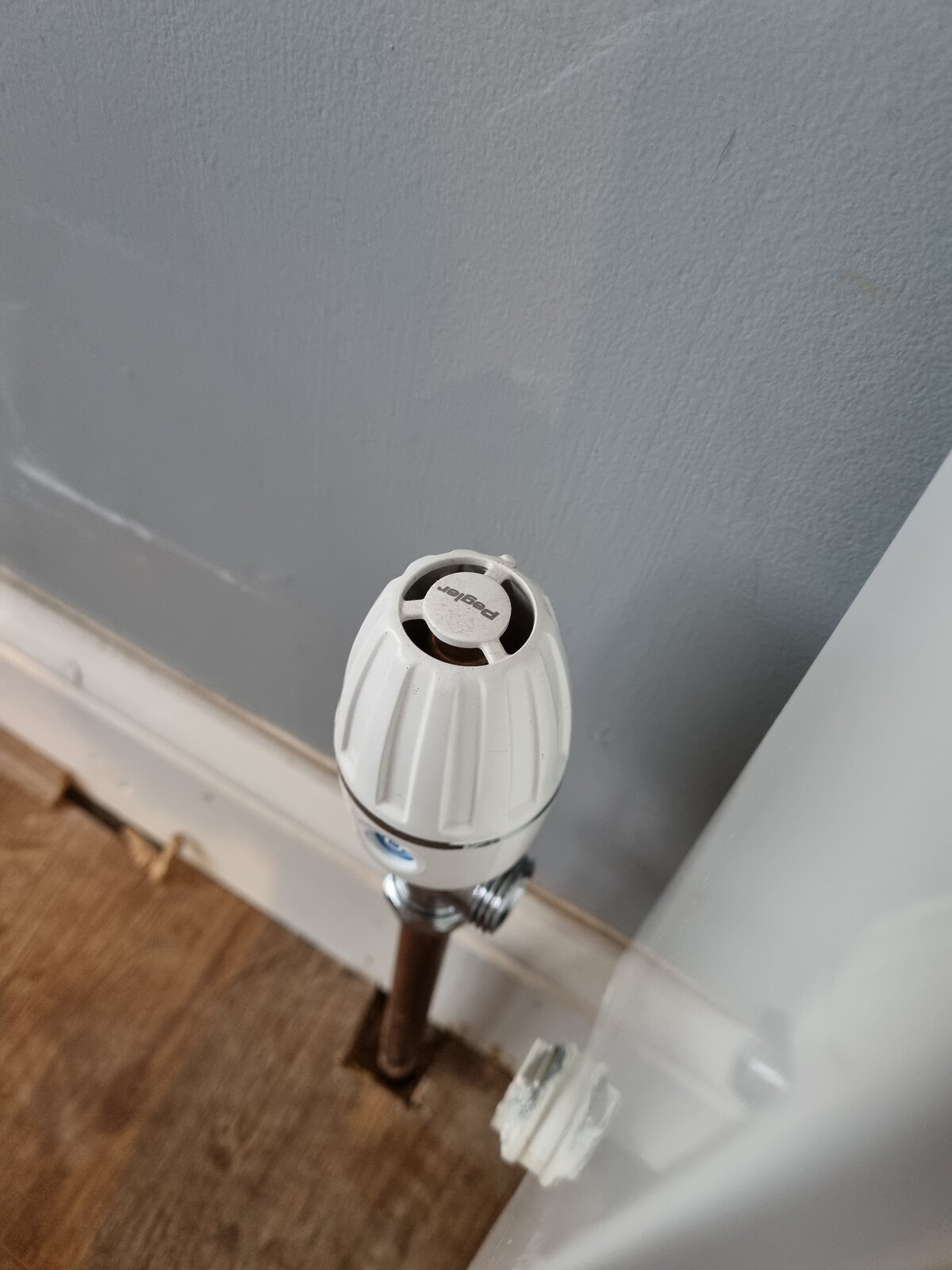

Hello All
Swapping a rad out for a double due to size of toom and pipes are set back sbit
Can I just bend these or am I going to cause issues
Was hoping pipes would of been in a similar place

Not much play in pipes.they move up and down abit but restricted by floorboard below on front to back movement
You'd have to be king kong to bend that to where it needs to go.
You would also snap the pipe and not have enough length by the looks of it.
Extend the pipe above the floor (will look crap)
Best - lift the boards and extend from there.
If you try and bend it that much without a spring in it you'll kink it for sure and maybe snap it. Can't see how much height difference there is, if the valve is too low then you're out of luck- you'd have to drop the rad a bit to match the pipe.
Lifting floorboards will be dull cos you'll have to lift the laminate first.
Me I'd use a pipe bender to make a couple of offsets, drain down, cut a bit of the pipe upstands off, solder offsets on, cut to length, done. But you'll need a pipe bender, blowtorch, tube cutter, solder, flux etc etc. Still probably cheaper than paying someone to do it if you fancied a challenge :)

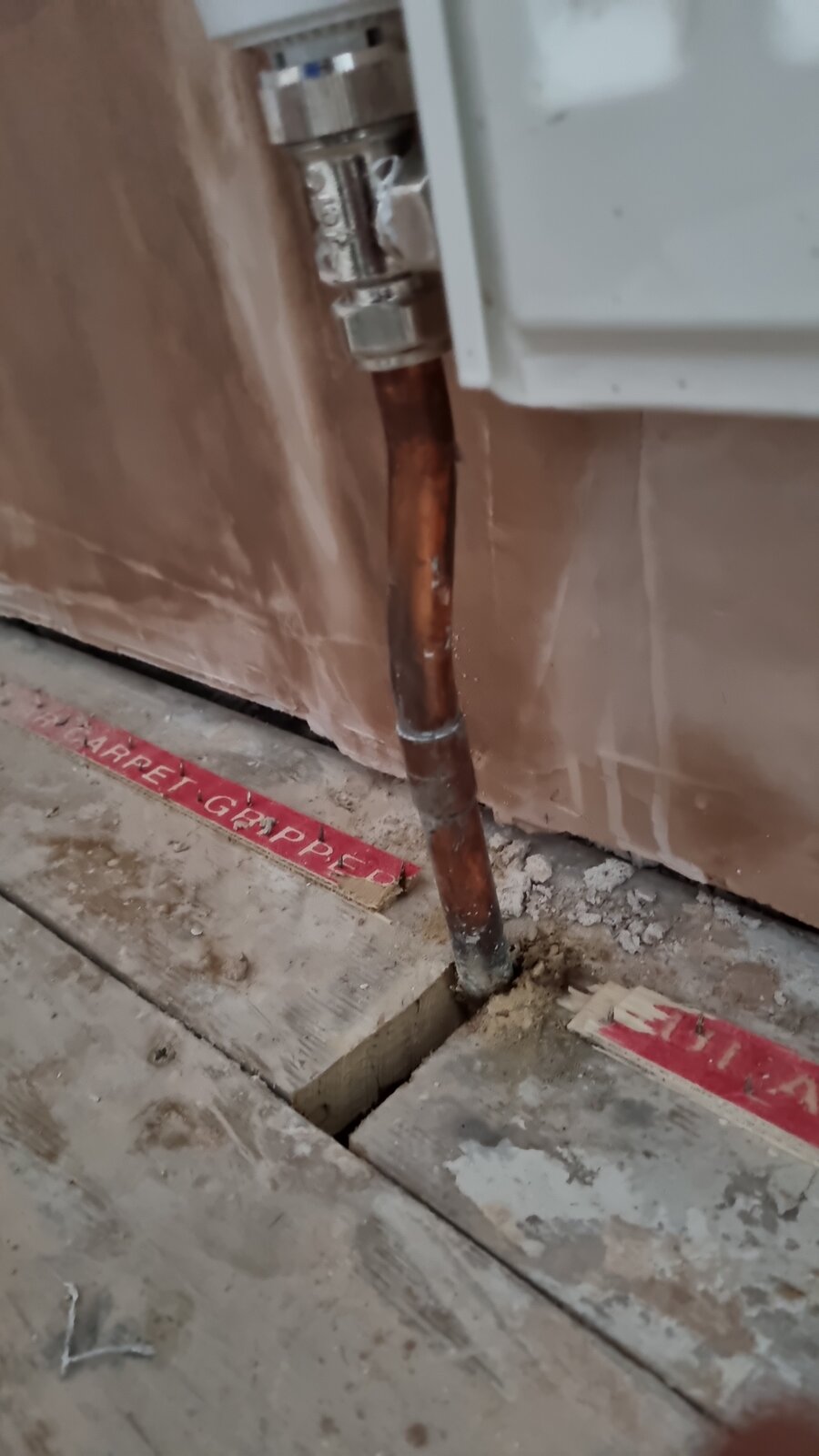

Cheers, had similar done in another room a while back so will get someone to solder above laminate
Had similar last time bit opposite way
Does the pipe feel quite loose in the floor moving in and out within the space that's cut into the floorboard as it is? If so you may be able to drill/cut out the floorboard more and the pipe may move outwards towards the centre of the rad.
All depends how much play is in the pipe under the floor and where the pipe is coming from of course.
