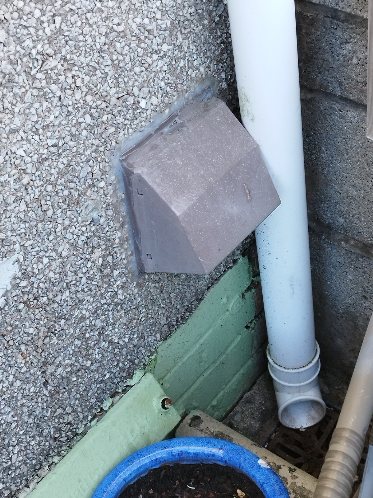

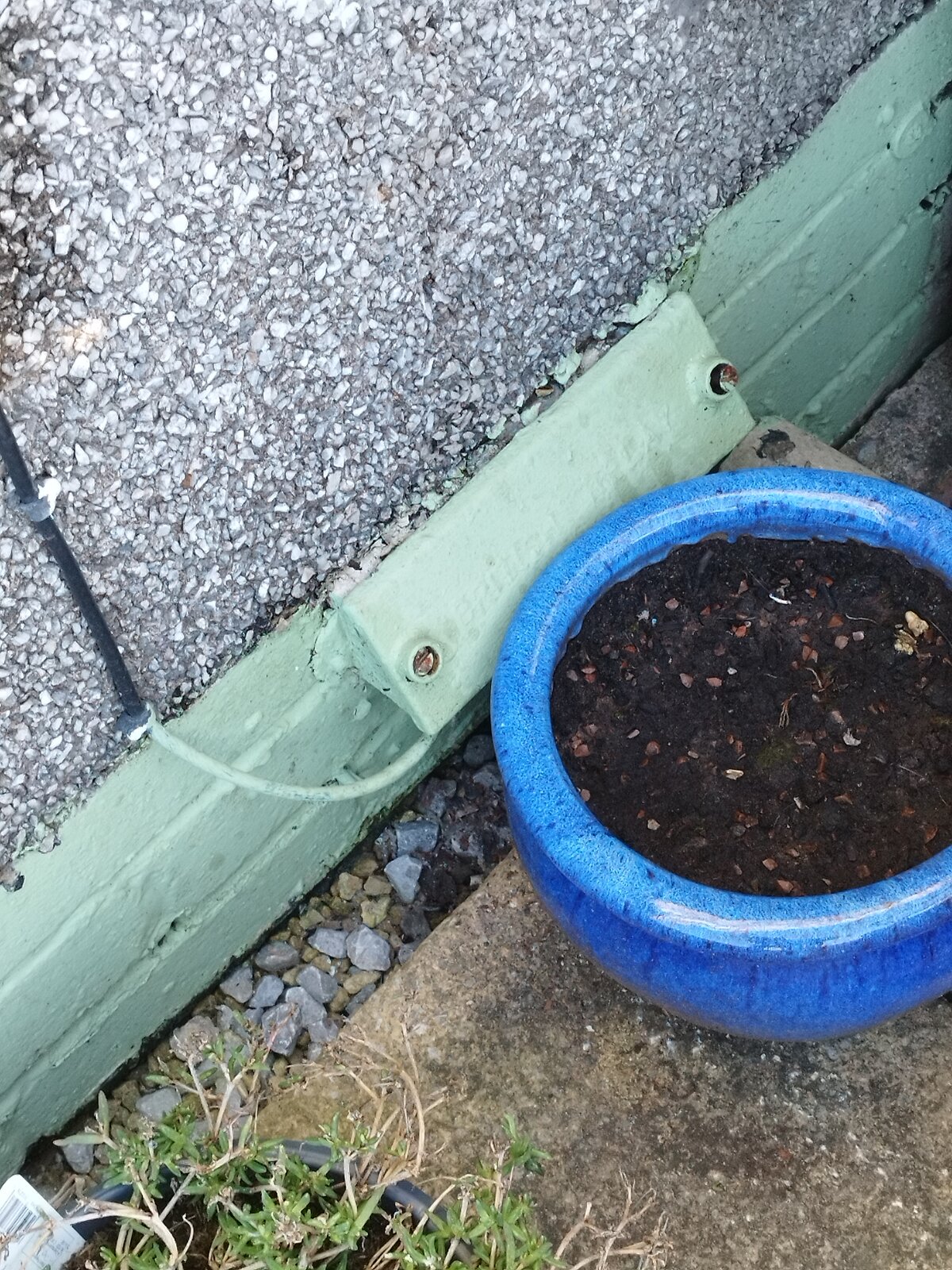

Afternoon guys, looking for more advice please.

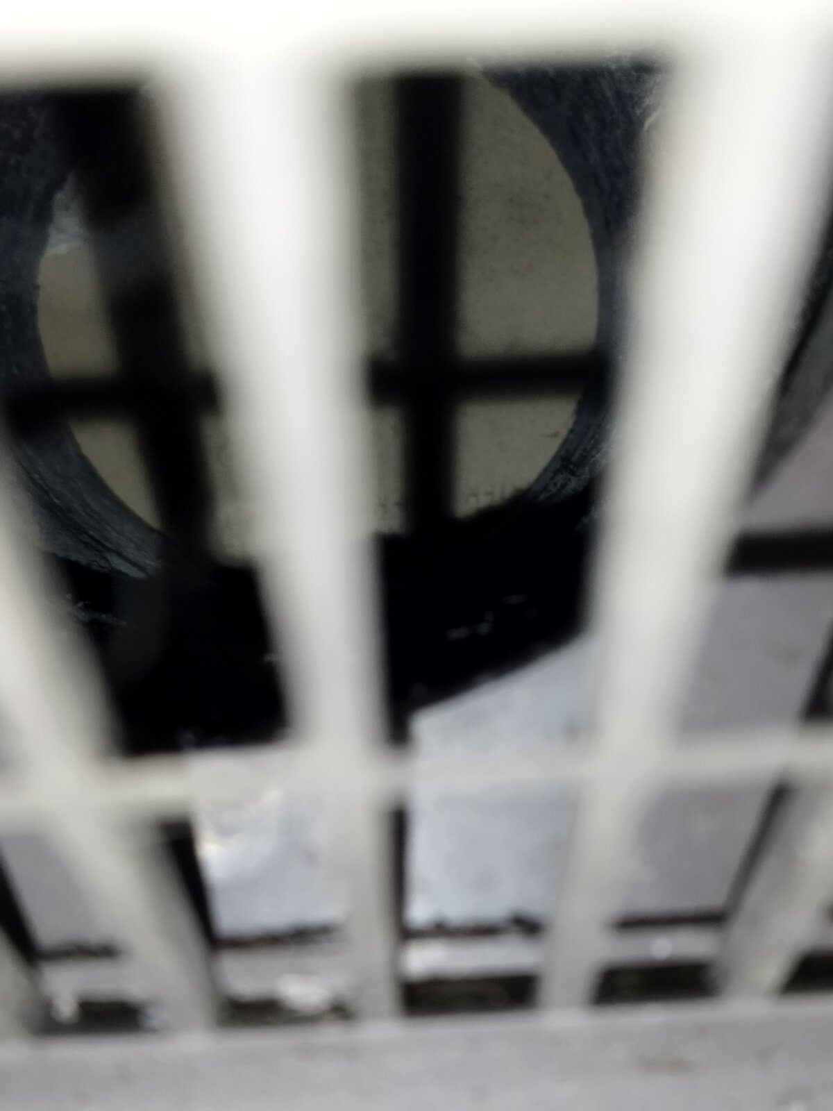

I did post about the inside of house in relation to where these outside vents/holes are, because i wasn't sure whether i had a damp/condensation problem or both.
Are these here to bring air into the cavity or can i block them up?

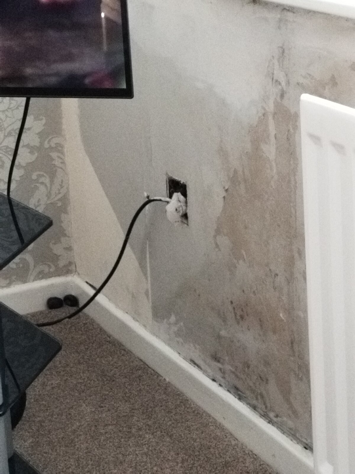

The 2nd photo is not very clear, but that is the plasterboard (i think) on living room wall. I'm sure that shouldn't be that open, should it?
I found a damp area more or less where it hits the plasterboard & lot's of condensation nearby. Could that be the cause of damp patch?

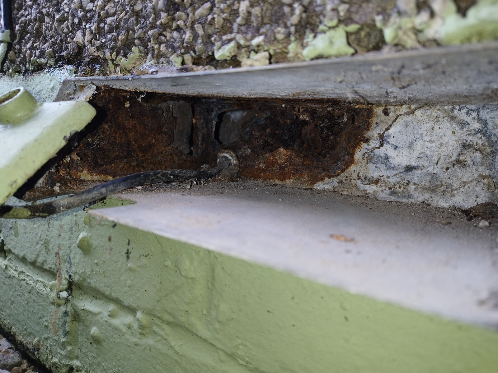

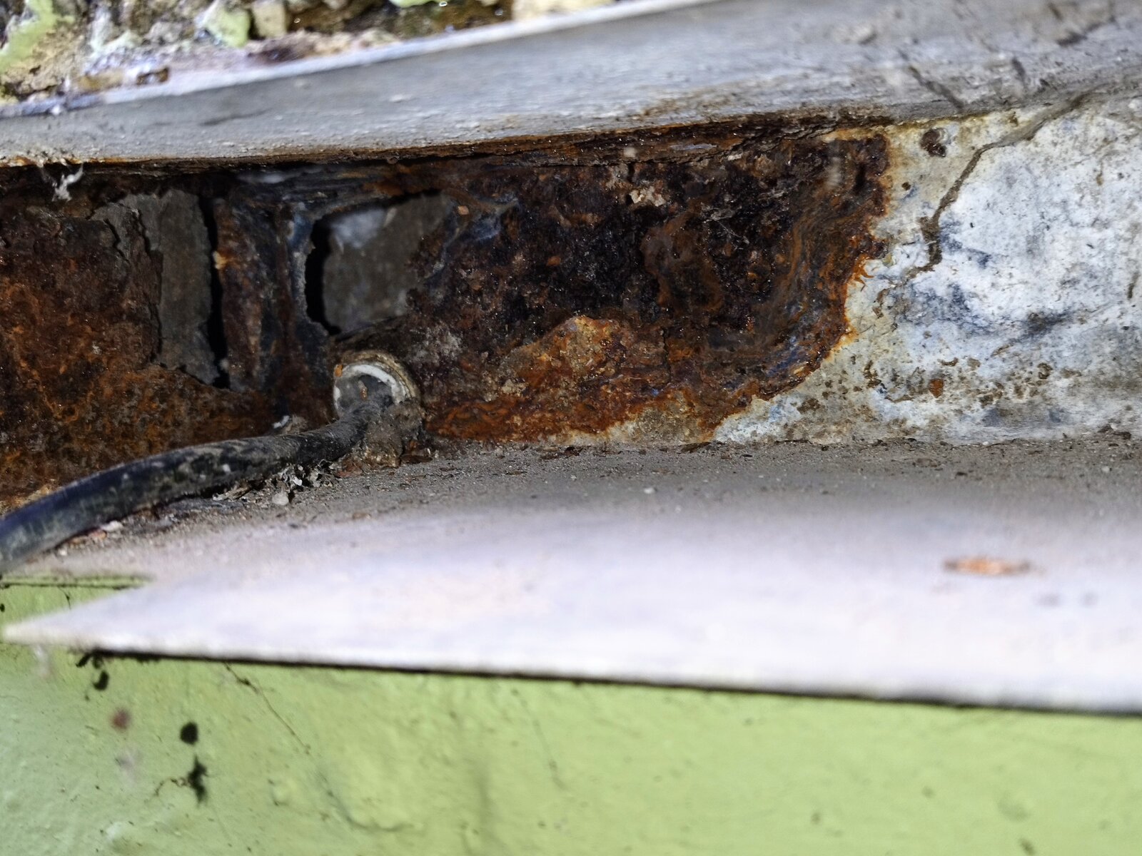

3/4/5 photo, what's it's purpose? The outside aerial cable goes in there & up a conduit to living room. You can feel a draught from where the cable comes out of wall.

Vents are for gas burning appliances.
You have any that needs vents?
Thermalite blocks I use on inside for the insulation. Don't want cold spot.
Bricks or concrete block outside.

If you have a suspended floor then any Air Brick below the FFL must remain open to provide venting for the floor.
Any air brick or vent terminal above the FFL is often used to supply make up air for a gas appliance that requires make up air. There are other possibilities so:
Why not get an opinion from a GasSafe for your situation?

I'd certainly block up the cable holes though!
