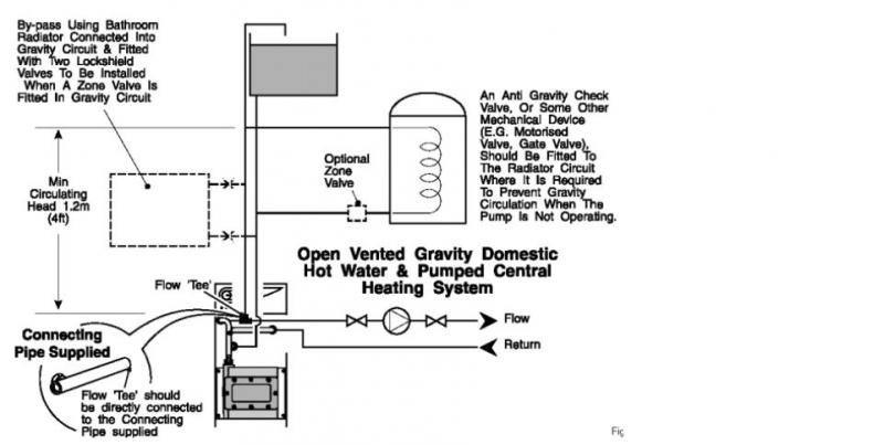

i just had a new gas valve and pcb fitted to my potterton kingfisher mf rs70 boiler after it packed up recently. so after the expensive of that we'ew going to keep the boiler for a few more years. it's gravity hot water and pumped central heating.
my question is can i fit a hot water cylinder thermostat to my hot water cylinder to turn off the boiler when the water is hot enough or would my system not be compatible for something like this?
any advice appreciated, thanks in advance
roland
yes you can do.
it would be best to convert it to fully pumped and add a 3-port motorised valve at the same time. You can get wiring and components diagrams from the makers such as ACL Drayton and Honeywell.
your programmer will have a different setting for gravity HW, this may well be a simple switch on the back.
you will need a bit more plumbing and wiring skill than most DIYers already have. I am a DIYer and did a similar job a few years back, and found it moderately complex, with the benefit of a lot of help on here.

thanks yes i would need to keep it simple. that looks fairly straight forward. can i just ask a couple of questions:
so the 28mm two port valve fits to the pipe from the cylinder back to the boiler not from the boiler to the cylinder? and does this need to be fitted at the cylinder end or the boiler end of the pipework or doesn't it matter?
also when we got the boiler fixed i got a quote to upgrade to a new condensing boiler but the price was high because it needed to be converted to a fully pumped system. if i was brave and converted the gravity fed water to pumped and used a 3 port valve as suggested, if i upgraded to a new boiler in the future would it be a simple and relatively cheap upgrade or would the new modifications i make still have to be changed?
The important think is that the valve does not block the vent pipe when it is closed.
Potterton say you must have a bypass, e.g bathroom rad, on the gravity circuit before the valve.

As an option, you can add a tank thermostat and achieve a better control than you have now without doing any plumbing - as shown below.
With this interlock, the boiler will only fire if the tank thermostat is demanding heat or the room thermostat is demanding heat. You still need to have HW on whenever CH is required, so the programmer must still be set to gravity mode. It does not afford full control because, whenever the CH is running, the tank will continue to be heated whatever the state of the tank thermostat. However, it should prevent any boiler cycling once the tank is up to temperature.
