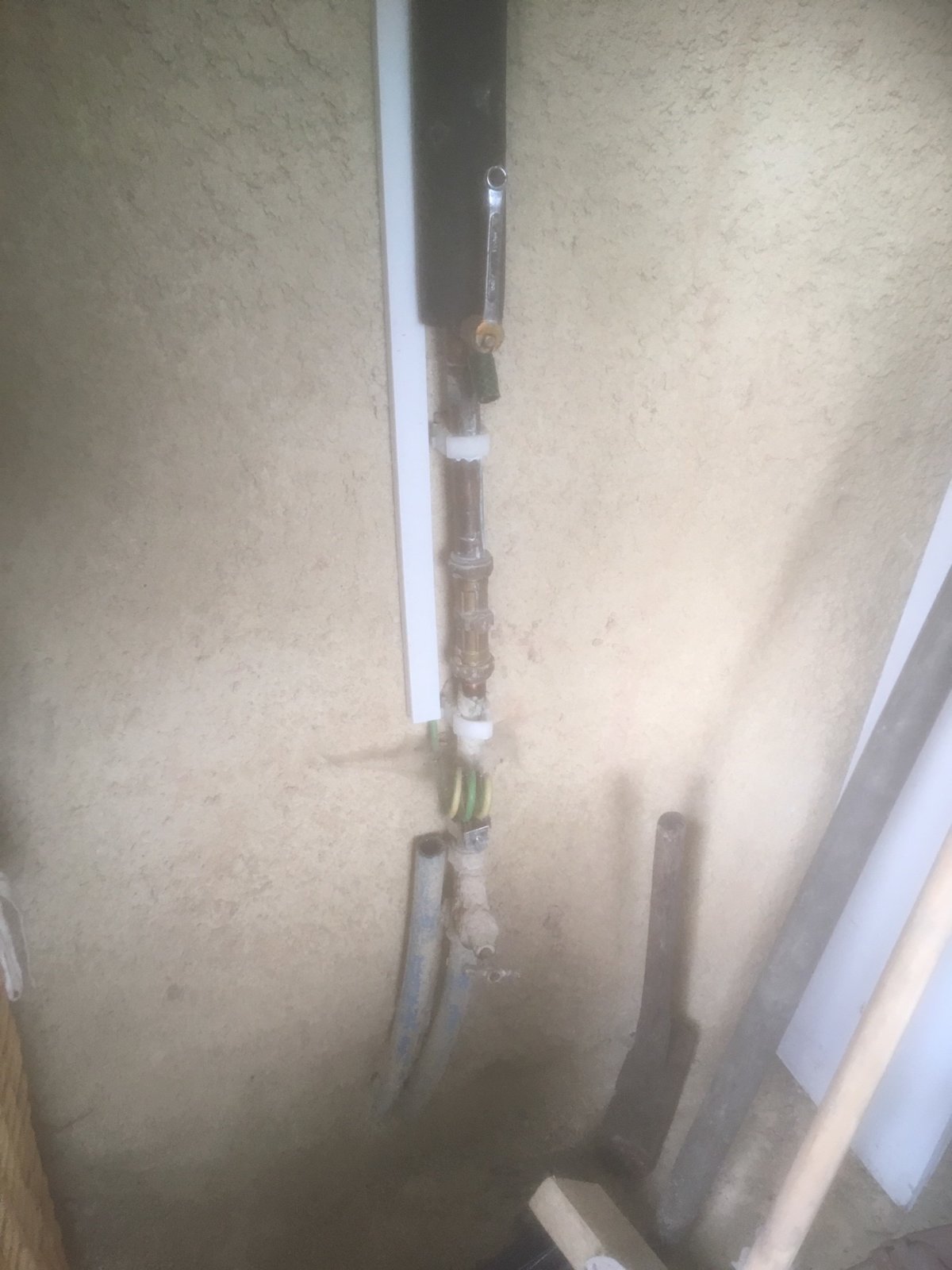

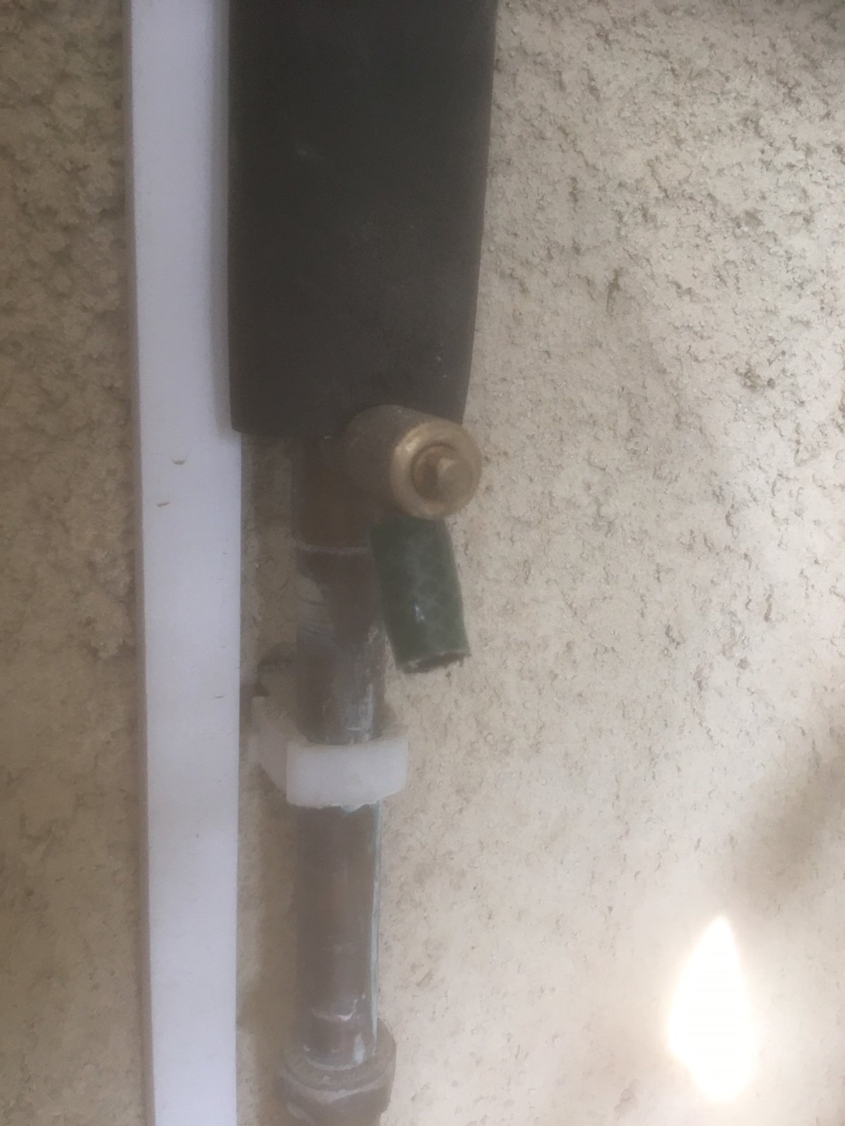

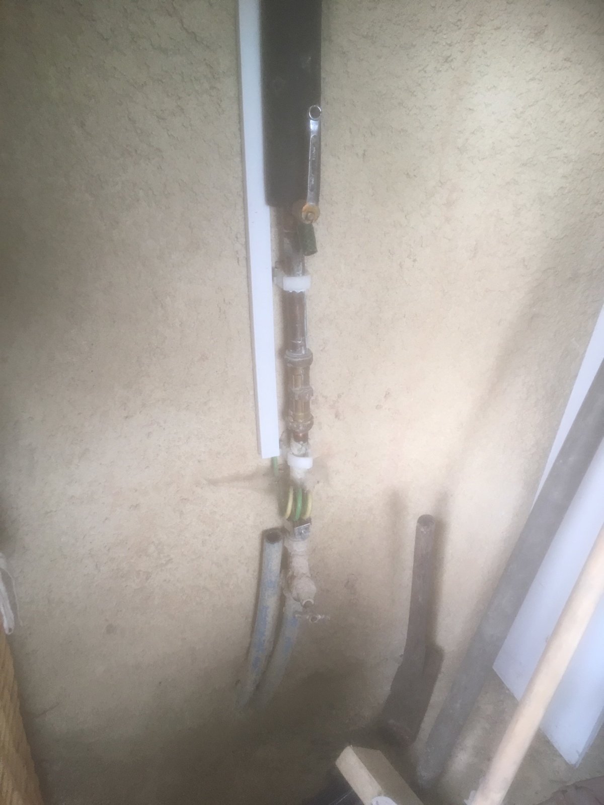

Hi all,

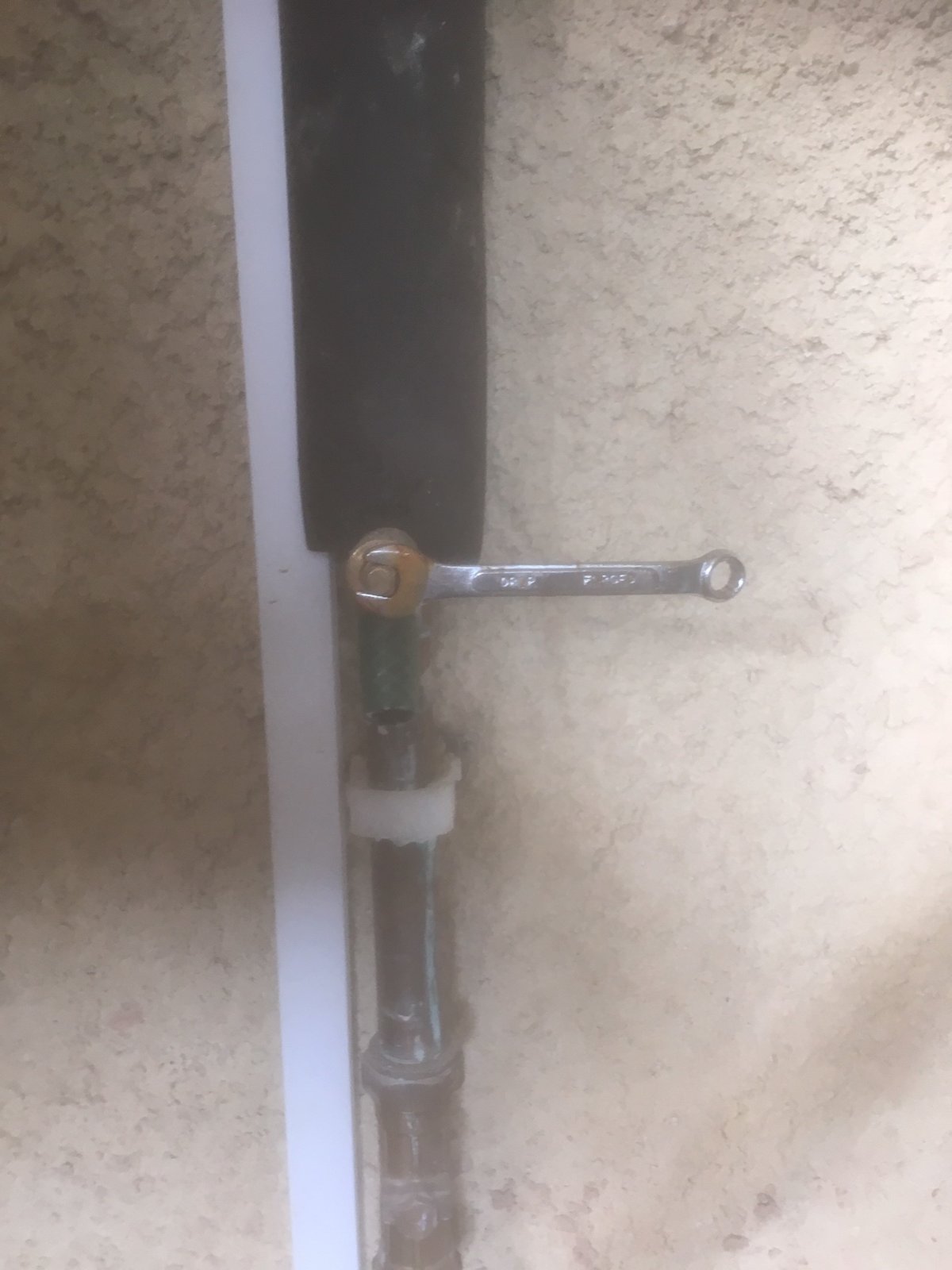

I have an outside valve(?) on the rising main in the garage. I currently use it as a tap by turning it off/on using a spanner.
(Youll that Ive put a little bit of hose on there just to direct the water a little better.). Is there a way I can easily fit a tap on here? Or atleast a handle of some sort that I can use instead of a spanner (which keeps falling off and is going rusty).
I dont know how to fit a tap and its way beyond my DIY skills (cutting pipe etc...). Just looking for an easy way to attach some sort of handle.
Get a plumber to cut the pipe, insert a compression tee and fit a brass bib cock to the remaining branch....you'll still be able to drain down if necessary.
I wouldn't rely on the washer in those things - if it fails there will be some grief!

But for now, Ive just found this https://www.ebay.co.uk/itm/302327839016?ul_noapp=true . Looks like it will do the job?
Are you saying that the washer could fail becuase this is a valve rather than a tap? In other words, its not really meant for regular use like a tap.
When would this valve be useful? Why would I want to drain the system? If I changed a radiator or something?
Apologies for all the questions - but this is on the rising main going into the house so is quite a crucial element I should know more about. :)

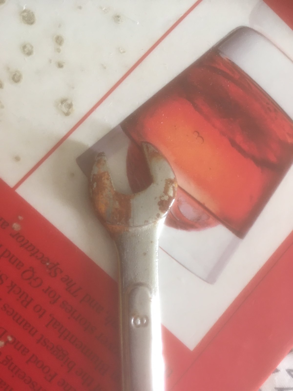

The key you show may or may not fit -best to measure across the flats to see if yours is 6mm (mine are around 7mm) :eek:. If it fits, it will do the job of course.
This is a drain down cock - very useful for other work or when the house needs to be drained off in the winter or whatever. A normal stopcock will do the same, but of course the system will still be full. If this is a mains wet riser then it won't be connected to the radiators, rather to taps or tanks or whatever is in the building.
These drain cocks have a small rubber washer inside, and replacements aren't always instantly available but you can get them....they aren't designed for regular use.
Ideally, you should have a quality stopcock down at floor level, then the pipes should rise to your proposed tap - and then everything should be nicely lagged.
Once on site, all of that could be sorted in a pretty short time by a plumber.

Ive just been out to take some more pictures. Just so Ive got this straight: I have a stop cock (tap vey near floor just below the ground wires) which stops ALL water to house; then a drain off valve (which obviously drains the system); and the insulated pipe. Have I got that right? :)
The other blue pipe is a pipe from a disused well. At some point I want to fit a pump to it so I can use that as grey water. But thats a different forum post altogether. :) (perhaps something you guys could help answer my questions to)

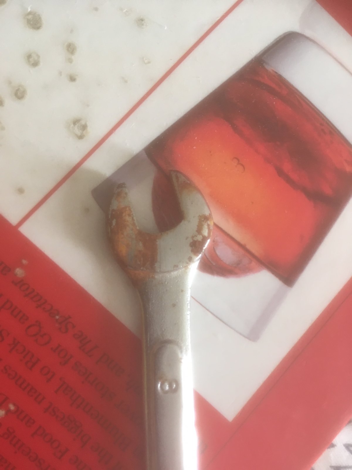

This is the spanner I currently use to get water from this tap/valve. So I need an 8mm tap/handle(?)

Thats basically the system you have.....above the earth wire connection there seems to be an isolator/one way valve (I cant see the pic well, small screen) and then your drain down cock.
You can continue with what you are doing but the drain down isnt designed to be used as a tap -you also wont get full bore water flow.
John :)
