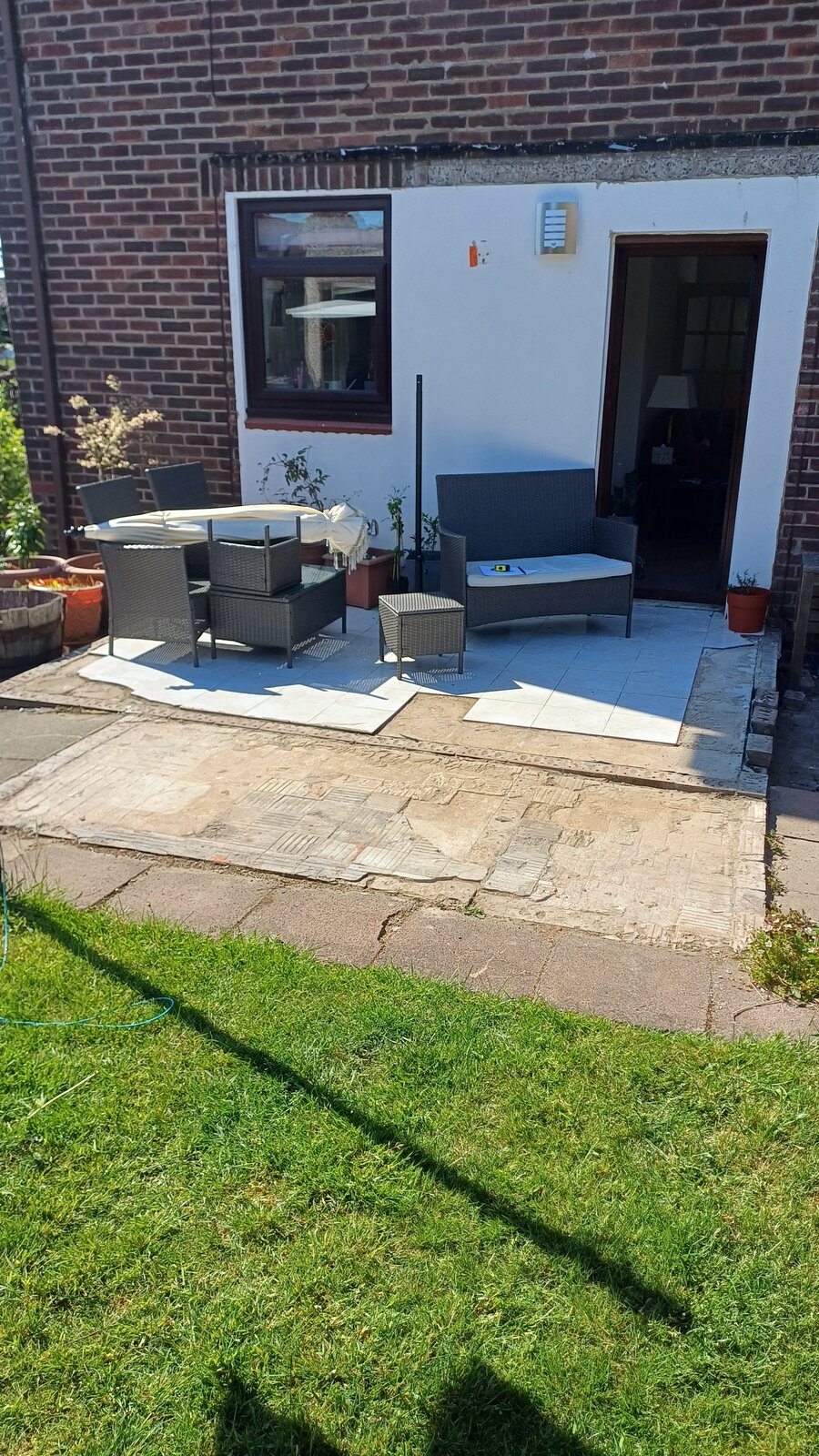

Can I fix this into concrete?
3 May 2025
18
2
I'm looking for a cheap solution to tidy up where there was once a conservatory. I think I'll need to replace the back door in a year or two so don't want to spend a load putting in a patio or decking quite yet.
I've been thinking about gravel, but how to contain it? Could I get some of this plastic garden edging and secure into the concrete with nails?
I did consider concrete paving edging but don't have the tools to cut lengths to fit. Bricks means mortar and tbh I can't be faffed with learning how to make it or buying the tools.
Any other ideas? I'm a fairly competent DIYer but time poor, and still building up my tool bag.
Thanks in advance.

It will look better if you just remove the old tiles I would have thought
I can see where you're coming from in terms of being relatively cheap/temporary until you do it properly. You can use that edging in your photo, but I'd throw the nails in the bin, make sure the concrete is dust free, and stick it down with " sticks like s#@% " straight out the tube. No drilling or plugging.
Oh, and unroll it first and leave it in the sun to heat and straighten out !
Haha thanks! Is that the actual product name?! Sounds like a good solution
