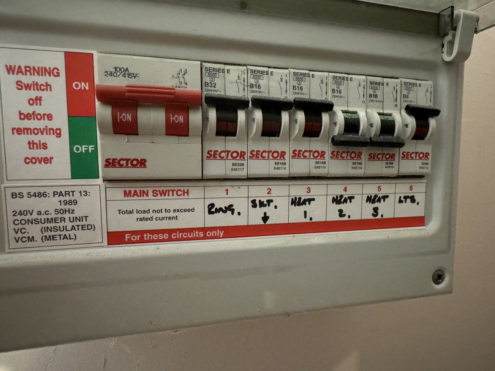

So - I think so, but not entirely sure. I will try and explain the set up as best possible: The electrics in the garage have a consumer unit on the wall in the garage. There is a main/master RCD that says 100A 240/115v, their are 6 smaller RCDs (Ring, Skirting, Heat 1, Heat 2, Heat 3, Lights). These don't give a rating on them. I will post a picture in a moment.

It is a 3m x 0.7m above ground steel frame pool. No deep end or diving boards (sadly). The plug is inside the garage. There is an external plug socket (but this essentially an IP66 rated extension lead, going through the wall into a different plug inside). The spur in question is aprox 1m from the window, the pool will be approx 2m from the window and about 3.5m from the external plug socket/extension lead.

There's no RCD in this consumer unit, just a main switch and a row of MCBs, a B32 for the ring, several B16s for "socket" and "heat" and a B6 for the lights. How is the garage connected at the house?

It is connected via this consumer unit in the main house. Next to the main CU under the stairs. I see this one says RCD at least.
Pool/hot tub heaters tend to have built in safety device , does yours?
Thanks foxhole,
The heater has a PRCD incorporated in the power cord. according the booklet "If the leakage current is detected more than 10mA the device will operate and cut-off the power supply".
