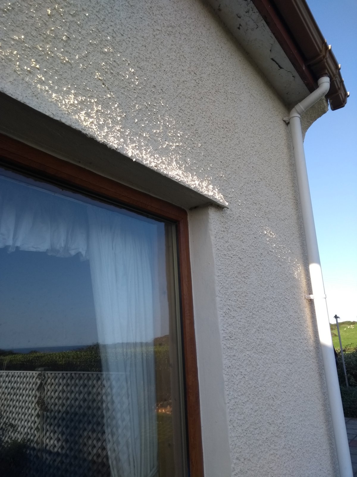

Finally (for now), how is this rain-casting feature formed? I'd like to copy the features on the existing house...
