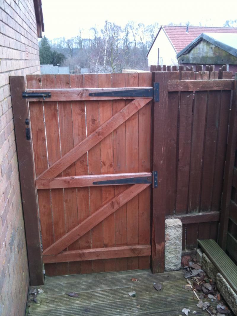

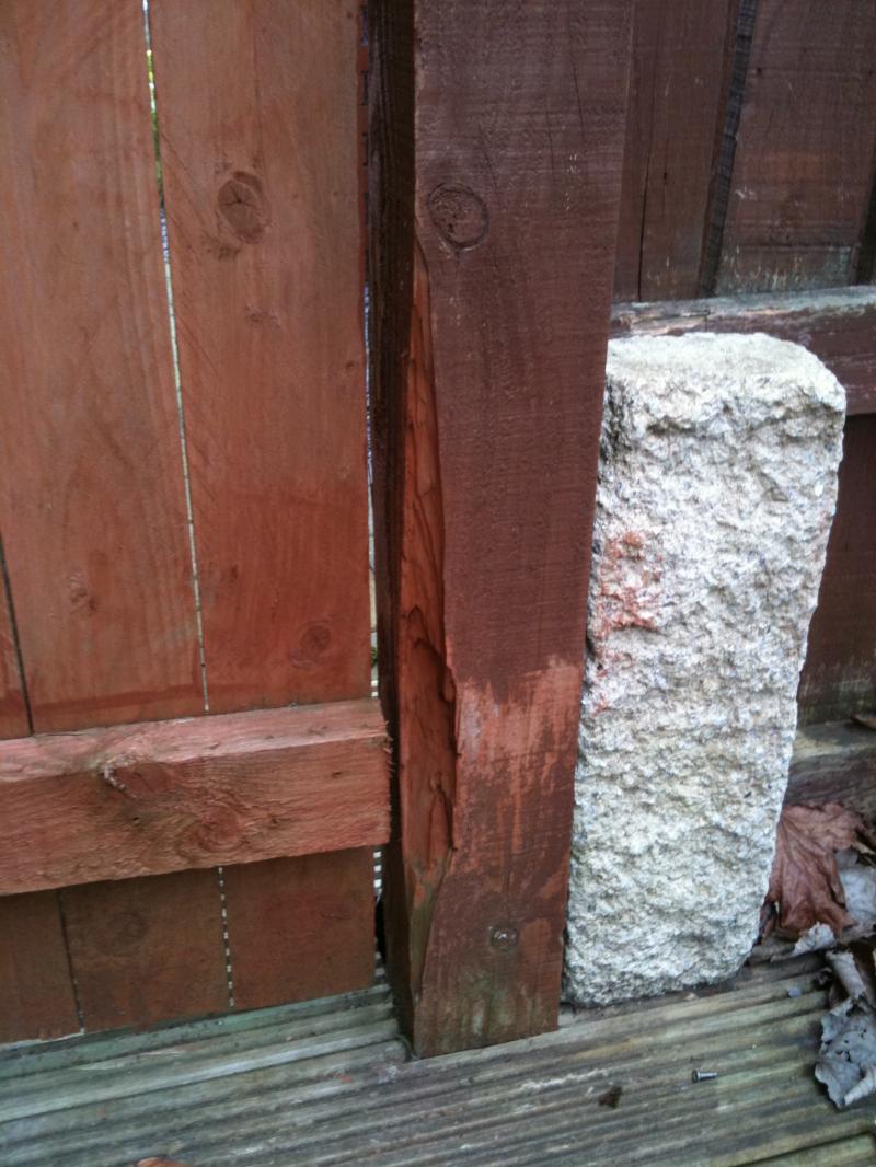

Hi all,
My back gate has a hinge missing from the bottom. It looks like someone (previous owner) has kicked it off ?! as there's a big chunk of wood missing out of the fence post. I wondered if it's possible to repair this fence post so I could attach a third hinge and make my gate more stable. The fence post disappears down underneath the decking so I don't want to replace it if possible.
I've attached a couple of pictures so you can see the damage.
Anyone any ideas how I could go about this?
Many thanks
John :D
You could add another (new) horiz. bar to the gate, then use that for the hinge position. Wont look great but it'd work
Good idea WabbitPoo (great username by the way! :LOL: )
I would rather something a bit 'neater' if possible.
Thanks for the idea though, I'll certainly bear it in mind if there's no other suggestions :D

the diagonal brace should go upwards from the hinge to give the gate strength
Merlin is technically correct about the hinges or you could put it another way and say the braces are on the wrong way. Personally I'd also hinge it to the timber fixed to the wall as it won't move in the wind and stress the post.
Actually thinking about it that may be the easiest option rather than splicing the post - simply hang it the other side .
Merlin, Ladylola,
What a great idea!
I'll just take the gate off, flip it and re-attach it to the wall post.
