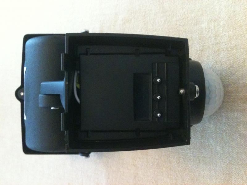

At the moment we have a security light at the front of our house.
The cable runs into the house and has a normal plug attached to it so we can switch it on and off when needed.
What i wanted to do if possible is have another security light round the back of the house but i dont really want to drill another hole in the wall.
So is it possible to run another cable from one security light around the back of the house to another security light???

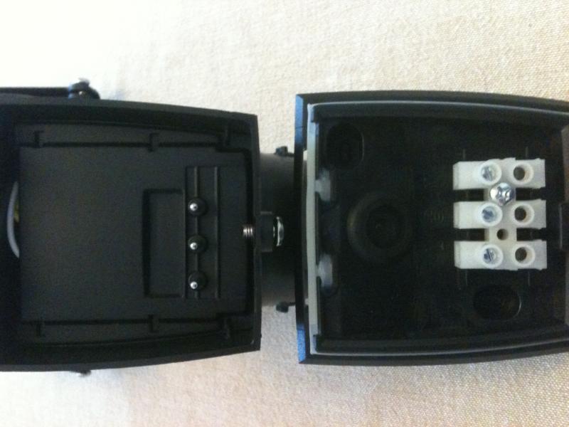

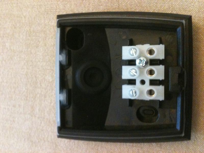

Took some photos of the security light.
Hopefully i can fit 2 lots of 3 core cable through the small groomet
[/img]
Yes, if you have the correctly rated cable for the current drawn by the lights( both new & exsisting ) & the correct size fuse in the plug, then you can do as you ask. You need to supply lamp ratings & current cable size, plus run length to the new lamp, for any further advice.
The new light is 150W and i think the other is 500W
Pretty sure ive got 3 core flex 1.5mm x 10 metres long
And the plug has a 13amp fuse
Reading the instructions it recommends using a 5amp fuse in the new light

Holmslaw might be right about you not being able to get 2 cables into the existing light, or he might not - give it a try before you buy a junction box.
He's right to say don't use twin & earth - arctic cable would be suitable as long as you don't mind bright blue or yellow. If I really had to do it I'd use black tough rubber sheathed flex, not PVC. Often sold in the sheds as pond cable.
