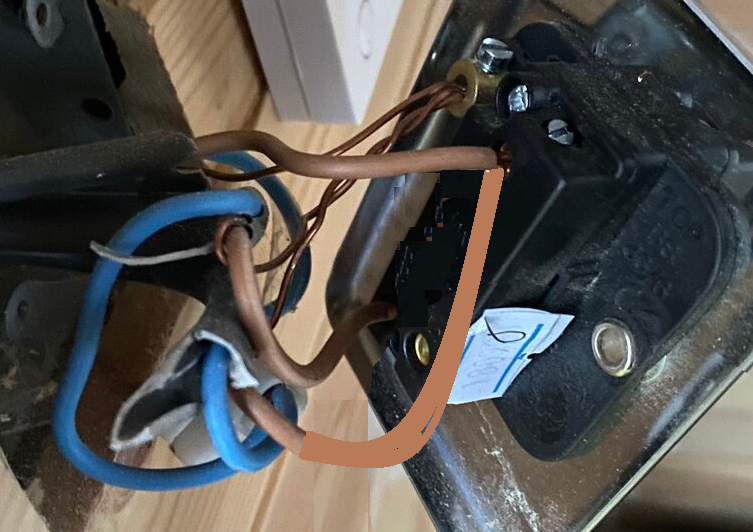

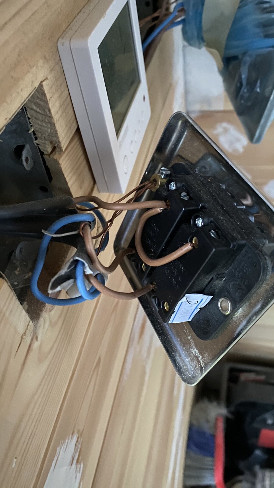

Hi I have a shed and this double switch currently switches an outside light and also an inside light on via the other.
I would like to swap the outside light to an always powered PIR with LUX and change to a single switch for the inside light.
Is this possible?
many thanks
View attachment 230833 Hi I have a shed and this double switch currently switches an outside light and also an inside light on via the other. .... I would like to swap the outside light to an always powered PIR with LUX and change to a single switch for the inside light.

I don't of course know which cable is for which light but basically this is what you're asking
This single gang switch will work but I'd suggest still having a switch [elsewhere?] so you can switch the PIR light off if you wish to or when it goes wrong.
The earth wires should be fitted with green/yellow sleeves.

I’m hoping to replace a double with a single switch and have the PIR set to live.
Is that possible?
Yes, it is possible. It is as described above in post #3!!
But -as you have been advised- if you do that you will be unable to isolate it without turning all power off.

Thank you guys, I understand the potential issues and apologies I didn't see the changes that were made to the image in post no.3. I wish to change from the double to a single dimmer switch for the internal lights.
If down the line I do run into issues I will know where to go and revert back if required.
Thanks.
It would probably require you to use some sort of 'modular switches', but there's no reason why you could not replace your present double ('conventional') switch with one which had a dimmer and a conventional switch, both wired identically to your present situation, with the latter (just an 'on/off' switch, virtually always 'on') serving your outside light, which you will change to a PIR one.
