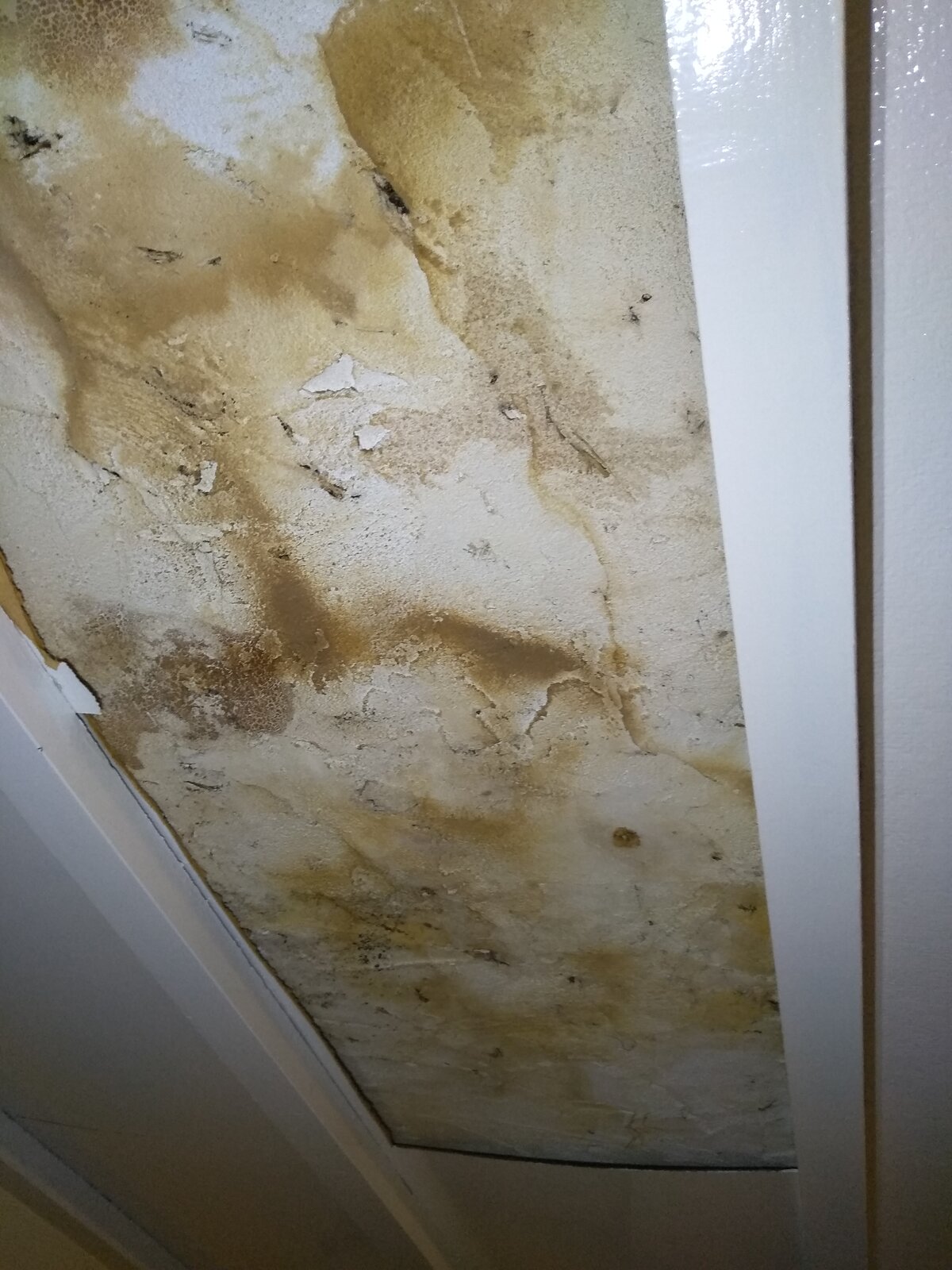

Hi,
I am removing the plywood ceiling under a flat roof. I am going to replace with plasterboardoard. There is this old insulation behind the plywood.
Can It be asbestos?
What is or has this room been used for, could there be a reason for having asbestos ?

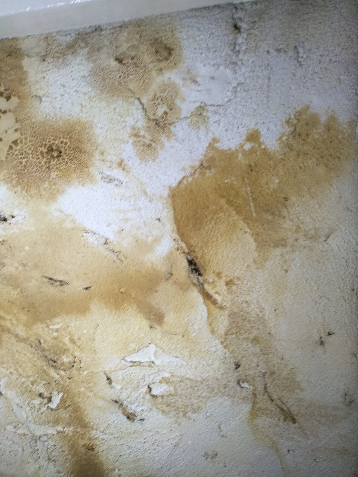

It's difficult to see what you are trying to show. Is it a board, or a coating on a board?
The staining makes me think it less likely to be an asbestos board, but if it's got a coating like Artex, then that could contain low levels of the least hazardous type of asbestos fibre.

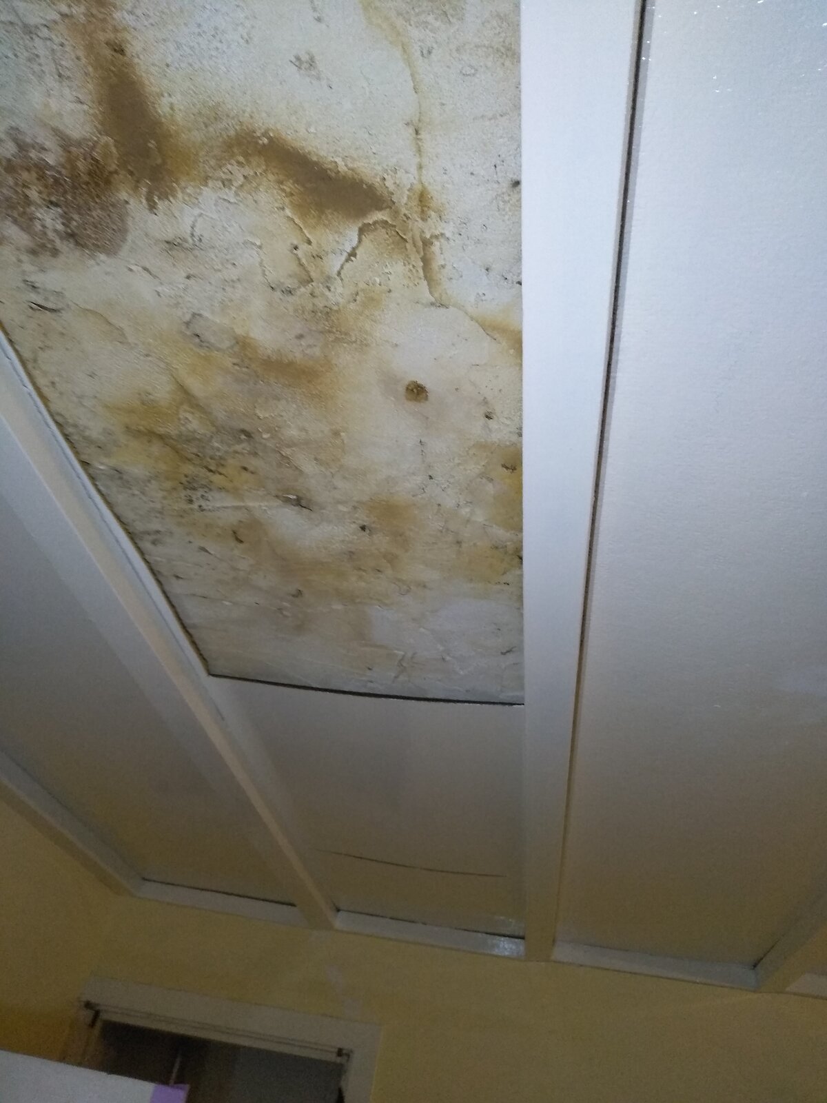

It is a room in the top floor of my house. Above there is a flat roof with felt. The ceiling is plywood supported on 2 x 2 inches beams. I just wanted to remove the plywood sheets and replace hem with plasterboard.

Still not clear.
You've removed a board of some sort, looks like it was hardboard, and now there is that other board of some kind, and are you saying that that is plyboard with a coating of some sort? So you are concerned about the coating?
Or are you saying that its not plyboard and you don't know that it is? If so, have you got clear images of the board and not just the coating?
Can you gain access above the ceiling to see what it looks like from the other side?
The boards are hardboard, not plywood as stated in your original post.
If you are going to take a sample for analysis I would suggest face goggles and a good quality respirator. Make sure there is no one in the area and vacuum thoroughly afterwards.
You haven't said how old the property is. Between the wars (and just after WW2) it was common to use 'Fibreboard' as a ceiling material under flat roofs. Your description of how the roof is lined is very reminiscent of using fibreboard in flat roof construction of that era.
As others have suggested get it tested for your own peace of mind but if it is fibreboard it is just very mucky to remove.
It was common to to put Hardboard or Plywood sheets up to hide the fibreboard as 'improvements'. The fibreboard was used as an insulating material as it could be painted and would absorb a quantity of the paint to form a skin which your pictures show pealing away. Condensation above the board would be absorbed quickly.
