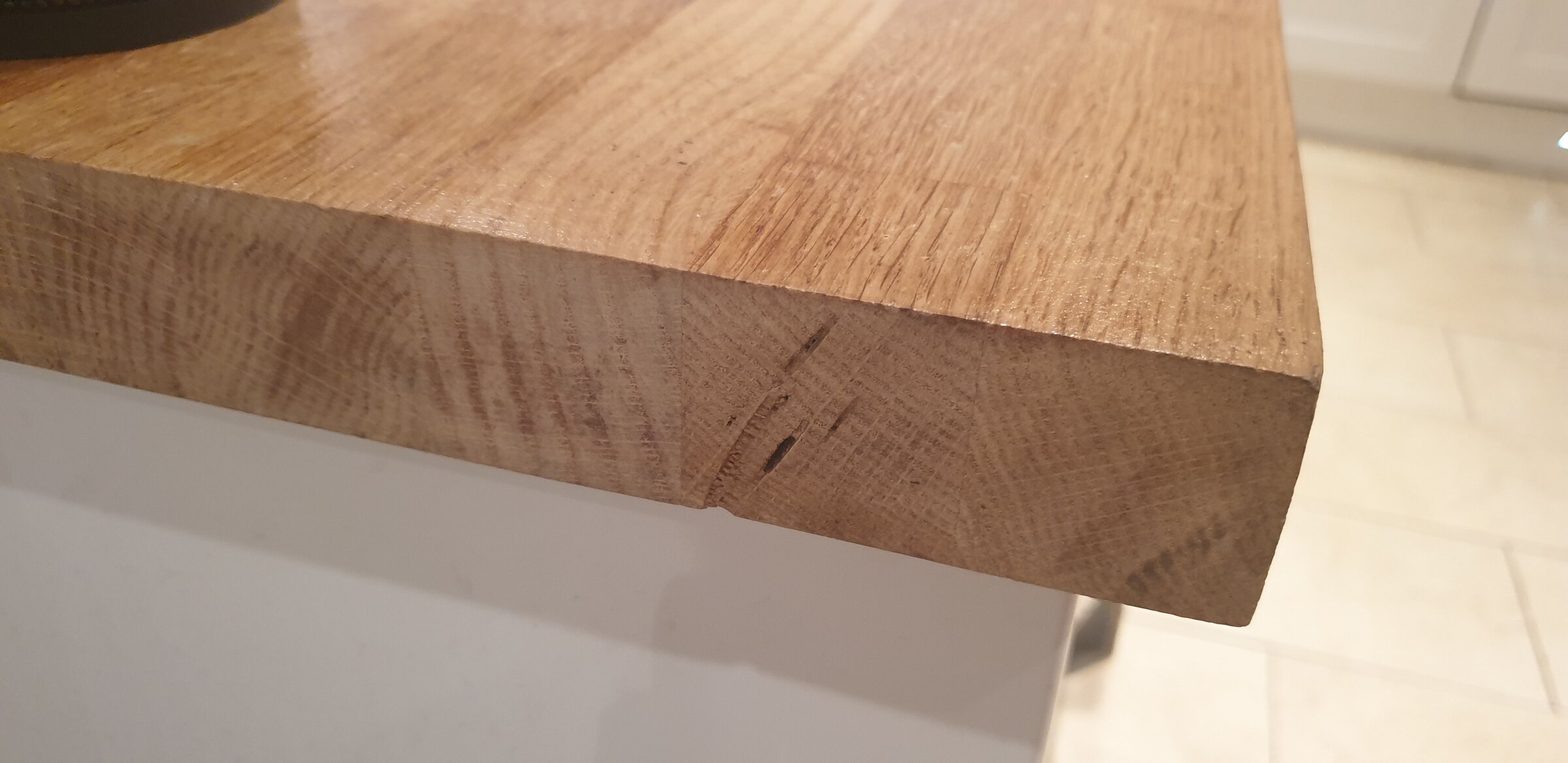

Hi guys, sorry for the confusion, I'm at noob with this area so apologies for the conflicting terms in my post, this is the end of the kitchen top:
Would I be correct in thinking that this worktop is in fact wood and not laminate?

Yes, its Oak.
It looks to me like it has been varnished rather than oiled. You will need to sand down the whole worktop and re varnish or oil.
Rub whole top down to 150, then three coats of Osmo Top oil, one coat a day over three days or at least 12 hours between coats. very lightly denied between each coat. Then use heat mats or trivets.
