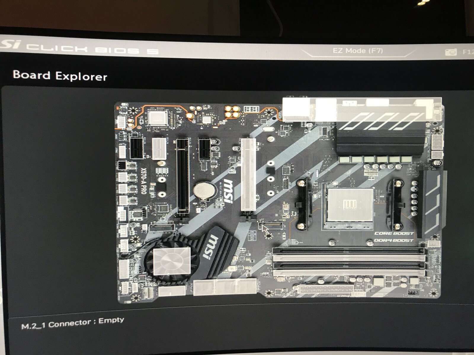

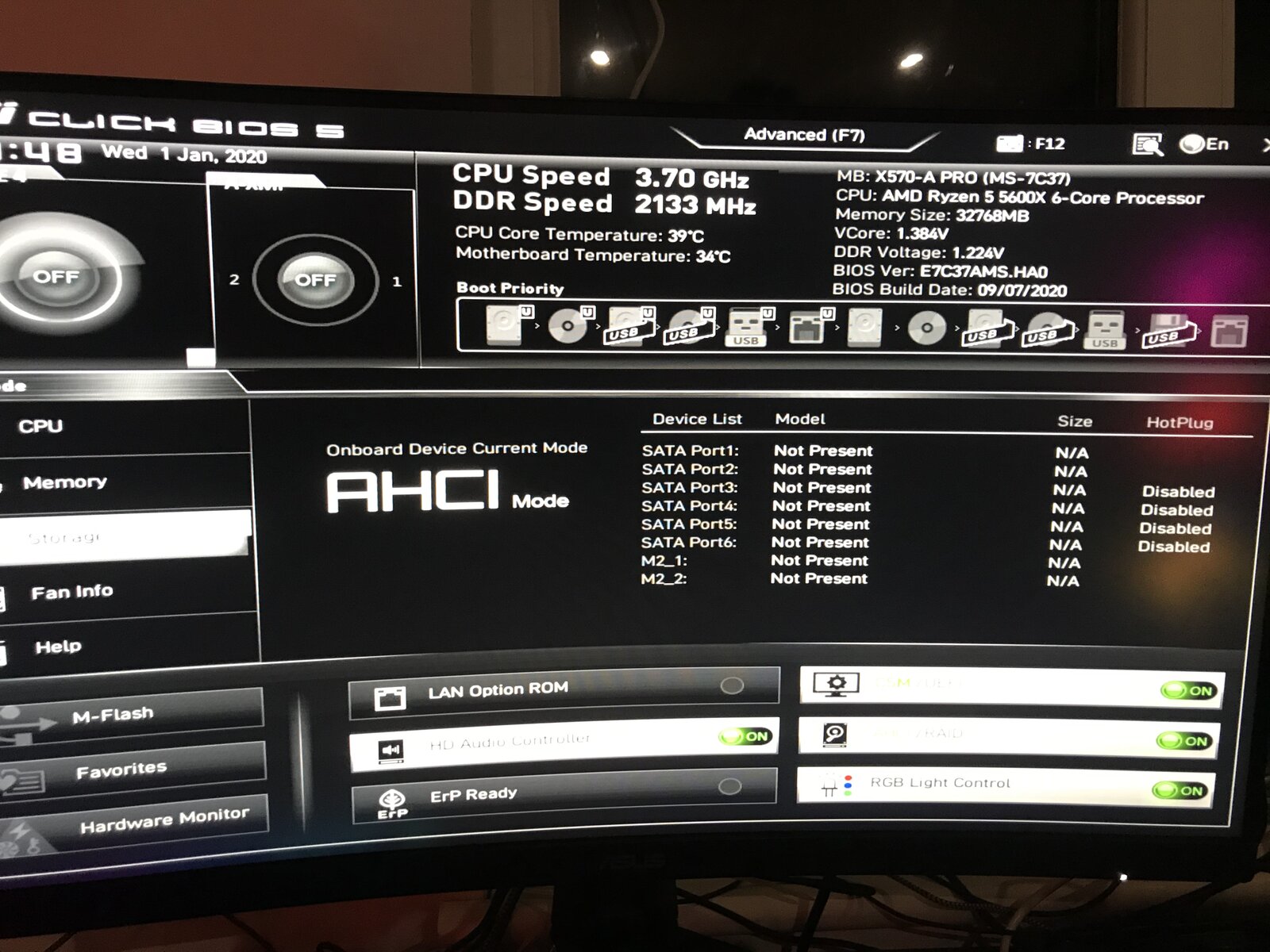

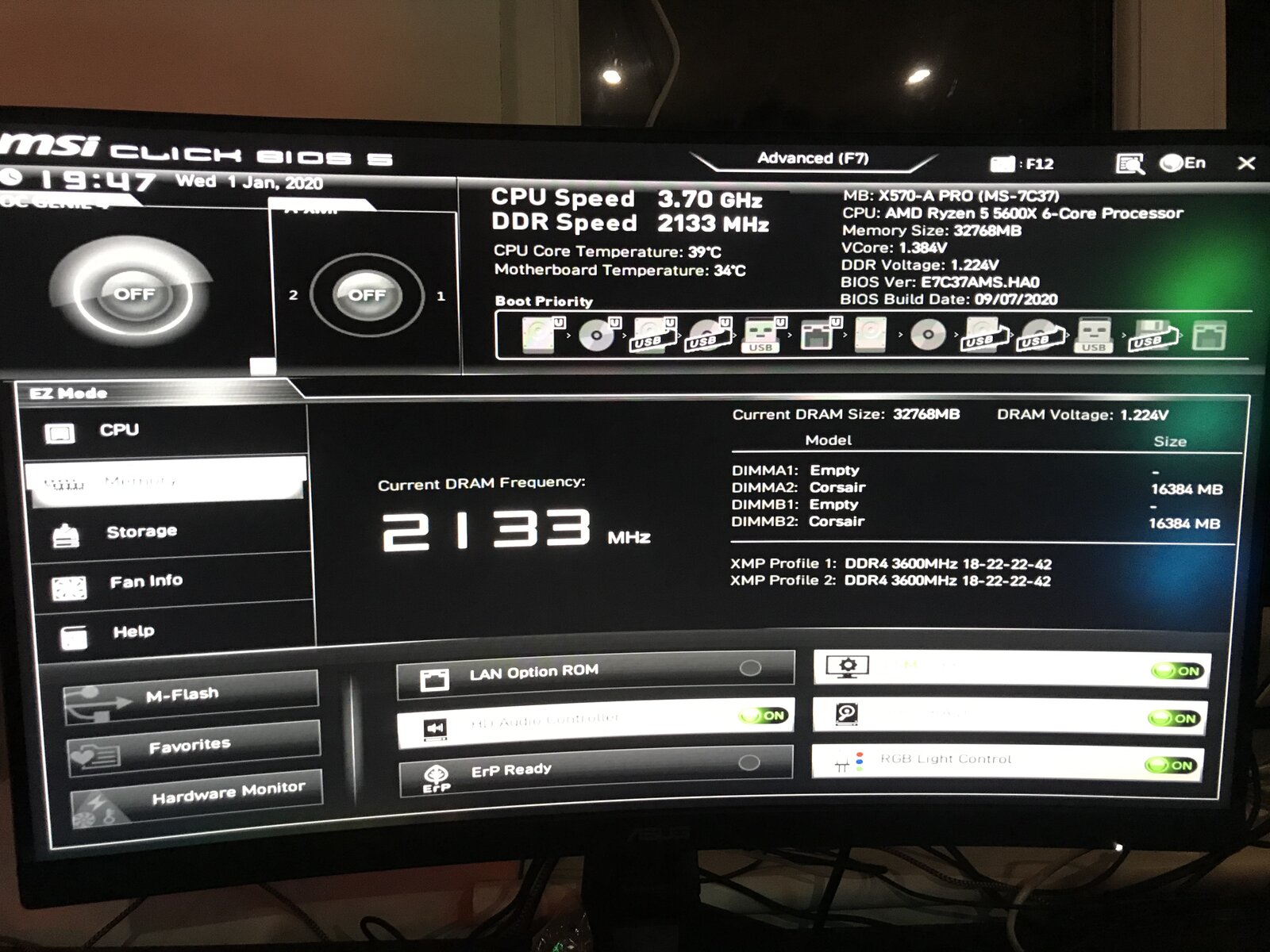

I’m looking at it now and it starts up like little brothers did at Christmas but when I click the options to the left it lists the CPU, both the 16gb sticks but doesn’t show his SSD which is a 512gb Samsung 970 EVO plus. It says there is no storage. I took the SSD off then put it back on and no difference.

This thing also suggests no SSD but it’s there:

They are showing as installed on the setup page so I’m sure they are in right.
There are options in the BIOS to enable it to see the NVMR drive.
OR it may be that its incorrectly seated, re fit it.
I initially had problems like this, the BIOS sorted it. (cannot remember the setting).
I’m sure it’s seated correctly, how would I get the bios to see it?
