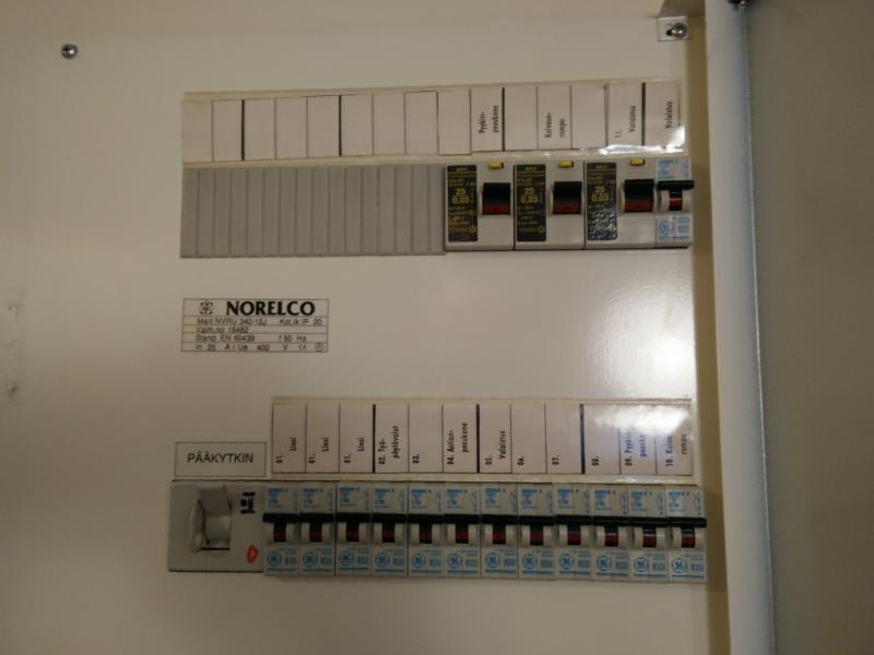

MCB (mini circuit breaker) randomly tripped a few nights ago while family and I were playing video games.
The QUESTION:
Could I have bad wiring somewhere in my flat? Or am I dealing with two separate issues (described below)? I don't even know what I'm looking for anymore... I just want to know what's going on.

Just a quick layout of the circuit lines in this flat. The affected line that tripped the MCB is connected to our entrance hallway, bathroom, living room, dining room, and kitchen. Hell of a lot of crap to be on ONE line. There is also four GFCI breakers lined up beside it (1,2,3,4)... with #4 connected to affected MCB somehow.
[GFCI 1][GFCI 2][GFCI 3][GFCI 4][MCB]

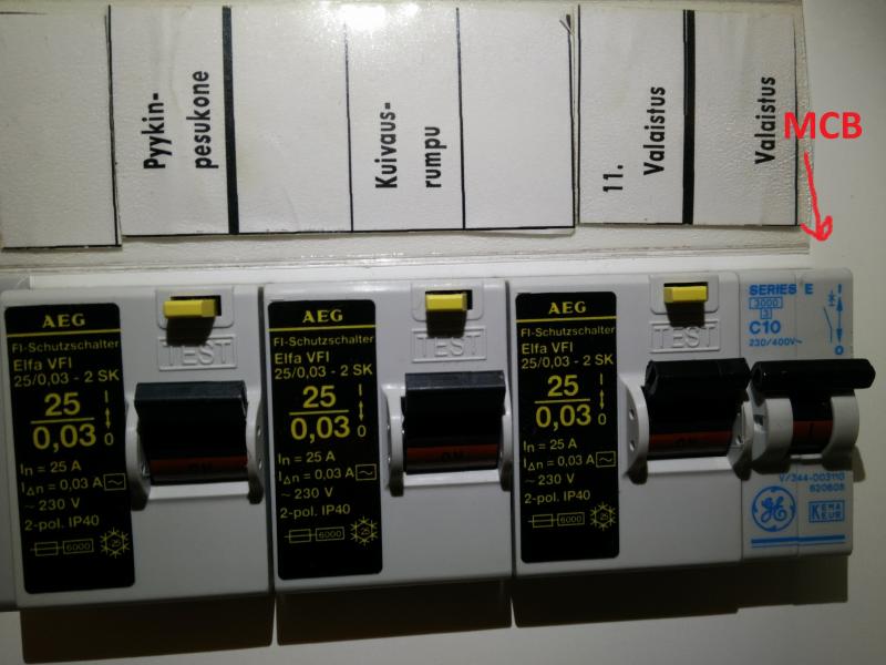

MCB trip when excessive current is flowing.
GFCI ( Ground Fault Circuit Interruptor ) operate when there is a fault that involves current flow to ground. Normally this has to be about 20 to 30 milliamps before the GFCI will trip.
For UK readers the GFCI ( USA name ) is very similar to the UK RCD
Most power supplies for computers, audio visual and similar equipment have mains filters in them and these filters do create a small current to ground, per item the current is too small to trip the GFCI. But if there are several such power supplies in use ( or just on standby ) then the total current to ground may be enough to trip the GFCI
The mains filter in the "audio receiver" may have added the last bit of ground current needed to trip the GFCI

Are you sure it is the MCB ( over current ) device that is tripping and not the GFCI that is tripping ?
If the TV signal is digital then a voltage disruption on the mains can distort the received TV signal enough to cause the TV decoders to loose synchronisation with the incoming signal. This will cause loss ( or freeze ) of the picture until the decoder has been able to re-synch with the signal.
Switching items on and off can cause voltage disruptions on the mains supply. Almost all devices have a brief inrush current that will dip the voltage for a short time ( less than half a second ) Some energy saving lamps have a high in-rush current.
I'm most likely wrong on labeling the other switches as being GFCI, but the MCB (miniature circuit breaker) switch is definitely the one that tripped. Here's a picture of our actual panel. What I assume are GFCI switches are the three bigger ones that are black/yellow.
And here is a closer image of the mcb I'm talking about.
The bigger switch beside it seems to be connected on the same circuit line for my lights and some outlets, though that one didn't trip, just the one I pointed out.
