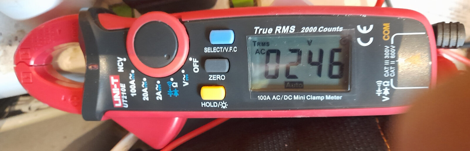

The problem is the fault can be on either the line or neutral (both considered as live wires) so turning off an MCB does not isolate the circuit, so for the user, you need to look at likely causes. You don't have an insulation tester VC60B.jpgRCD tester RCD tester.jpgor clamp on ammeter Testing voltage.jpg so you can't really test yourself, all you can do is guess on likely causes.
