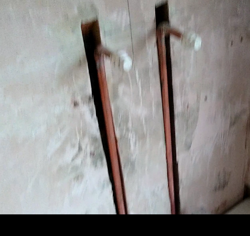

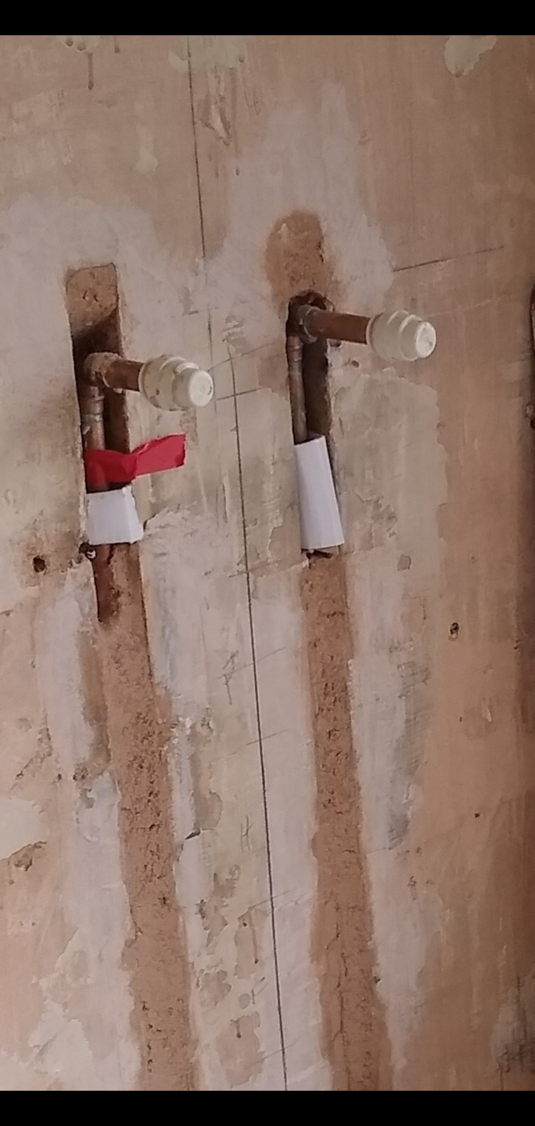

I am have a new bath and shower installed..
As part of the work the fitter has chased the wall (masonry) in order to embed the pipe
He has bonded over the pipe.
However I am almost certain that the pipe was not protected and i wanted to know whether I am running the risk of the pipe potentially corroding and leaking?
Or will it be fine?
If there is a risk, will it possible to chase out the bonding plaster from around the pipe? If so, what technique would be advised in order to avoid damaging the pipe. I have chisels and and sds
Some plasters are copper friendly, but if the bonding plaster used has either cement or lime in its make up, it will eat through the copper
